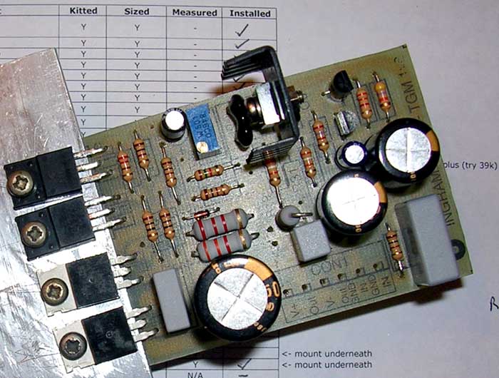

It looks a bit messy, but it's the first prototype. The heatsink is temporary and I haven't sorted out the electrical isolation between the devices tabs and the metal. Also haven't sorted out the VBE multiplier device connections. Flux residue everywhere, need to find some flux cleaner before this thing sees any kind of power supply.
At least if it doesn't work and can't be debugged within my skills, I can pot it in some perspex and use it as a paperweight 😀

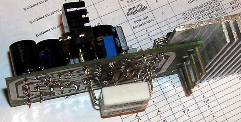

Here we see the output emitter resistors placed on the underside

Gareth,
Lookin' good!
Are you using TO220 output devices?
Do you have any rail caps for decoupling the supply?
Like the emitter resistors foil side, nice touch.
Where are you putting the Vbe multiplier?

Hugh,
Yes, I have the TO-220 output devices. For the power level I'm using they appear adequately rated and were available from DigiKey which was convenient. They aren't Toshiba though (Fairchild), so we may not achieve the same sonics as AKSA with this (even assuming that the other elements I have were similar). I'm not against 'upgrading' to the bigger devices if it makes sense but not sure if this is necessary.
No rail caps on this board. I don't think I had a good reason to leave them off (yikes !). I'll have to add something to the bench supply wires for testing purposes. How close to the board do these caps need to be ? Do they have to go on the board, or could they be stationed separately with the psu if distances between them are short ? Overall, decoupling has not been given much attention and I may end up adding something on the underside if necessary.
The VBE device was supposed to go on top of the output device (which like the underside emitter resistors was a nod to your design approach). But with the TO-220 this isn't so practical and is essentially an oversight on my part. I'll have to find it a home on the heatsink adjacent to one of the output devices. It would be nice if there were some way to cement it directly to an output device but this likely means never being able to separate them so I'd have to replace both devices if one of them fails.

I think your approach is fine, and will work well. As far as I can see your amp should sound very good vis a vis an AKSA.
The advantage of the TO-3P is that you can indeed locate a TO-126 Vbe multiplier right on top, giving very fast reaction to heat output. The disadvantage is the need to attach flying leads to the multiplier, which is fine work. Your approach will be fine, however, though a little slower to react, but that's no bad thing.
Decouplers compensate nicely for inductive swing in the supply leads which can greatly increase distortion because of voltage sag, and in extreme cases lead to oscillation. I use 100uF on each rail with a 150nF film bypass. It's nice to have them within a couple of inches of the output devices.
You might consider using a 100nF quality filmcap across the 220R resistor between the driver emitters. It is Self's preferred arrangement - the Type II EF - and the cap promotes removal of minority charge carriers from the base of the output device as it de-activates with each alternate half cycle.

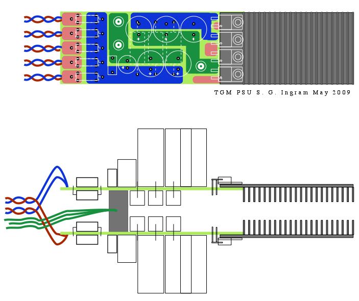

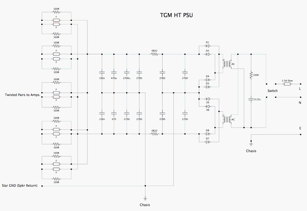

I know this is ground so well trodden that it's all muddy, but for my project with 5 channels with single supply some comments on this psu design wouldn't go amiss.
Although each channel is designed for 25W (or so) the speakers are rated at only 15W with 91dB sensitivity.
If I were building a mono-block I would use around 5000uF per rail - i.e. I prefer modest capacitance for reasons that include inrush current, cost, size, and some rumours about sonic tradeoffs 🙂

nobody...?
Is the RC worth the trouble ?
Is LC even better ?
Do you see a problem if I make the -Ve and _Ve rails on separate pcb's joined by their earths using a solid metal block and then using this as the star gnd ?
(attached - pcb's mounted back to back, vertically allows vertical heatsink fins for the rectifier diodes)
Is LC even better ?
