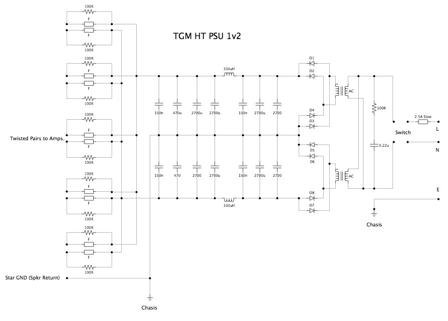

So I've redrawn the psu design with a CLC design, based on the Digikey choke I linked above.
It's not a monster choke because I'm using it to reduce hf noise (e.g. from rectifier diodes) rather than for ripple rejection.
if I've understood it correctly, I get -36dB isolation at 1kHz and -75dB at 10kHz. The CRC set-up would give me only -17dB and -36dB respectively.
Can you see any traps I've fallen into with this set up ???????????????
The diodes are good to 8A continuous, 16A repeated pulse at 50% duty cycle. I figure this is good enough when 'full power' from the secondaries is less than 7A (18V secondaries).
Total capacitance per rail is 10.8mF (50V). It's not great for ripple if operated at the max. current rating of the secondaries but this isn't supposed to be how it's used.

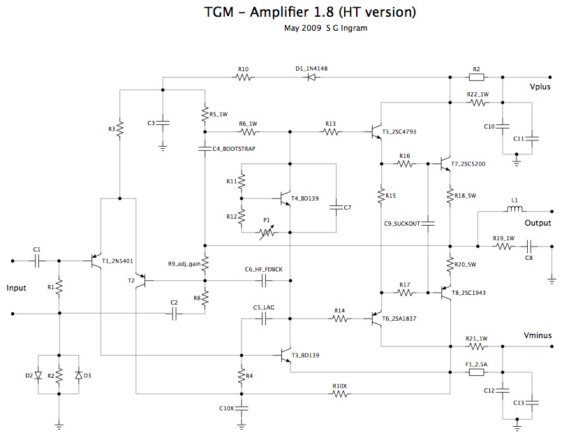

Updated Schematic / BOM:
I had a couple of emails asking me for BOM. So time to reset. The little pcb I made and populated with parts is the basic version, TGM1v8. The schematic is repeated here (attached).
some comments: this is planned as a nominal 25W module in a multi-channel amp for use with sensitive speakers. The source is a Blu-Ray player which has a 10kOhm 2Vpk-pk output. This means that I don't need a high level of gain from this amplifier, in fact I have to add an attentuator /volume control yet.
So the value of R9, which sets the overall amplifier gain may yet be tweaked to suit my set-up. I'm starting off with a relatively conservative gain.
I have also some space restrictions and I want to keep thins neat and tidy whilst I experiment. So I have NOT included a few items onto the pcb. These are:
R21, R22, F1, F2 - the power rail fuses and resistors. I plan to put these on the psu board instead so I can see all my fuses in one place. For people powering up the amp for the first time, it's recommended that you do so without fuses but with R21 and R22 in place to drop the voltage/current and so protect the amp in case there are some problems.
C10, C11, C12, C13 are the power supply filter/decoupling and I've left these off because I expect to have short connections from the power supply to the amp. This goes against all recommendations so anyone trying this does so at their own risk.
R2, D2, D3 are also excluded from the board. I plan to include all the ground lift resistors on the volume/attenuator pcb which will be mounted near the rear panel where the signal inputs are located.
Lastly, L1 is not included on my pcb because most likely I won't need it. If I do get instability then I'll have to put them in. I will install them not on the pcb but close to the speaker binding posts on the chasis rear panel.
Some other comments: The supply voltage for 25W should be enough to achieve around +/-24V rails under load. Given a +ve supply rail voltage, the bias current through the LTP (T1 and T2) is set (approximately!) by i = +Ve supply / R3. As said earlier I'm planning to use a low bias current, somewhere between 0.5mA and 1.0mA. I've populated my pcb with a 39k resistor. You may want to experiment with this value.

Here's the BOM (attached) for TGM1.8F.
The blue colour highlights items not installed on the pcb.
I haven't yet 'invested' in audio quality resistors. If I ever do, it will be for those in the signal/fdbk path like R9 R13, R14 etc.
I haven't invested in 'boutique' capacitors either. But I did choose good quality capacitors, including 'audio grade' for C4 an perhaps in a flash of enthusiasm I also used this type for C3 which filters the front end supply.
There are some options I have been thinking of, those are for future experiments.

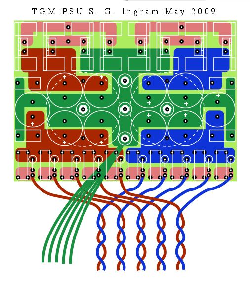

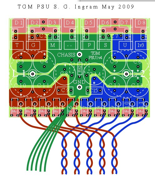

And now looking to the power supply. Updated to single board, Chokes mounted underneath. I've allowed two 2,700uF on each rail before the choke, another two after the choke + a third spot which can be populated with an extra 2,700 cap or a 1,800 / 1,200 / 560uF as they are all available in the same footprint.
Should be able to get this pcb made and populated this week. Then, if it works as planned, I have something to test the amp with 🙂

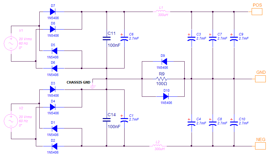

Hi Gareth,
You might want to consider splitting the ground as shown below. The 100 ohm resistor (with opposed diodes) isolate the audio ground from the chassis ground. Helps (I think) to eliminate ground loops and keeps some of the high frequency noise from the diodes and bypass caps out of the audio ground.

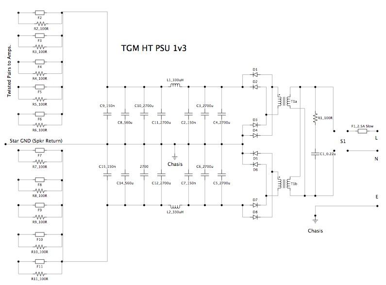

This forum is good at keeping me honest - I had slipped in a little change to simplify the grounding but you are right, it's not the best approach.
Trouble is, I cut the raw pcb board, so now if I make changes it has to fit on the same board. A challenge I can meet no doubt.
How does this approach match up to the ground lift resistors on the signal inputs ?
** I am concerned about instability in the psu because of these chokes though. The L and total C produces some options for oscillations does it not ? - can anyone put my mind at ease on this point ?? ** 😕
