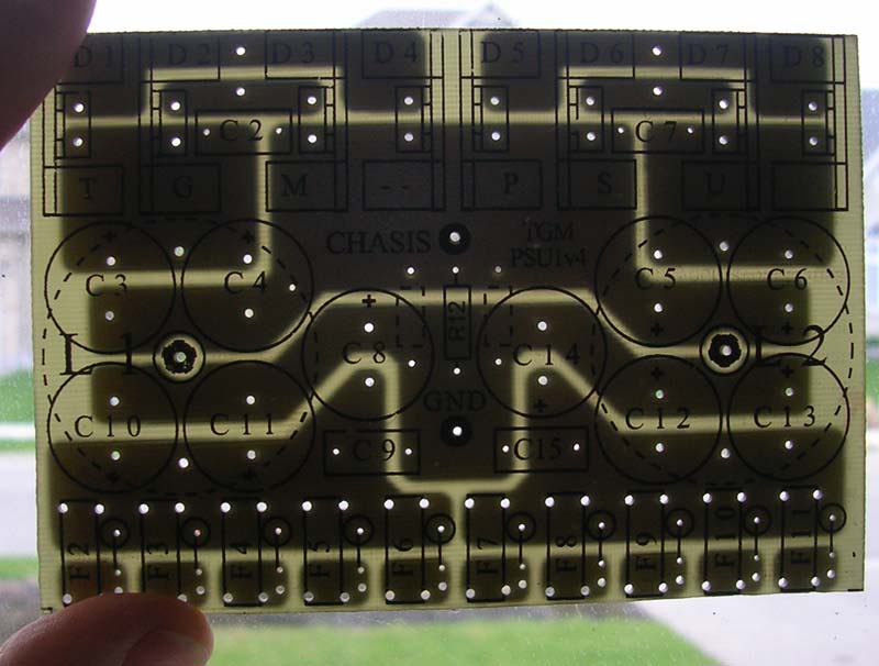

And now that I have sorted out the pcb making, it's actually enjoyable :smash:

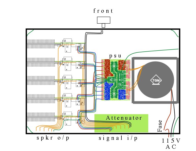

I'll need to decide where things should be bolted down in the box soon. Trying to keep incompatible wires away from each other or crossing at 90degrees. Keep rectifiers close to Trafo but far from amps. Keep psu board near to amps. Put amps where heatsinks can be bolted to side of box - if it ain't cool enough I can replace them with something beefy without re-doing the chasis. Keep 115V AC in a corner away from prying fingers. Anything else ?

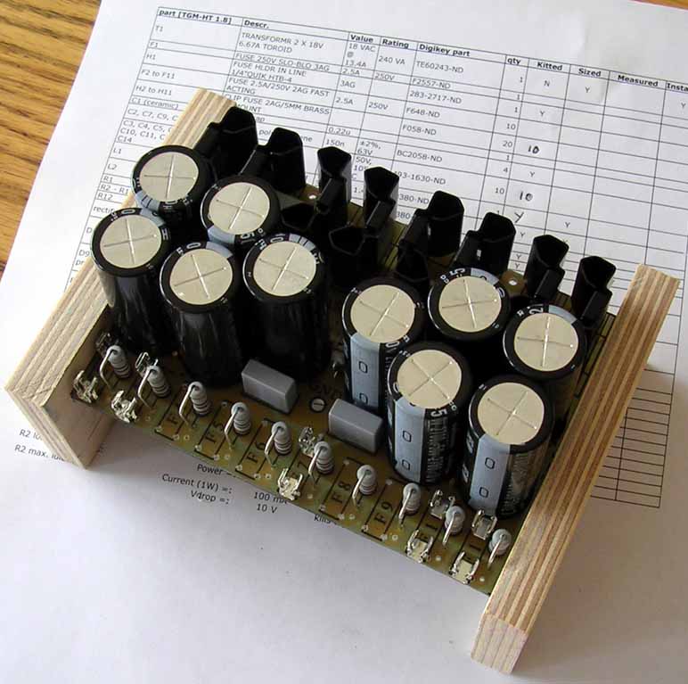

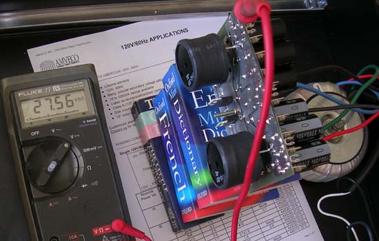

By Bigun - Good news - the PSU works, first time thankfully. No exploding capacitors.
Having fun yet. 🙂 You are lucky with only 27V , not in the "one flash and your ash" realm yet.
Very good work for your first one , It took me 3 "rounds" to get as refined as your work. I've done one,(reversed polarity) at 30v ,
swelled cap , smoke , maybe a "pop". 70-80v is not as forgiving....
BOOM-POW :bigeyes: (duck). :hot: :hot:

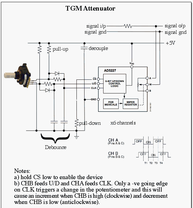

Anybody used the digital potentiometers ?
I'm thinking of a fixed series resistor per channel and a digital resistor in the shunt position. The signal is less affected this way, to my understanding.
I would look at something like this for a simple up/down 100k resistor {http://search.digikey.com/scripts/DkSearch/dksus.dll?Detail&name=AD5227BUJZ100RLCT-ND}
together with a shaft encoder {http://search.digikey.com/scripts/DkSearch/dksus.dll?Detail&name=GH3071-ND}
and that's it !
thoughts ???

Here's a more graphical description of my hair brained proposal. It doesn't explain everything, but the key thing to note is the little diagram showing the 2-bit output from the encoder and that if you rotate it clockwise the timing goes from left to right, if you rotate anti-clockwise it therefore goes from right to left. And this makes all the difference !
There are some details to be understood, such as the power-up sequence for the digital potentiometer.
The cost looks more than reasonable for this approach, although there's no through-hole package available for the digi-pot (I don't consider this an obstacle).
However, it's volatile, resets to half-way on power cycling. That could be an issue, have to think about that.
But will it work ???

Looking at the AD5227 datasheet, the analogue signal range permissible on pins A,B,W is restricted to between GND and VDD. This means that your signal input (and signal ground) lines will need to be biased to around VDD/2 = 2.5V with respect to the IC's GND for maximum usable voltage swing.
There is a significant capacitance (140pF) between pins A and GND for this device. The resistor shown between 'signal i/p' and 'signal o/p' needs to be selected such that this capacitance doesn't degrade the high frequency performance too much. For example, if this resistor is 5.6K ohms, there will be a 3dB attenuation at 200KHz. Why not wire pins A,B,W as a conventional potentiometer?
As the device only draws 3 microamps from the supply, battery-backup could be investigated in order to overcome the 50% power-reset setting limitation.
