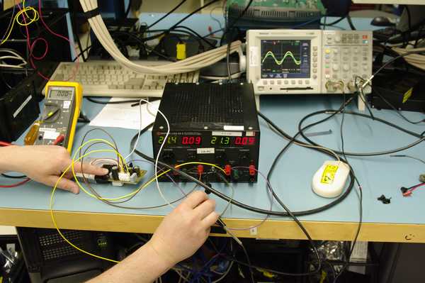

Kind friend found me a bench and power supply.
TGM1 was powered up for the first time. I made no adjustments, the q. current was around 80mA per rail. The bench supply could go no higher than around +/-21V. The voltages on the base of the output devices and driver devices was about right. The heatsink got quite warm and the current draw increased. I held the VBE device on top of the output device with my finger and the current draw fell back.
However, the heatsink was still pretty warm. I couldn't see oscillations with a scope, but it was hard to see really HF because a fan on the benchtop was contaminating everything (including the supply gnd).
So, first power up, no adjustments, output offset was -ve 30mV. Not bad eh? 😀
Gave it a sine wave input and it was clipping - amplitude of input too high. You can see the input and output on the scope at 1KHz. The measured gain was 16. I will have to check the resistors but I think it was supposed to be around 14. Not bad.
I ran the frequency up to 100kHz, saw the output halve it's amplitude around 90kHz. A bit low maybe.
But there was no load on the output and there are wires everwhere. Also, at the lower supply rail voltage the current through the LTP will be quite small, no doubt the gm is not where it's supposed to be.

It lives... cool.
Good deal. 😎 no
. 30mv is not bad for no LTP emitter degeneration. (this is the same as circuit?). You were lucky to have a lab supply with readouts (.09 = 90ma) I had to calculate with 2 sacrificial resistors (poor mans fuse).
That is a rather small test HS in the pix (good for drivers ,not op's)
Are you still using the 100pF Cdom? Still , try some 10khz square waves, that will show you the "truth" as far as compensation goes.
Once you have it working to this stage , it is usually safe to give it it's final supply rails , change capacitor values to a certain point (tweaking), and finally listen to it. 🙂 good work.
PS.Those look like very young hands? 😎

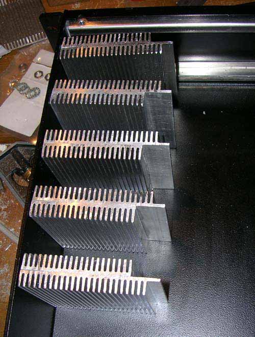

The HS was small. But the heatsinks I've made up aren't that big either (attached). I happened to have half a dozen metres of extruded heatsink and thought that the least I could do was to use some of it. According to the spec. sheet a 3" slice is around 1.67degC/W and I simply folded a 3" slice back on it'self to make a double sided HS. I don't expect ever to run this at full power (25W). It took some cutting, filing and swearing but I'm getting that sinking feeling this isn't going to cut-it (as usual in this hobby things don't seem to go right always) 😡

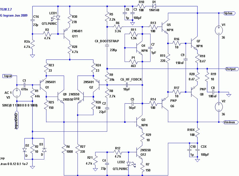

By "Cdom" if you mean the capacitor I have on the VAS - this is 68pF. To 'play' with this value I will have to order more capacitors, although I have some 22pF I can try.
If you keep your bias reasonable (60-70ma) , with only one pair of
OP's , that will work. What you have = 1 P4 heatsink (1.5c/w) , I ran 2 pairs on 2 with no gross thermal issues. ventilate them well with holes below and above (or a big hole with screens).

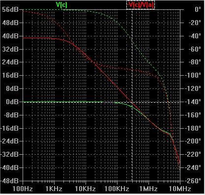

I have found 68pF to be the good middleground between performance and stability. (attached) -3db is around 100k and the unity gain point is 300k. What you tested with yours seems to be right on with the simulation(-3db @90khz). Beware ,22p will give overshoot and ringing (maybe even oscillation).

The 22pF caps are for the HF comp, from the VAS collector to LTP inverting input. I remember some advice on the forum regarding Cdom (Hugh ?) which suggested a range from 22pF (tizzy trebble) to 100pF (sluggish).

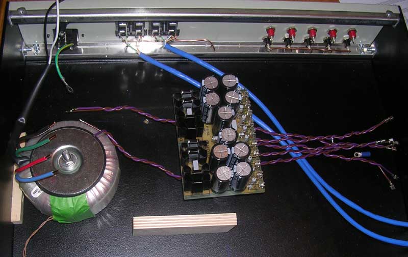

just in case it seems like I'm not doing anything, here's the chasis slowly coming along.

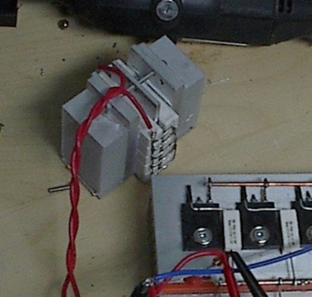

Added the wiring to the psu board, added a dozen turns to the donut for the power-on indicator LED, installed twisted pairs to the RCA connectors and added an earth bus to the speaker terminals (not as ideal as separate star earth connections but this will be upgraded if necessary).
Had to add a piece of wood to stabilize the chasis - it wasn't designed to have a Trafo bolted to the bottom plate so I had to anchor it to the chasis side.

What I have in mind is a amp that :
A. Can be used with rail voltages of 20- 45V without component changes. This is where a CCS works out well 🙂 .
B.Can use a wide variety of devices (it's a big world - not everyone has everything) with only minor documented changes to the original design (BD vs KSA/2SA - carlos should calm down.)
C.physically allows upgrades , start out with cheap junkbox 2200-3300uf caps , PCB allows 10,000uf @50v as upper end. Extra pads for tweaking (compensation options) This way we can hint at the last few IP tweaks to get to the fancy kit level 😀 .
D.Sound quality, safety and durability. Results would vary depending on the individual's choice of A,B,and C , but managable with simulation/documentation.
Finally a name , people are fickle , one with a catchy name will psychologically sound better 😕 😕 I did offer carlos the answer to his fast device oscillation problem (1-22r/miller value change) , he saw it as "messin' with his baby". We have dozen or so new constructor's a week, many of whom buy those chinese kits with fake parts or build from dubious plans found on the web.
edit: I don't want to hijack anything , just make this DIY thing a little easier for a Nuub with a budget and not many resources.
