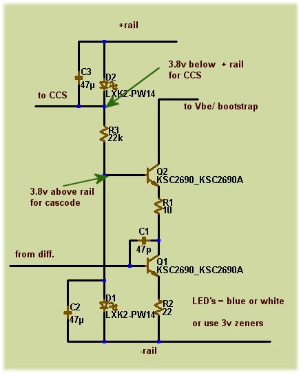

Just an idea, gareth. I did this with a blameless (attached) , biased both the VAS cascode and the CCS together from rail to rail. It should rock with the TGM. (super PSRR).Gareth, the position of Q12 is wrong

Lumab, OS,
My thinking is not a Cascode. Maybe I don't understand, perhaps the Cascode is the same thing as I am saying ? What I am looking at is a current sink under the VAS. I don't want to isolate the VAS from the sonic benefits of the bootstrap so I figure the current sink has to live down there at the bottom out of the way. It will try to control the current flow through the VAS but it's a couple of junctions away from the bootstrap node. Am I embarrassing myself here ?
Don't feel bad , I knew much less when I built my first ones (still don't know enough).
What you are doing is not really isolating the VAS device from the bootstrap , just linearizing it, current wise . Since the main VAS device is not doing the "work" anymore, memory and miller effects are more constant.
read this article.. http://peufeu.free.fr/audio/memory/
(part 5 - VAS)
A current sink under the VAS might not work for number of reasons.
