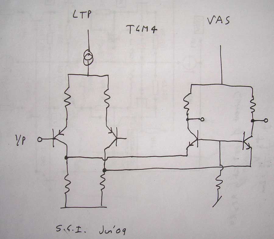

Back on topic
Guys, you have my grey matter in over-drive trying to learn about common base.
I am thinking more about the common base. And I see that the simple implementation is now quite a problem for the LTP balance. My first set of simulations showed an increase in distortion and I think this is the cause.
And as I established a constraint of no current mirrors, so it leaves me with few options. I tried to find some ideas from the tube guys, who seem to like common-grid for phono stages [http://www.tubecad.com/2007/08/blog0116.htm]
One option is to go more symmetrical. I make two common base VAS devices, driven by each side of the LTP. This way the LTP is loaded the same on both sides. Sketch attached (you can see Lumba's schematic showing through from the other side of my sketch!).
Not sure yet if this common base has enough drive capability for the output. Self shows several VAS improvement schemes but points out that the non-linear input impedance of the output stage requires buffering.

Hi . Gareth. Your latest image looks like the Roenders's amp , at least in principle. He cascoded both LTP and the balanced VAS to come up with his final amp.
Here you hit the "nail right on the head" concerning my design choices. I was "torn" between roender's amp and the symasym. With more than a couple OP pairs , I needed more drive. While I do admit that the common base sounded better (by a VERY small margin), I would of needed a triple EF and 4 extra components for the LTP/VAS (cascodes) to both be able to drive a large OP and run the common base precisely.
While I thought that using no typical Cdom was real cool (wow , the speed- perfect 50Khz squares with almost 100 v/us slew) , it was very hard to differentiate the sound from the enhanced symasym. (both sounded great)
Another point to make , the ideal balanced VAS does use a CM, not on the input pair , but right on the VAS. 😱 Some , like Roenders and MJL's , even use a Wilson mirror CM.

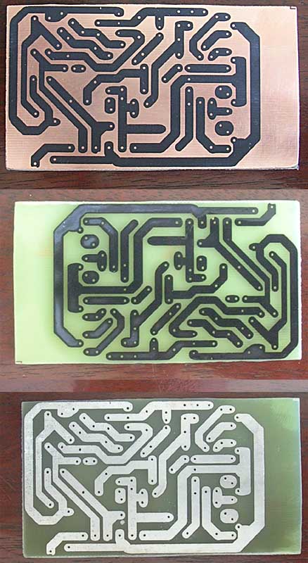

OK, it's sunny and I have to stop 'work' and go make a BBQ etc. 😎
But I have started on the 2nd channel. No changes to the pcb. I will use these first two channels for the rear speakers (I will consider improvements for the front three).
And to prove that pcb making frustrations are behind me, (top image) toner transfer worked nicely first time, (middle image) etched and (bottom image) drilled (need to re-drill for large components):

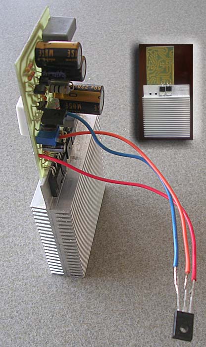

And finally
I now have a 2nd channel of TGM1. I checked dc offset (both channels too high of course), adjusted the output pair biass current, then connected it up. First listening test was with the DIY Fostex, a much cheaper 'fuse' than my PMC speakers
I find these Fostex 127 drivers really detailed and the amps have nothing bad to say about the music at all (except the hum that I haven't fixed yet which is louder with these more sensitive speakers). It sounded very good to my ears.
Still lots to do, but being able to sit and listen in stereo is a key milestone. And a good time to thank everyone again for their help and encouragement, you made a good amplifier!
I'm not sure if this is the last of the TGM1's - it wasn't intended to be one of those amps that others would build and the two channels I have will go into service for the rear HT channels. Next up I have a chance to try and build the TGM2 for the front channels and learn some more.
Still sounds good on the PMCs now, but my initial feeling is that the Fostex units make a surprisingly good match with this amplifier. We know this type of topology is a little warmer than some of the more accurate amps and these speakers sound to my ears to be very much at home with this type of amplifier. More listening time is needed.
