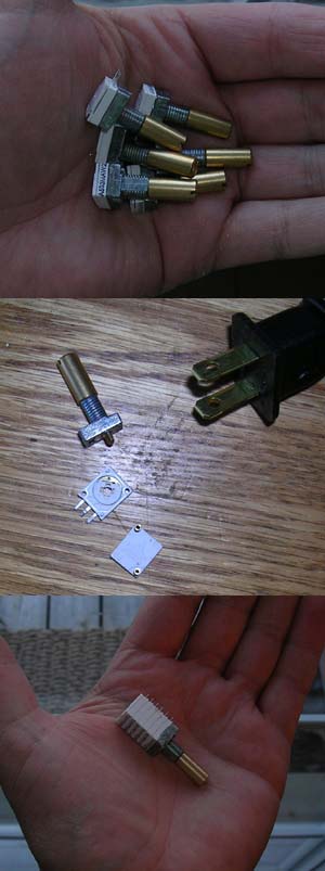

A little further research finds that the Vishay pots are not easy to find in 6-gang version. The 2-gang version are out-of-stock with a 1 month lead-time, so the only option would be single gang pots, six of them. They are held together with rivets, which will have to be ground off to dismantle them and then re-assembled with bolts.
I didn't design the layout of everything inside my chasis to allow a shaft to run from the front panel to the back, which is where you'd like to place the pot. So the pot would likely end up on the front panel with cables running from inputs to the pot and back to the amp boards (might not be so bad if I use individual shielded cables).

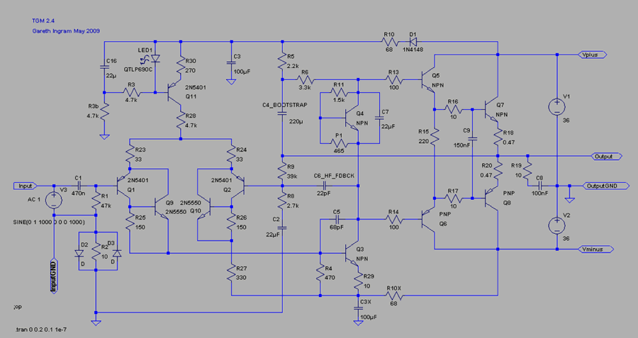

Now that I have spice, I made a model of TGM2:

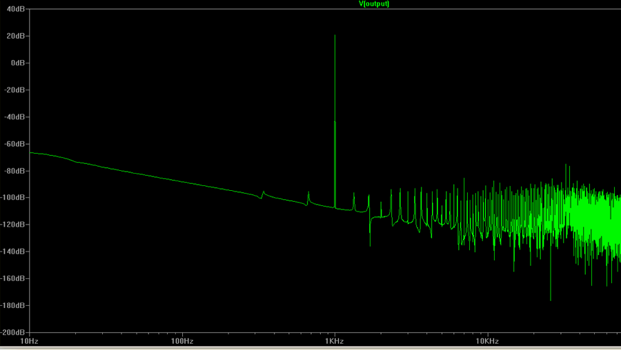

and it gives some preliminary results only.... I had to fiddle with the resistors a fair bit to get it to work and it took me awhile to realize that I had to tell Spice to use an LED model instead of a generic diode or the voltage drop wasn't enough for Vbe and then no current through the LTP...
but this design will have to wait for my next project, a stereo only project. As MJL says, I may be hooked and a 'next project' would confirm that :D
but maybe I should look at symasym, OS and Carlos have some good things to say...
TGM2 is lookin' alot like frugal 1B , right down to the CCS and bootstrap divider resistors.
Have you built the 1 yet? I already have 2 of what you posted for the 2 ... I think you will be pleased . I am going to do 2 more of the 2ish clones , but add 4700uf railcaps and the bridge right on board(amp /PS combined). Just hook up the 30-0-30VAC , 2 rear channels. :cool:
Besides R29 (I use 22r) , R28 retains the aska/dx sound while also improving PSRR. (some just hate current sources)
If anything , make your center channel a symasym , it really brings out the vocals..WOW.

It doesn't work, the resistances don't track well and at least one wiper is unreliable. I suspect the process of breaking them down and rebuilding them was too stressful.
So back to square one, with a lighter wallet :(
Nothing to lose (except postage) by sending them to me to see if I can fix em up.
I'm pretty handy...:)

Well, I have to be honest, I think I botched it. I used a small pin-drop of superglue on the location pins to hold the stack together - I am betting that I contaminated the pots by doing this even though the location pins are well away from the moving bits. Dis-assembling what I've built may be tough. The thing is sitting in Acetone, if this doesn't melt the conductive plastic I may be be able to strip it down and try cleaning it, but I wouldn't be a betting man !
