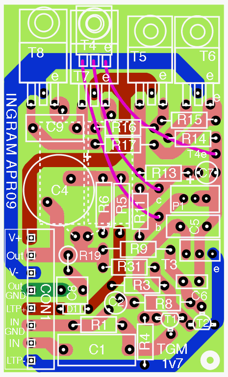

So going down the route of multi-channel amplifiers with a dual supply...
I've doodled a simple pcb which would give me something small and simple to try out with a bench supply. It also puts the devices on one edge (a more traditional approach) so that I don't have to worry about heatsink design at this point but can simply bolt it onto something cold (hmmm, what about a 6-pack in the fridge ?).
p.s. output device emitter load resistors mounted underneath pcb.

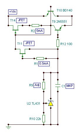

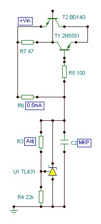

Lumba, I have to overcome my laziness, so I'd be wanting to understand a bit more about the integrated regulators. I'm not sure complex circuitry is a problem in and of itself. Not good sonically is an issue. But why are they not good sonically ?
Banwidth - how much do I need ? the LT1963A has less than 40uV of noise over a bandwidth of 10Hz to 100KHz.
Lumba Ogir said:John,
I`m not happy about it at all, believe me, but zener diodes are even worse.

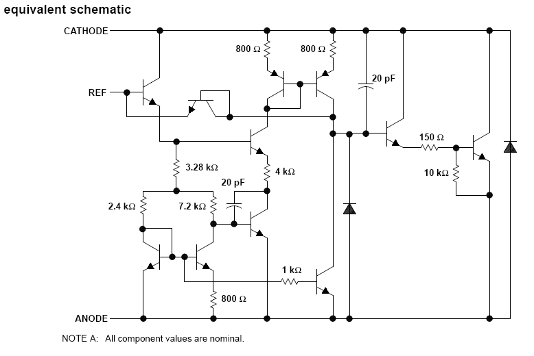

Does TL431 use a Zener diode for the reference?
Wavebourn,
may do, it has however a more favourable noise, turn-on and impedance characteristic but also some repugnant features like massive feedback and intricate circuit topology, depending on brand. Some IC regulators use 1.2V reference, which is preferable from a functional point of view.Does TL431 use a Zener diode for the reference?
