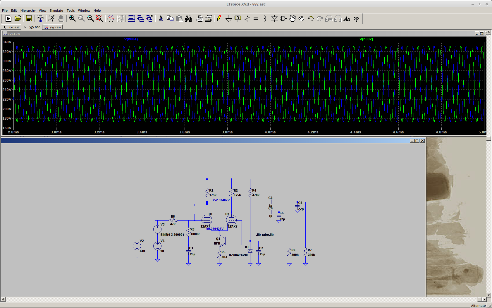

Any capacitance between pin 6 and 7 of v2 will make a big difference. Note to do open loop or bode plots you need to remove C4 and C5. Dropping R8 will help the stability. The HF loss will not be a problem once you close the loop.
That is a 10KHz square wave but not measured on the speaker output. This is measured at the anode of the phase splitter vs the input. The only residual issue once the loop is closed currently is poor performance at 20KHz. The design should be able to manage at least 20W cleanly out to 30KHz. Mine starts to distort at around 12W. I need to double check what I've seen, but I believe it is primarily one one half of the waveform only.If that's 10KHz square wave on your scope I would say that's good enough.
Like this, a kink starts to form near the positive peak of the sine wave. It doesn't seem to happen on the negative half. I still need to do some more testing to determine if it happens in the phase splitter or the output stage. (this shot is input signal vs speaker output signal)
Oh yes I see. Its quite a common problem - my K4040 had a similar shape actually much worse. It won't make that much difference to the amp musically. It may be the LTP is running out of stream with the miller capacitance. If that's the case you could drop the LTP plate resistors to say 68k and go with a 12AT7 LTP. You will need to drop the cathode resistor and the gain will drop which will need the NFB adjusting. Quite a lot of change. Interesting - nice to see you have the equipment to test and lots of photos.
Just simulated this and get the same result. You are running out of drive when the voltage on the LTP plate gets near 400v. You need about +/- 40v to drive EL34 fully.
The biggest improvement is to replace the 82k with a CCS. Increase the current a bit to get 250v on the plates and that seems to do the trick.

just get any ol 100V transistortwo resistors one zener one small cap bam you have a current source. You can calculate the current by zener voltage - 0,5V divide by emitter resistor and it ill be roughly close enough for what you need anyways .
it easier than modding the entire V2 stage to a differet tube. Much faster at any rate. I suggest you try it before completely changing out the V2 circuit
Given what you have built a CCS is well within reach. The Ltspice schematic has one in which has the correct values for you. You may not want a transistor in your design, but it seems the easiest fix for you getting enough drive level and symmetry at 20KHz. Another option is an EF86 as a CCS.

Yep you can build your CCS with an LED and BD139, feed about 1ma from the HT (say 470K) into the LED. This will generate about 1.5V depending on the colour you use. Add a cap across the LED. Connect to base of NPN. Emitter resistor on NPN sets current. So R = (1.5-.65)/Iset. Iset is about 2ma I think as you want 250v on plates of V2 and half the current flows through each. Add collector resistor to drop a bit of the voltage (say 40v) to bring into range of BD139. Say 40v/2ma = 22k. If you need schematic I can get one. You may not need the veroboard - may just build it around the BD139. There's only a small dissipation on the transistor you could use say a TO92 package.
