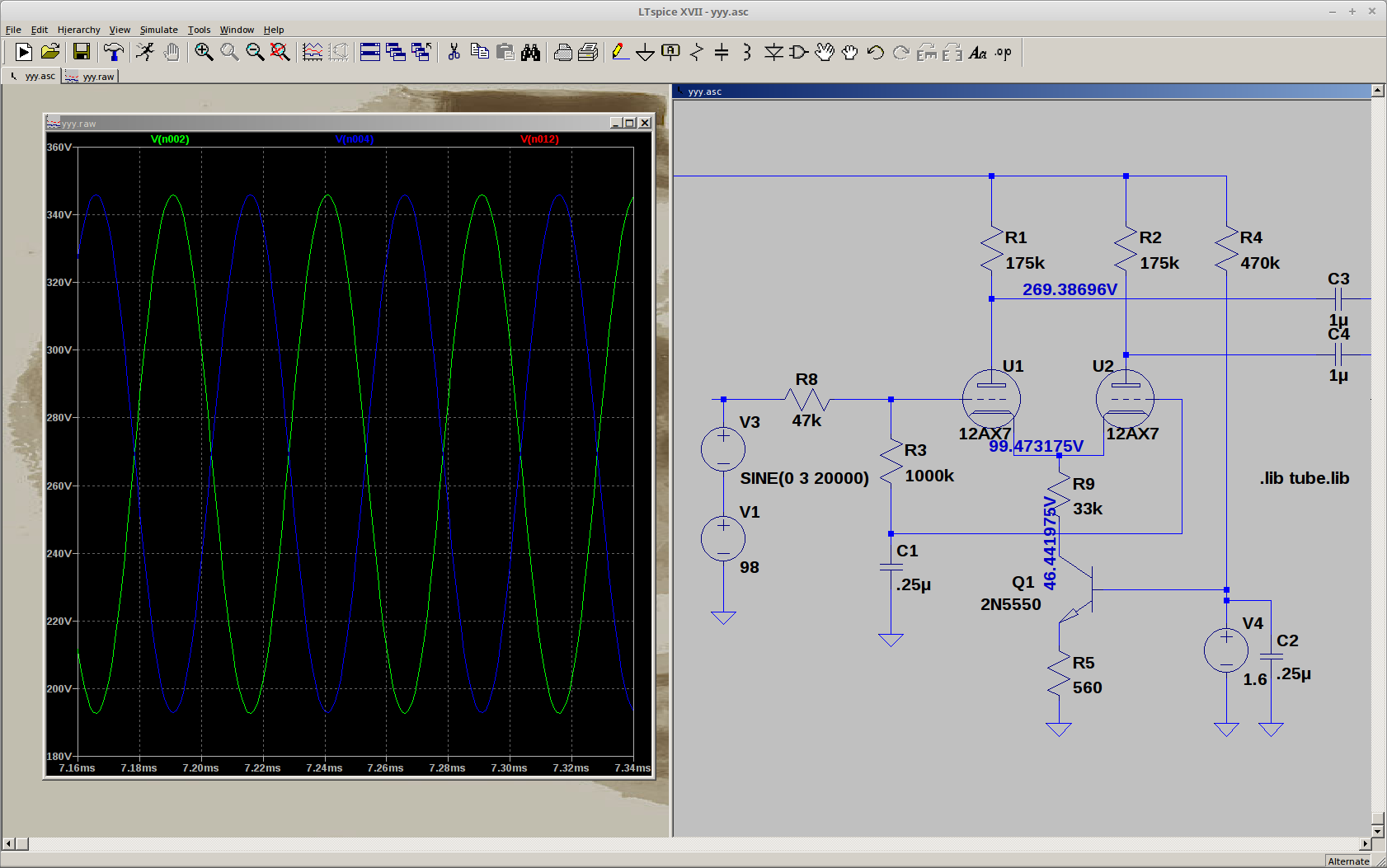

More accurate values. V4 is your LED.

Anyway I just created a veroboard layout for the CCS as shown above. It seems remarkably simple, almost too simple. (Makes me think I've missed something obvious)
That little board would replace R8 on the turret board.
Just that the veroboard don't withstand 400v between strips. You would need to pull up a stripe between. Your OK up to 125v on adjacent strips. You could put your 470k on the turretboard.
Yes, putting the 470K resistor onto the turret board is easily doable. If I take the 470K resistor off the board, the voltages are low enough that I wouldn't need to increase the separation. If I were to actually implement and use this, I'd probably varnish the veroboard too.

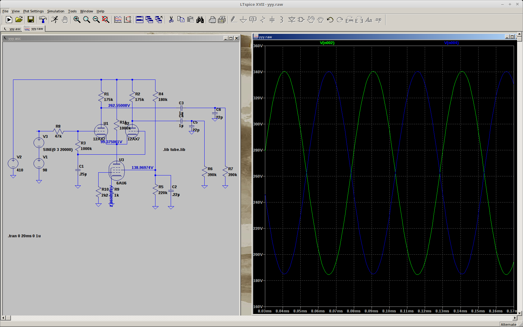

try it in a simulator. I did in a very simple simulator that isnt even meant to deliver any meaningfull numbers but comparing two to each other shows that a CCS improves AC balance quite a bit.
http://tinyurl.com/y9vzn8rc
just take a look at it on the left side is the CCS and right side by the schematic. Hovering over the scopes will highlight the measured components. Not really usefull for any meaningfull numbers but it shows. And every triode there is the exact same parameter all matched all ideal components.
Actually there's not as much difference in simulation between the CCS and just a simple resistor! The high gain of the 12AX7 and the high voltage of 80V cathode to ground make for little change. The biggest problem with the circuit is that the plate voltage on the LTP is too high so that there is not enough positive drive to the EL34's. Dropping the resistor from 82K to 68K or 47K improves the drive a lot. 260v on the plates is much better.
Sorry, just broke the simulation... I agree the constant current sink does appear to improve the balance. I was trying to change the valve gain to see how it performed with a lower gain valve but then I broke it. It does only improve the balance and does not completely cure it and of course there will still be differences in the gain of each half of the double triode and it will not fix that either.
It is very counter-intuitive, but I am now sold on the simplistic conclusion, that with a constant current source the outputs must oppose each other. So exploring this conclusion at the limiting condition of having no gain in one of the triodes, there would be no output (the cathode would follow the grid), whilst a badly matched pair where one triode is nearing cut-off for part of the cycle would show a heavily distorted output on both anodes.
yeah its kind of touchy :D
took me a few minuts to stabilise that simulation. As I said its not really meant for stuff like this
