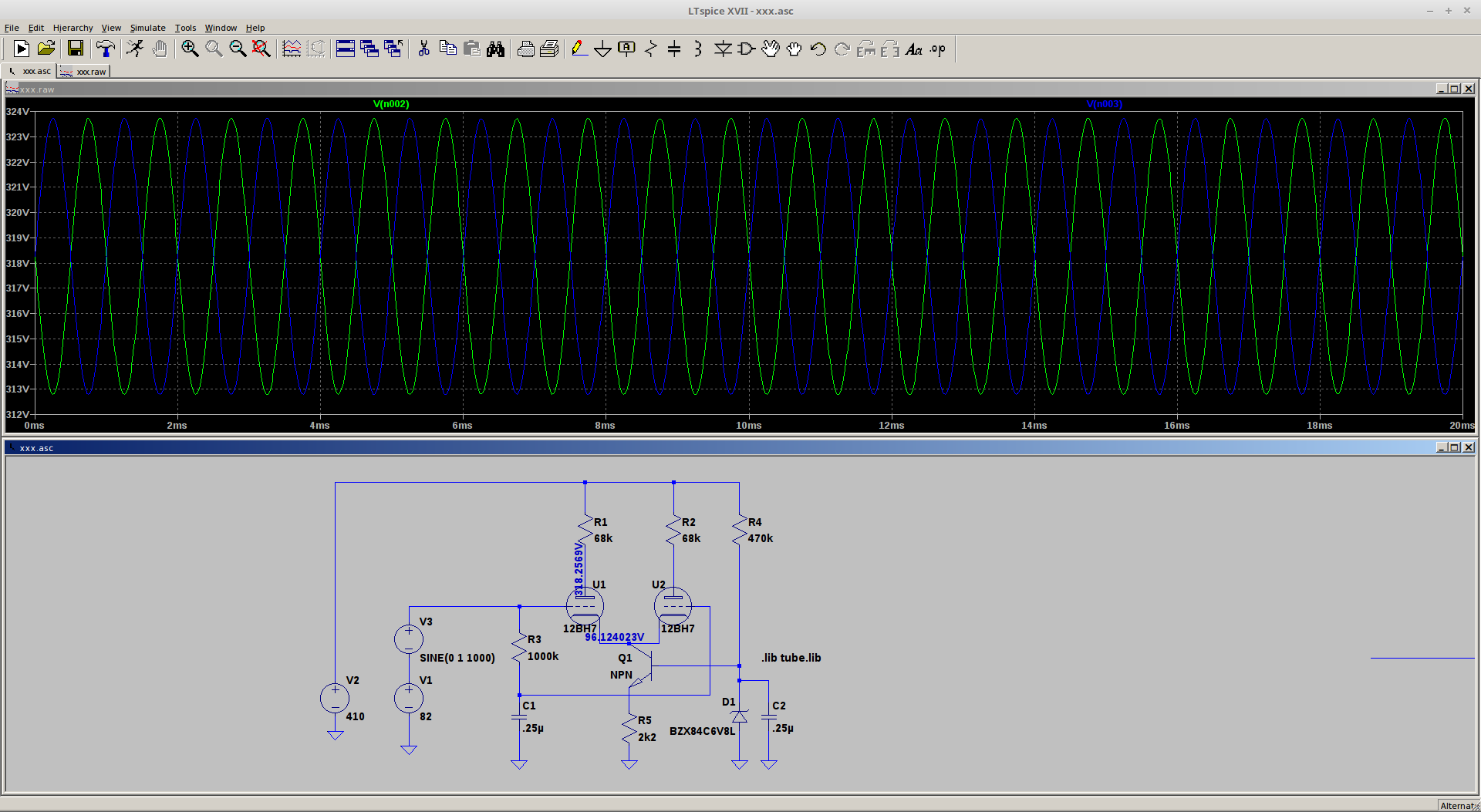

since I am not a tube designer could someone scramble some values of resistors together for a phase splitter out of a 12BH7? 12BH7 are usually used as buffers when driving KT88 to almost 100W or any phisically big tube or a multitude of them. Could someone make a schematic of a DC coupled 12BH7 long tail inverter that would have 70-80V on the grids?

Most of the time, the 12BH7 is a drop in replacement for the 12AU7 and parts value changes are not needed. THE issue is heater current availability.
Thats nice to hear. But could we really increase the max performance (in all regard mostly in term of drive level and drive power) . Like instead of drop it in and go lets optimise it to really squeeze all the performance out of it that there is

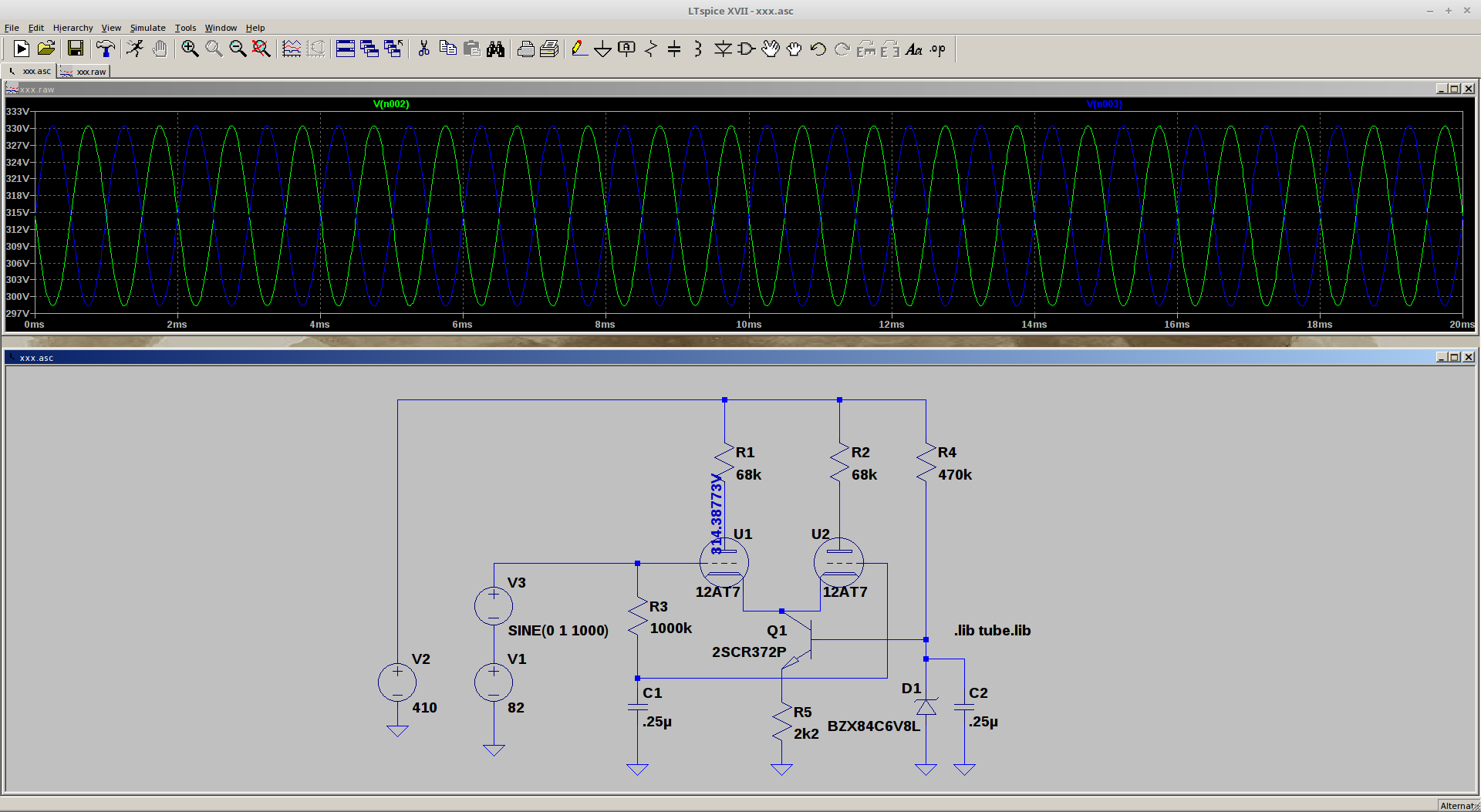

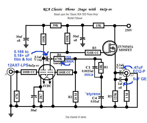

I could suggest that a 12AT7 has more gain than the 12AU7 and makes a good phase inverter. You could add a CCS in the cathodes if you wish.
That looks rather nice but I would like one with the 12BH7. Naturally I would think a tube with lower plate impedance would be able to drive awkward loads better. If you could do the same with a 12BH7 (and adjust the circuit to maximise the performance for that speciffic tube)
I dont think we would need that much gain in the inverter stage. The EF86 in its orginal config has way too much gain anyways.

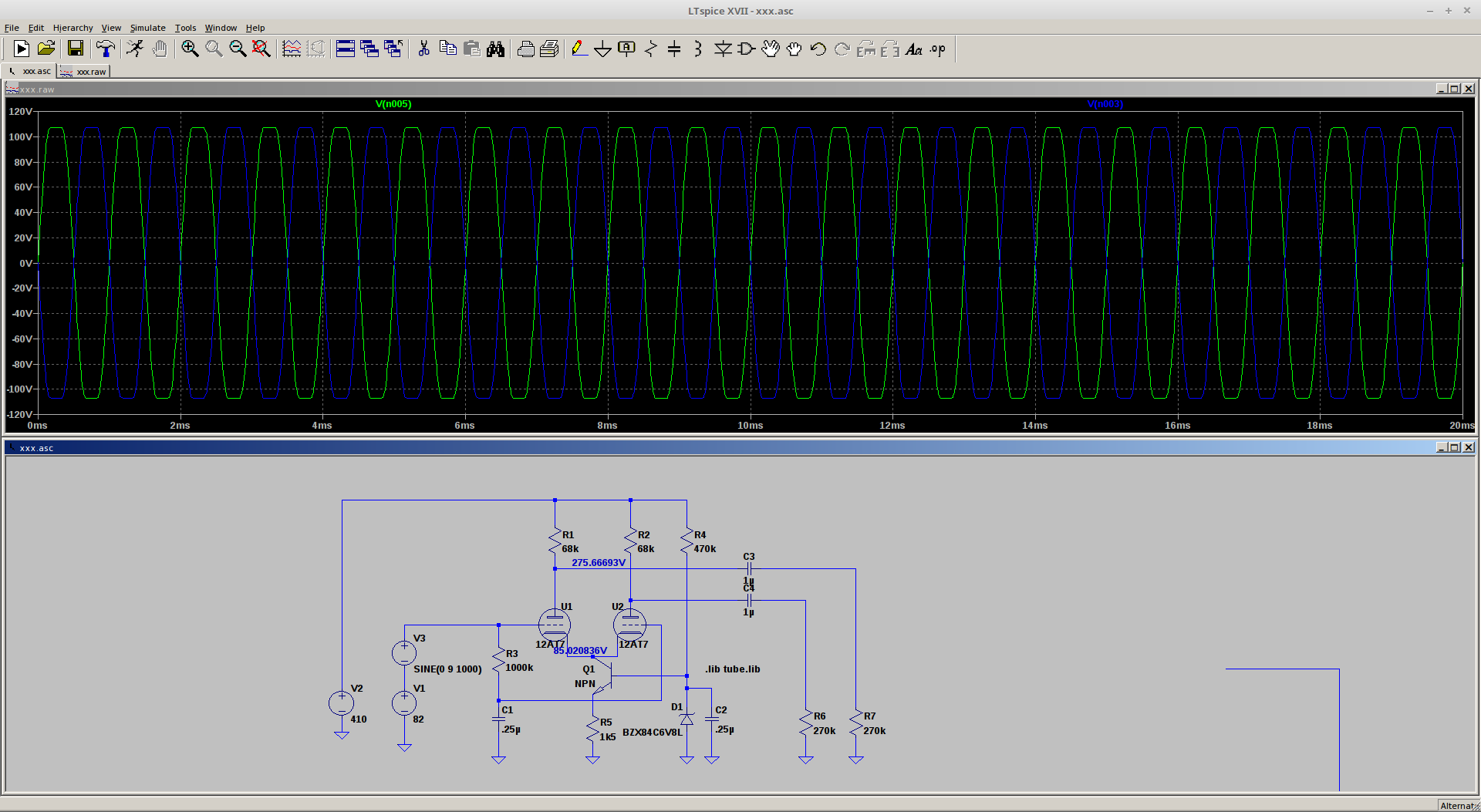

I will definitely try that. I wish PCB based stuff was easy to mod . But I don't really care about visual quality in my prototype amp hah. If I would decrease the 2k2 resistor to the 1k5 what kind of drive level should I expect? (Max voltage swing into the output tubes). This would be nice to know since KT88 require a fair bit more drive than EL34 not just by more drive power but quite a lot more voltage aswell. Then I could put KT88s into the output change the bias resistor to 600ohms run it 500V and it could do 50W straight into the same transformer (assuming I can drive the EF86 hard enough which I can because I have a line level out from my computer that gives me a 2Vrms signal )
OK for KT88 cathode bias from data sheet R13=R14 = 270k therefore C6 C7 = 1uF on your schmatic.
You may want to add some 2k2 grid stoppers just in case. You may also add say 470r into base of NPN for same reason. NPN will need to dissipate 500mW and be high voltage. HFE is not that important.
The answer is loads of drive. You could even run the first stage at say 100v plate.
You may need the 16R tap on the transformer for KT88 to get most power.
The 12AT7 has more gain which means the first stage don't give as much distortion- but both work fine.
That looks rather great to me.
