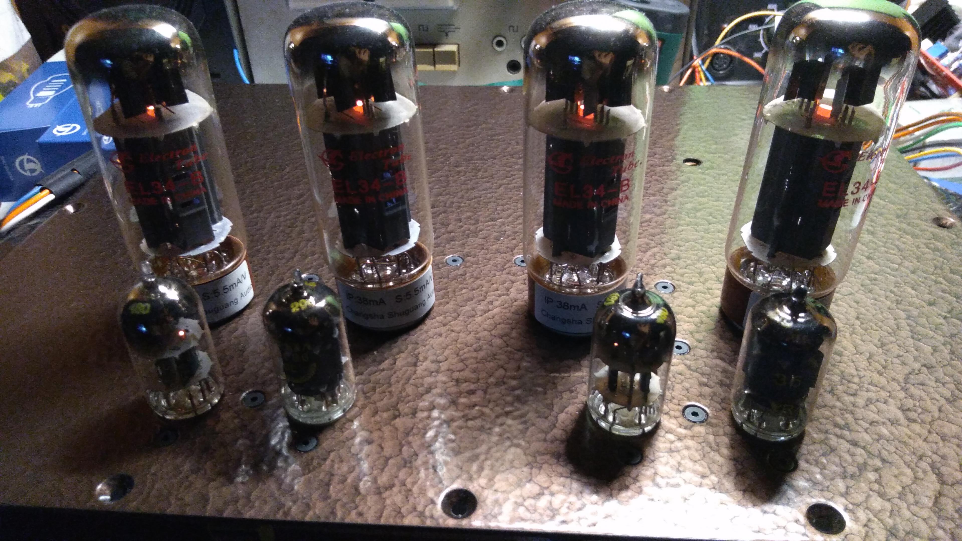

The wooden chassis is only temporary to prove whether or not the layout and tag board arrangement works. It will be reassembled onto nicely machined aluminium panels as a pair when I finish with the fiddling. I've considered the EF86 as triode mod as that's likely to be the only change I would consider making.Firstly, your have made a neat job, but personally I would use metal rather than wood. Both fire risk and also shielding from main hum and other external interference.

Been a while since I posted on this. Mk2 built using the second set of components performed almost identically to Mk1 proving that clearly my homebrew layout wasn't an issue after all.

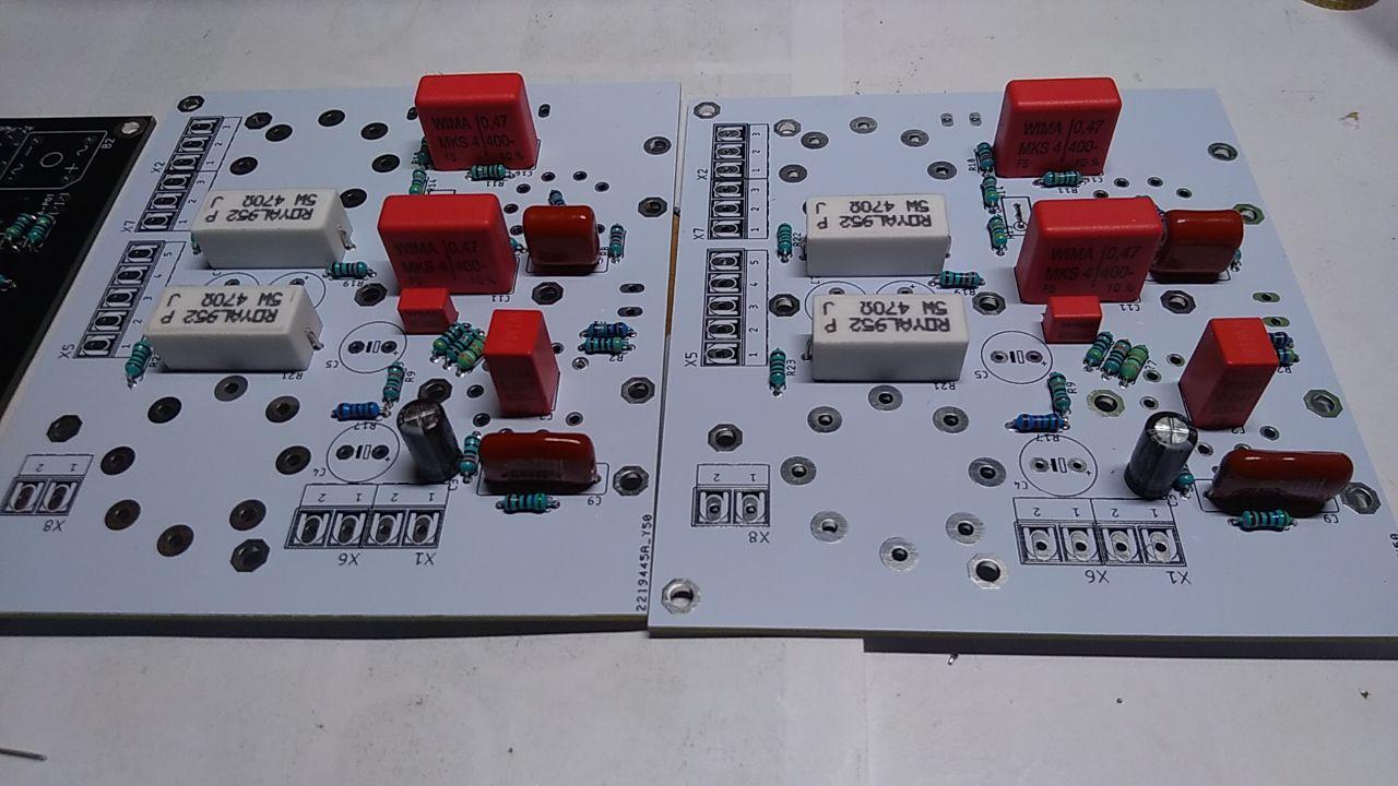

This is how the layout turned out.

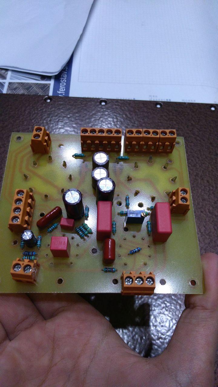

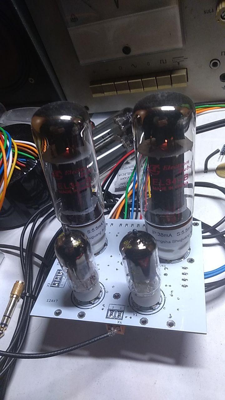

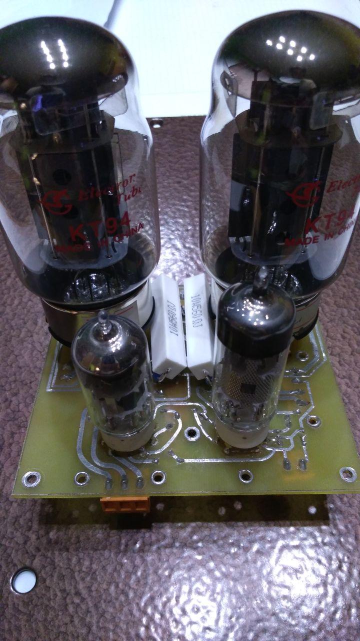

Here Ill send some pictures of my approach to this amplifier 🙂. All tho I am a PCB nerd I definitely apprechiate the beautyfull work of yours actually making the thing work and look very neat with the turret board. I also included my prototype so you can at least see how the layout looks like. The white board is double sided and I am using one side as a shield (no current running trough it just as a shield.
I actually didnt have the change to measure performance of my amplifier with a scope and frequency generator but at least from the hours of listening it seems just okay. I may need to to tweak the NFB capacitor aswell because I am using toroidal outputs which is quite different from the original. I will eventually measure my amplifier just got have time for it aswell 🙂

R18 & 19 are on the valve sockets. C4 has been increased to 47uF as I had the one from the first build but don't have any more to do the others. Doesn't increasing those cathode capacitors increase the likelihood of LF instability when global NFB is used?Just some suggestions. (Electrolytic capacitors have come a distance since the 1960) I would check the values for C4 and C5 and increase these from 10uf to those used in Claus design ie 47uf or 100uf. Likewise, I would increase C13 and C14 to 220uf or 470uf.

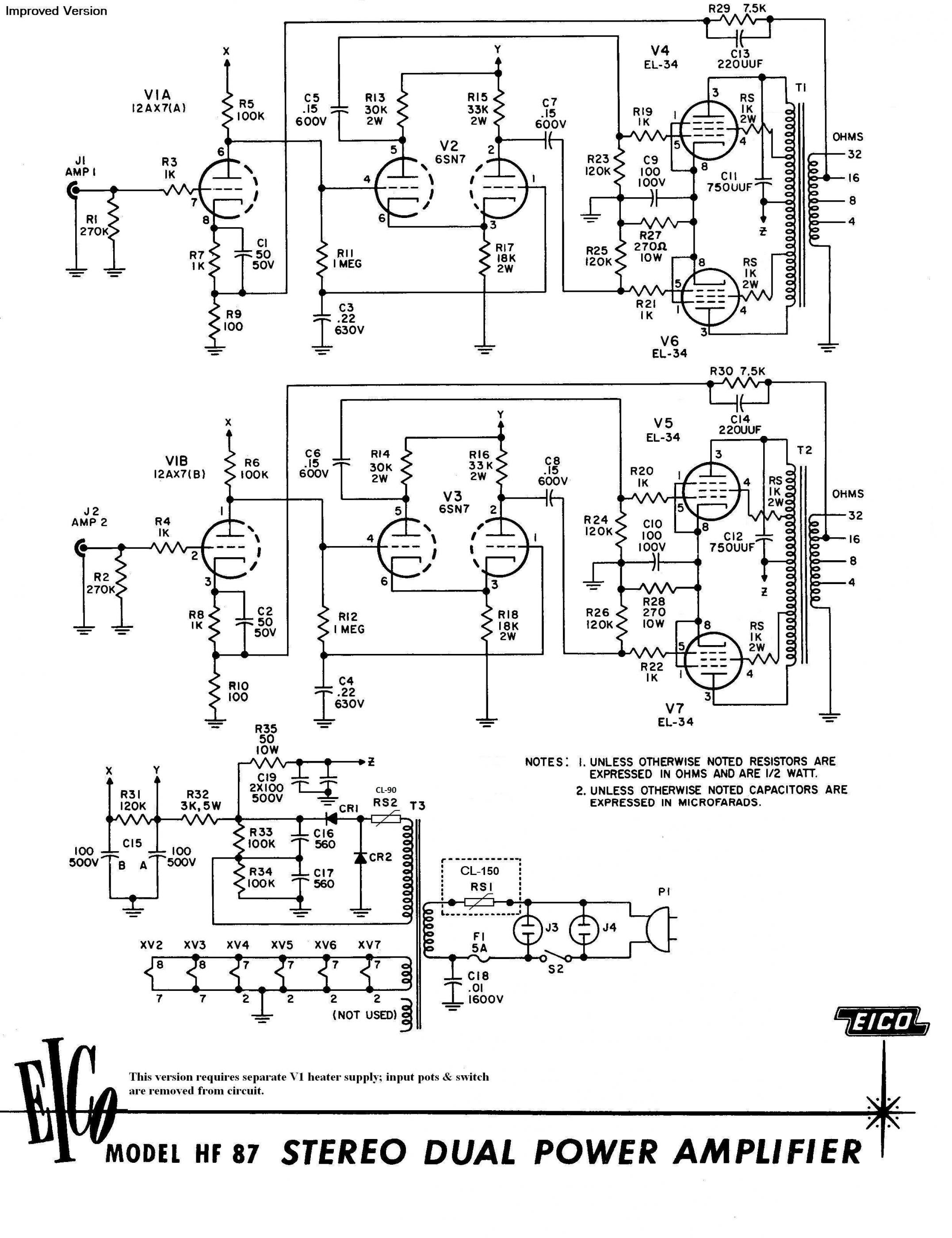

Folks, let us never forget that Mullard published the 5-20 design to sell stuff they manufactured. The topology is good, but some of the implementation details are not.
Asking the wimpy triode found in the 12AX7/ECC83 to drive the CMiller of a UL mode EL34 is not good.
Identical LTP plate load resistors (R11/R12) works only when the tail load (R6) is sufficiently large and, at 82 Kohms, it's not. Fortunately, this is easily remedied by replacing the resistor with a 10M45S constant current sink (CCS). CCS loading LTP tails forces symmetry between the 2 sides and allows medium μ types to work very well. Sometimes, things "play out" to require connection of the CCS to a "short" negative rail, instead of ground.
For purposes of comparison, I'm providing the schematic of EICO's HF87. The signal topology is the same as used in the 5-20, but implementation details differ.
