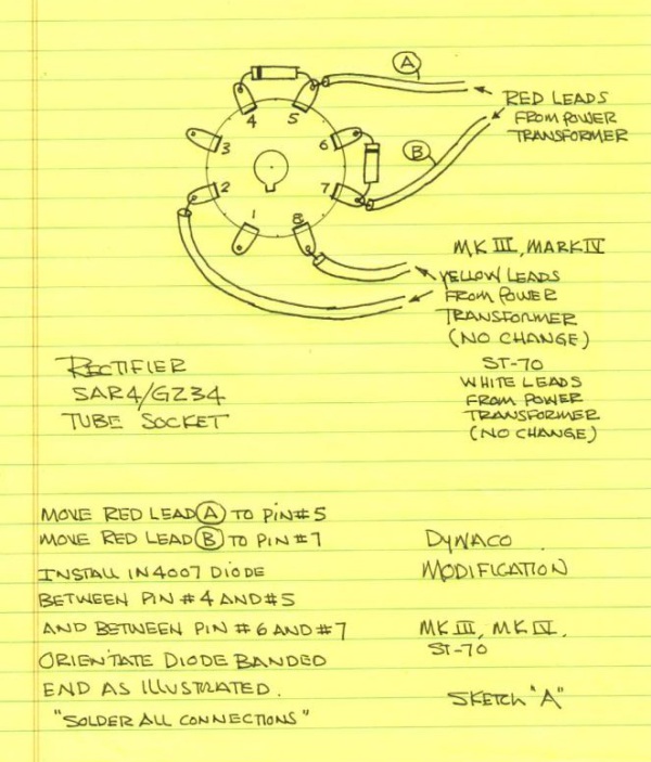

......According to the mullard spec, this should be 410Vac going in. I'm seeing 406Vac. Once rectified, I can't see how I can get higher than their book figures if I have a lower voltage going in.
I assume the SS diode mod used to prevent arc over in the 5AR4 wouldn't be able to cause the increased rectified voltages i'm seeing.
Your B+ is too high based on your Vac secondary voltage. You provided new info (new to me), the SS diodes in the rectification circuit. Now I guess is there is an error in the way the SS diodes are wired and you are getting the SS diodes to rectify, rather than the 5AR4, so you don’t have the expected voltage drop due to the tube rectification. Check that first. If that checks it would also be helpful to know the details of you choke as Alan asked, as well as the rest of your power supply components. Have you tried to simulate your PS using Duncan’s PSUD2 program?

I'm certain the diodes have been used correctly as I get no B+ with the rectifying valve removed. When the valve is fitted, B+ slowly rises as the valve heats up as expected. I followed this guide posted by Eli as a way of avoiding the likelihood of the sovtek 5AR4 arcing over. The only change I made was to move the cathode of the one diode from pin 5 to pin 3 as it suited my layout better.Your B+ is too high based on your Vac secondary voltage. You provided new info (new to me), the SS diodes in the rectification circuit. Now I guess is there is an error in the way the SS diodes are wired and you are getting the SS diodes to rectify, rather than the 5AR4, so you don’t have the expected voltage drop due to the tube rectification. Check that first. If that checks it would also be helpful to know the details of you choke as Alan asked, as well as the rest of your power supply components. Have you tried to simulate your PS using Duncan’s PSUD2 program?

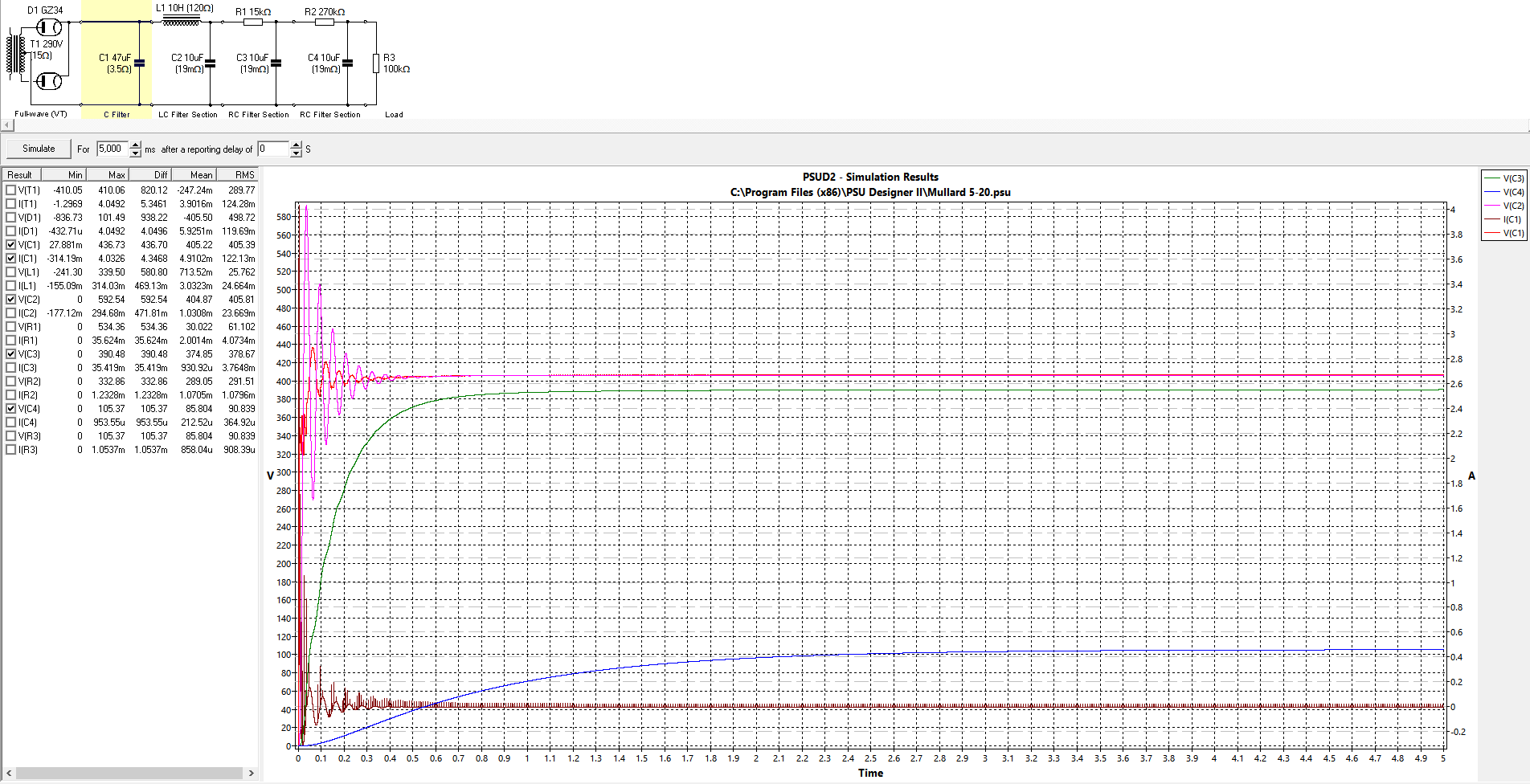

This was the PSUD simulation I performed in the planning phase.

A few things spring to mind.
First the AC voltage measurements are some times a little different using a digital meter vs an coil meter. And as you say the digital meter will show a slightly higher DC voltage from the AVO (likely 10M ohms vs 1000 ohms per volt.)
The voltages in post #9 round the choke do correspond to to the correct current draw, aprox 130mA with a 15 volt drop, so adding another 100 ohms would drop you nearly 28 volts in total and get close to 445 volts on C12?
You might also loose a volt or two if you put the 10uF cap in C15 position and the 47uF in C12. As audiowise suggests.
What you need to measure next is the voltage on the anodes of the EL34s and see what voltage drop the output transformer gives. It was about 10 volts in the Mullard specs. Then you can work out the dissipation of the output pair... As was mentioned before I think, the original design does run them at (or very slightly over) their design limit.
After all that you still might want to slightly increase the value of the 470 ohm cathode resistors (R20/21 or R17/18 depending on which diagram you use) to further improve their life expectation.

Alan, when you wrote “100 ohms would drop nearly 28 V”, did you mean both R23 & R24 at 100 in the schematic in post #6. If both are used it will give you ~28V reduction, and that will likely fix the overvoltage problem. I was wondering why Kei did not use them, or did you?
Kei, I also tried to understand your PSUD2 results, of which I’m no expert. Could you explain why it shows 290V at the transformer secondaries in the graphic, where I expected to see a value closer to the actual transformer secondary output voltage (adjusted for the load). Before changing values of C12 and C13 and adding R23 and R24 a new simulation would be good.
I did not use R23/R24 as the book suggests that the values depend on mains transformer. Since my HT voltages before the rectifier are already lower than their book values by 4V off load and 12V with load, they shouldn't be necessary.
My PSUD2 transformer voltage was set based on 410V x 0.707 = *289.87 to get RMS voltage. If I put 410V in for the transformer, the simulation is way off as i get voltages in excess of 570V.

I like to run output valves, in my designs, at 80% of their power rating. Your current operating point is above valve spec
Secondly you should look at the following site "30W Push Pull amplifier designed by Claus Byrith". It can be accessed from the Lundhal transformer site.
Claus uses the Mullard 5-20 as the base of his design but makes some nice changes including reducing feedback, operating the EF86 as a triode and reducing the standing current in the EL34's.
