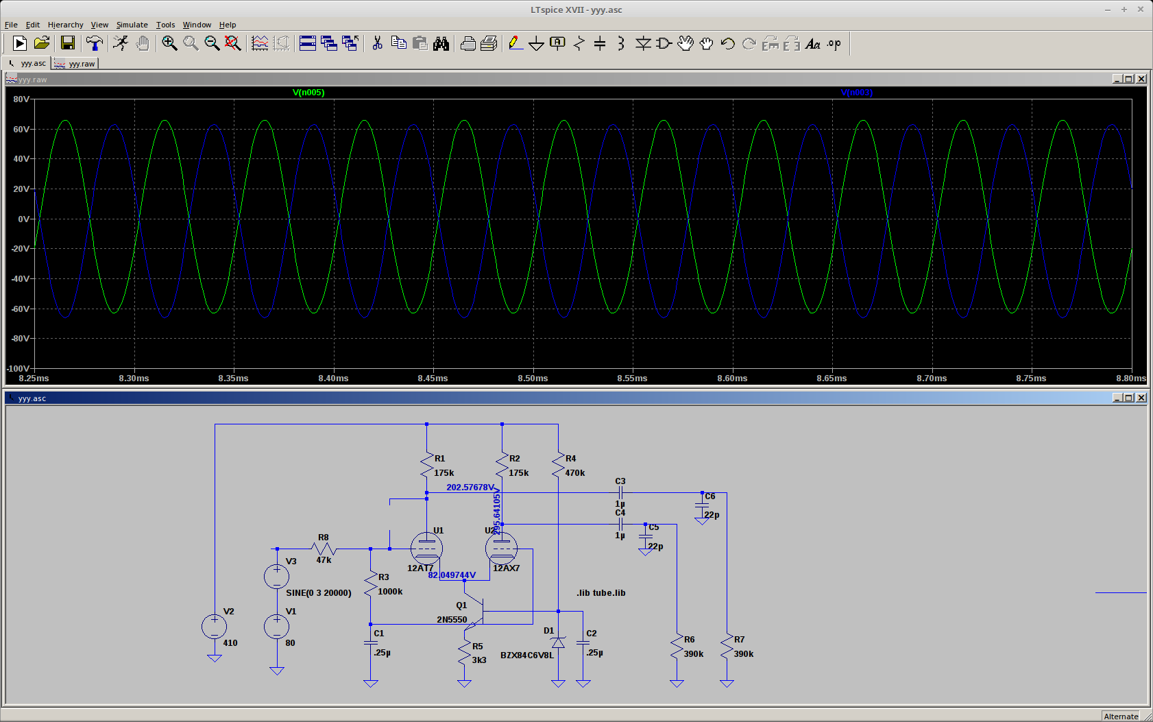

Actually there's not as much difference in simulation between the CCS and just a simple resistor! The high gain of the 12AX7 and the high voltage of 80V cathode to ground make for little change. The biggest problem with the circuit is that the plate voltage on the LTP is too high so that there is not enough positive drive to the EL34's. Dropping the resistor from 82K to 68K or 47K improves the drive a lot. 260v on the plates is much better.
for the CCS that would mean a 4K2 resistor
and for the non CCS 56K would be the closest value
Sorry, just broke the simulation... I agree the constant current sink does appear to improve the balance. I was trying to change the valve gain to see how it performed with a lower gain valve but then I broke it. It does only improve the balance and does not completely cure it and of course there will still be differences in the gain of each half of the double triode and it will not fix that either.
I had the same problem with the simulation breaking when making changes to test the circuit baudouin0 posted with the LED.

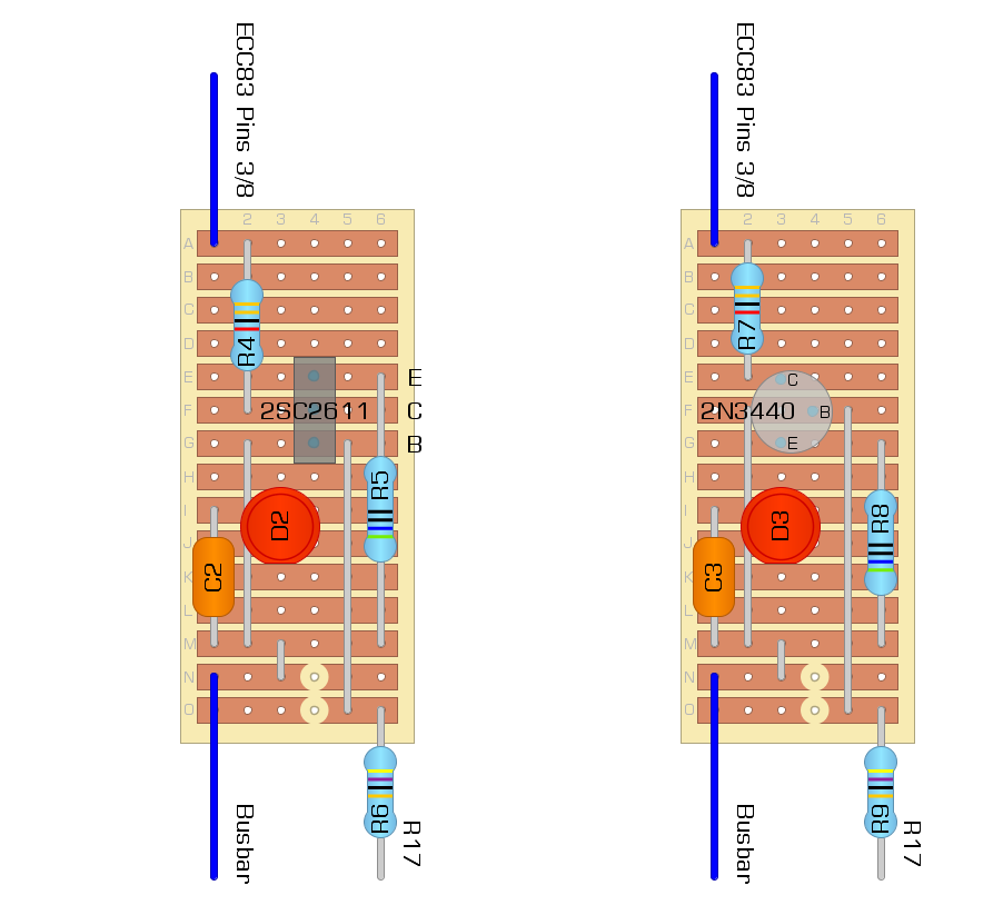

I've pulled my tin of semi conductors out of the loft and had a dig through. Ignoring the very large power transistors, these are what I've got that fit the 100V criteria.
2SC2611
2N3440
2SC2229
BF423 - Think hfe may be too low on these
I only had a single BD139 and a single 2N5192.

The 10M45S integrated circuit CCS is affordable and easy to configure. I'm guessing the cost will be approx. 2 UKP.
Remember, Mullard publicized the 5-20 to sell items they manufactured.
The minimum current of this easy to set up device is by the datasheet 2mA not 1.5-1mA which is what this requires
Running it out of spec can be A:tricky and B:noisy. And I would personally go with the transistor option myself just because quite simply it is simple enough and easy too

Running each section of the 12AX7/ECC83 at 1 mA. for a total of 2 mA. should be acceptable. Another possibility is 'X7 out and 'T7 in. Run the 'T7 triode at 3 mA.
1mA each triode is going to drag down the plates quite a bit more. Then the plate voltage will be 200V straight. Lowering the plate resistors would up the plates a bit but then again.....quite a bit of modiffications. Transistor CCS? easier to set up in this case and still keep relatively close to the original thing.
Redid the layout based on the spare bit of veroboard I have which saves me hacking up a full size piece. Since I already have all these components, it's certainly worth trying to see if it makes much if any difference.

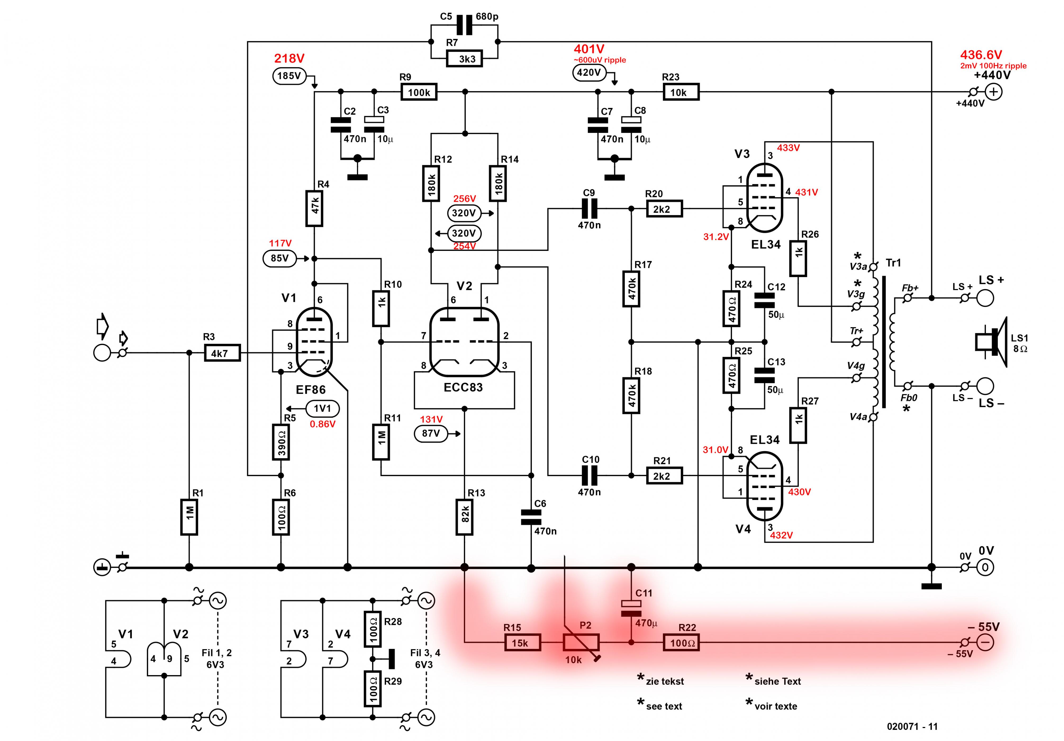

Currently, I'll stick the LTP CCS on the "to do once it works correctly" list. I'm chasing my tail with voltages not behaving correctly. I think this is the big reason why things are getting pretty ugly with larger signals and at higher frequencies. The waveforms out of V1 and V2 look horrid.
I've redrawn the elektor/clausB schematic as it is implemented in my case along with the voltages I'm getting marked in red. (book figures circled in black) I left the NGV supply in but highlighted in red to indicate it's missing as I'm not sure if it's absence may be playing a part in my V1/V2 anode/cathode voltage issues.

Yes your EF86 is taking less current then the schematic would suggest. However I prefer your bias voltages with the V1 plate higher and the V2 plate lower. Looks OK to me. R7 will influence the bias voltage slightly. Don't think your volatage will make that much difference to the horrid signals. I think if your expecting a perfect square wave on V2 you will be dissapointed.
Your ECC83 still looks to me like it's in cutoff, Vgk = 14v. You also posted recently that V2 grids were at different DC V, which was explained on another forum - Mullard 5-20 high DC Voltages - Page 5 - UK Vintage Radio Repair and Restoration Discussion Forum as being a consequence of your DMM Z and the EF86 running at very Ia. I think it's probable V2 is starved of current and hence imbalance, but the two anodes are near in value, starved LTP's usaully have a Va imbalance too.
Could you measure Vgk please, one probe on pin 7/2 the other on pin 8, the result as shown on the schematic should be within 2v of each other. Also suggested putting a 100r or bigger pot in the cathode of V1 and adjusting till V2 Vgk is within spec.

Oh yep that cannot be right with Vgk of 14v and yet a sensible plate voltage. You do have a 12AX7 fitted?

I will measure it again as you describe above. All previous measurements have been made relative to ground. I now also have a x100 scope probe with 100M input impedance which I can use on the higher impedance sections.
Yes definitely a 12AX7 fitted. The only other valves I have used are 5751's. I do have both an ECC81 and ECC82 but I've not tried either as they aren't drop in swaps.
