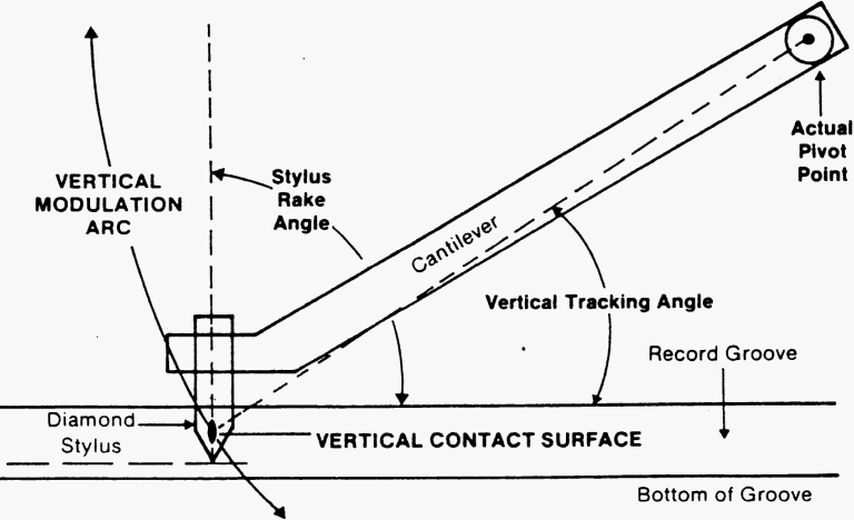

So there is no attempt to get the correct SRA as well? Technically every time you raise or lower the arm you should adjust the overhang, this is too much fussing for me BTW. So in the end a change in VTA by raising or lowering the arm has a corresponding change in HTA and without a two tone test the third degree of freedom comes out where it may by the tracking force and design of the cartridge?
Our idea of the spiral signal that smoothly goes from left only all the way to right only would probably yield all the same information as above.
You are right, Adjust+ talks about VTA adjustment, but to call it SRA adjustment would be correct, because effectively that is what happens.
Changing the tracking force has hardly any effect on VTA but a lot on SRA and is immediately noticeable with Adjust+.
I don't see the reasoning on this, a cartridge/motor assembly that is perfectly tangent to the groove at some point has no relative angle change to the two groove walls with rotation in the SRA angle with the stylus tip stationary. We need to be careful, I think these geometric arguments make assumptions about the stylus cantilever and motor assembly being in perfect alignment.
EDIT - your comment confuses me, VTA and SRA both are related to the cantilever pivot point and change together.
Just a sanity check are these angles what we are talking about? Changing tracking force moves the pivot point down changing both VTA and SRA unless I'm really missing something.
I’m using a different defintion for VTA, being the angle from tip to arm pivot, but I may be completely wrong. But with that definition adding tracking weight hardly alters the VTA but much to the SRA. In your definition they are complementary to each other.
However, VTA and SRA are rather controversial as this article shows.
Exposing the VTA myth? [English]

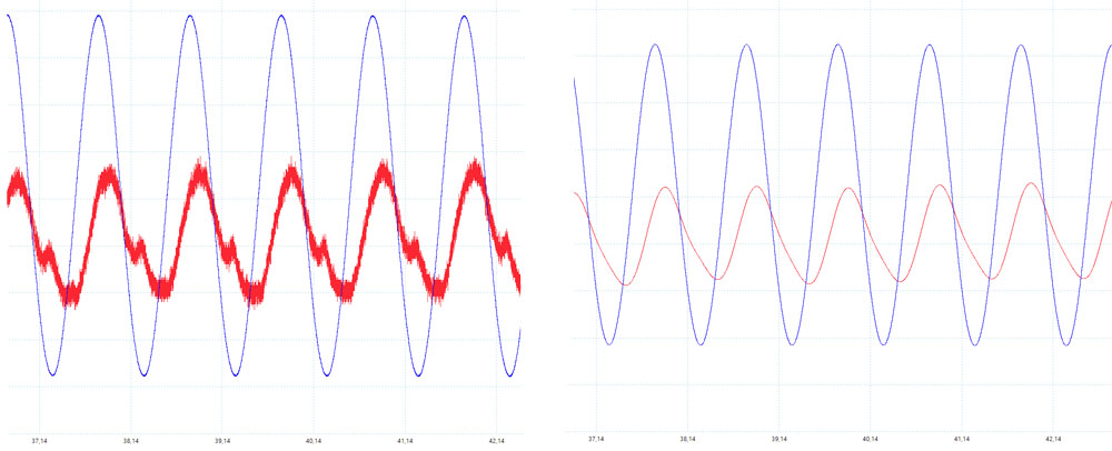

I have to come back on earlier conclusions regarding Adjust+
When measuring with my scope, I noticed that the crosstalk products carried quite some noise. My scope has the feature to filter the 1Khz signals, main and crosstalk, into neat sinewaves, see image below.
Doing that gave me the before mentioned angles of resp. 45 and 135 degrees for crosstalk L-R and R-L, which made me puzzling why these angles ?
Therefore performing the test again but now with the Adjust+ software, gave me two times almost 90 degrees, probably meaning that this piece of SW does not filter the signal and is measuring the phase angle in a rather messy signal.
Now to conclude: Adjust+ only measures the phase angles of the crosstalk products to the other channels main signals.
When varying the HTA, this phase angle will change.
At the point where this phase angle is identical for L and R, you have found the correct HTA.
By varying now the VTA, the phase angles for both Crosstalk signals should change in the same way and be tuned to 90 degrees.
Ninety degrees phase shift for both channels is a figure that makes sense, but 45 and 135 degrees seemed illogical.
Obviously a scope with filter feature is more accurate for adjusting the HTA and VTA than is possible with Adjust+.
On the other hand, the difference in final adjustment between the two methods is so small, that in practice it will not make any audible difference.
That leads me to the important question, why building a complex piece of SW to emulate the RCA patent when a simple series of measurements as performed by Adjust+ suffices ?
Hans
P.S. The crosstalk signal in the image below has been magnified 20x.

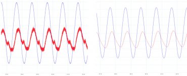

Hans
