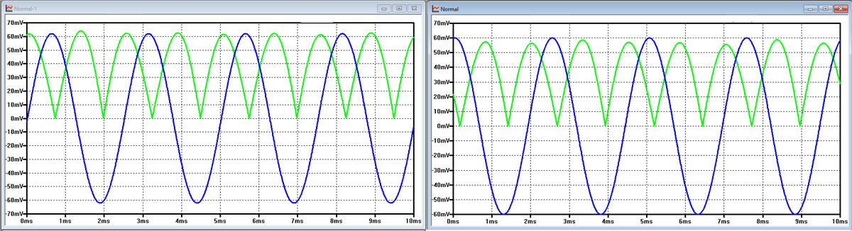

With Scott's Low and High.Wav file, I performed the actions as in the RCA Patent.
The Image below shows in green the modulation of the 4KHz signal.
The difference is rather disappointing, something like 8% between the low and the high setting.
Rather surprising was the fact that the high setting has the lower IM of the two.
The blue signal in the image is the 400Hz in the input signal, just as a reference.
Hans

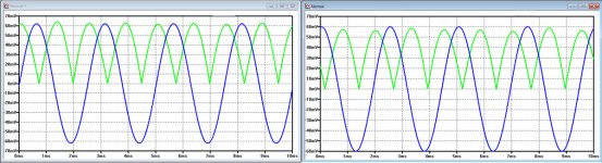

Hans
For completeness, the Normal setting was 3% below the high setting.
So this seems to be the best position, but differences are frustratingly small.
Hans
Hans

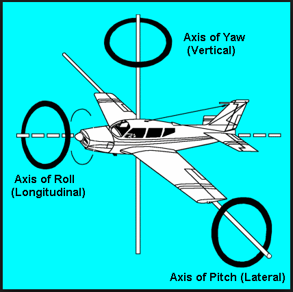

BTW - I wish everyone would stick to pitch, roll, yaw, x, y, z. 🙂
I always have trouble with this, may be it's due to my time spent working on radar........... and aircraft/racing cars!

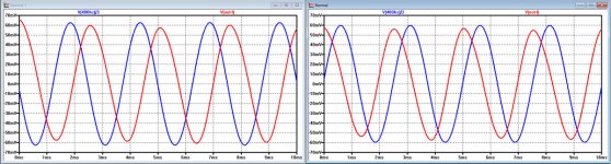

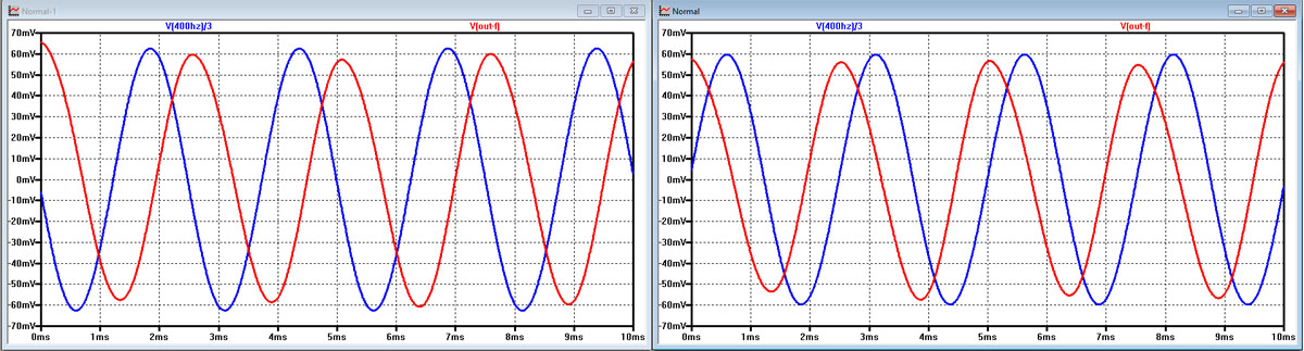

A few more images from Scott's Normal.Wav recording.
The left image is showing for the Left and Right channel the incoming 400Hz from the LP plus the demodulated 400Hz IM product from the 4KHz before being chopped into positive halves as in the RCA patent.
The 400Hz in blue is out of phase between L and R, confirming vertical modulation of the mono signal, but the IM products in red are in perfectly in phase.

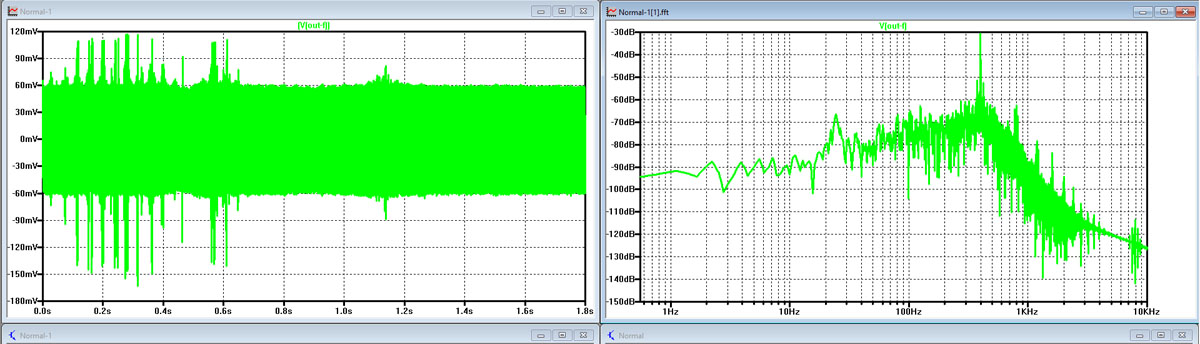

The image to the right is showing again the same demodulated IM signal from the 4KHz, but now for a whole revolution of the LP.
The glitches that are visable, are only there for part of the track and mostly 40msec apart at closer inspection.
Next to the time signal, a 25Hz peak is clearly visible in its spectrum.
Scott, this was the 25Hz that you also noticed, but because these glitches are only there for some part of the track, it doesn't seem to me to be a rumble product coming from your TT.
Could it be that the cutting machine produced this artefact ?
Hans
Hans

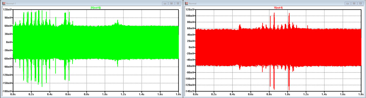

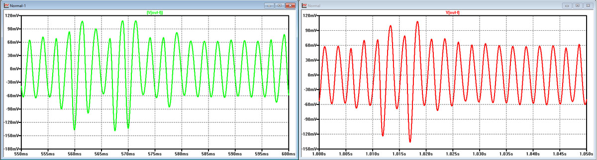

Here another image showing the demodulated 400Hz signal from the 4Khz, but now for both channels and again for one full LP revolution.
The glitches in this demodulated signal are not at identical moments for L and R, indicating again in the direction of the cutting machine ?
Hans
Hans
I have no idea where the 25Hz comes from. I have to apologize for my misunderstanding of the crosstalk test. The left - right - stereo sequence is for shall we say roll and yaw. The RCA test is supposed to be for pitch, I think. I also think the roll and yaw need to be very good before doing the other test or there is too much contaminating information.
