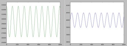

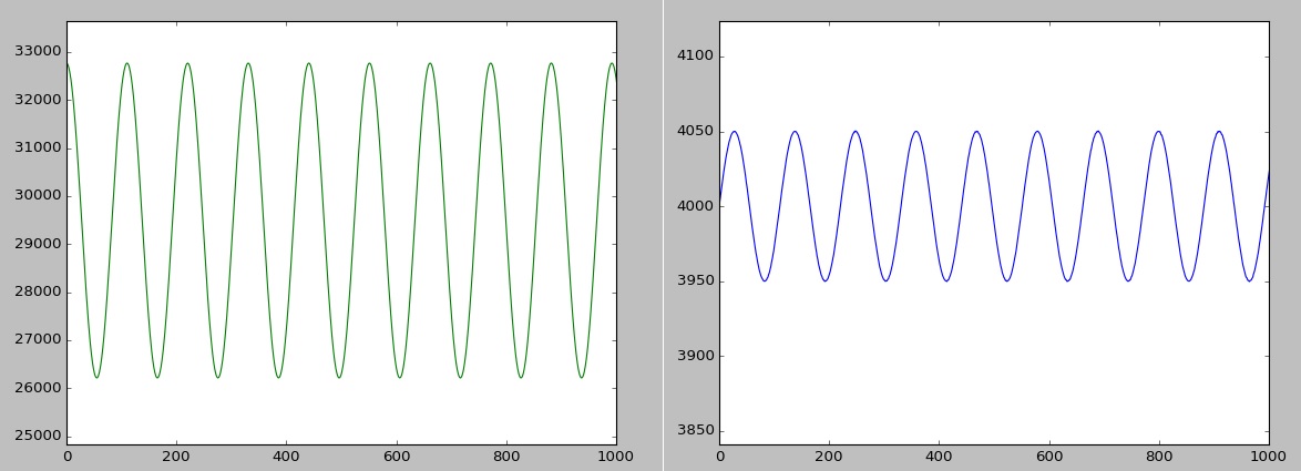

The strange "glitches" with a strong 25Hz content in the FM demodulated 4KHz signal, being there in the first revolution of the vertically modulated test track (see posting #379), are absent in the next 16 revolutions.
If this 25Hz was to be caused by the fres of the arm/cart combo, it would have appeared all over the place, but it doesn't.
And said 25Hz it is not AM but FM modulation of the 400Hz. This FM modulated 400Hz signal successively modulates the 4KHz signal. A nested double FM modulation so to say, that must have been generated by the cutting machine.
For measuring purposes, the first revolution should therefore be skipped.
Hans
Hans

Consider such a test track at 33.333rpm spindle radius 10cm, 400Hz/4kHz at +6dB ref 5cm/s. With an arbitrary lateral tracking angle error of 1 degree.
From Baerwald (1941), harmonic distortion ratio (virtually all 2nd) ε for a sine wave modulation, is given by
ε = vo tan(η)/rΩ
where
vo is modulation velocity
rΩ is linear rotational velocity
η is tracking angle error
For small tracking angle errors, as is the case here, that approximates to
ε = ηvo/rΩ
For the arbitrary +6dB test track conditions, as above, ε conveniently works out at 0.5%, almost entirely 2nd, harmonic distortion.
So far so good. Now we need to work out how much FM of our 4kHz tone to expect, by looking at the effect of 0.5% 2nd harmonic distortion at 400Hz on linear velocity error.
By superposition, the peak effect on linear velocity of 400Hz tone at +6dB is approximately εvo =0.005*0.1 m/s = 0.0005 m/s
As a fraction of rotational linear speed at this is 0.0005/0.35 = 0.14%
Therefore FM modulation of the 4kHz tone should be expected to be about 0.14%, if it arises from geometric causes, for a tracking angle error of 1%. This is pretty small, and though my SW can see it, I'm struggling to pick it cleanly out of the noise at a bandwidth of 400Hz so as to measure it.
The reason far higher levels of observed distortion/FM modulation sometimes reported, I figure, is probably due to another far bigger contribution, arising from mistracing due to stylus-groove friction. Or imperfect stylus geometry (ie not perfect shape). This, I believe, is what we are really seeing and testing here, and is very worthwhile.
This is why I consider the lateral 400Hz/4kHz test track very important, despite analysis of geometry showing theoretically otherwise. It's very probably an excellent indirect test of stylus-groove alignment in 3D
LD
