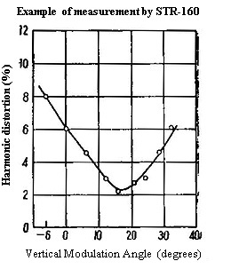

This is what I see a 1 degree change makes very little difference. BTW this STR160 LP was never offered by Old Colony and is probably virtual unobtainium. Each track had a different angle on the cutter. Ask them Pano. 😀
To quote Yosh's site "Its [VTA error induced] distortion is usually inaudible at the lower recorded level than 5cm/s and angle difference less than 10 degrees"
The STR160 graph doesn't disclose the recorded level, but to obtain such gross harmonic distortion figures requires an extreme test level. At such levels, there's typically as much chance of mistracking as mistracing - see the original patent upon which the SW idea is based. Chances are the measurement is for mistracking performance, ref my comments as to SRA induced probable causes.

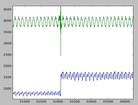

But there is both AM and FM at the same frequency here so the results are difficult to interpret. I also suspect the background tracing distortion here contaminates any useful information. What I did earlier was to use AM and FM synthetic signals at different frequencies (actually the AM was gross steps in amplitude change) to compare with LD's method. You really need to synthesize a signal to test the algorithm there are too many confounders in real data.
EDIT - I just repeated that test on that file. The plots are frequency (4k) and amplitude in LSB's with a 6dB step in gain. There is only a transient that is not filtered out.
EDIT EDIT - I just noticed something that I missed before. Looking at the left - right - vertical tracks (1K) at the same amplitude the left/right (by eye) have far less distortion than the vertical. In fact the distortion is easily seen by eye alone. It measures at least 10dB worse 2.2% to 6-7%.
I did some research on setting VTA by equalizing the crosstalk and then looked at my data again. The left - right - vertical - lateral sequence from any number of test LP's yields the necessary data, this is well known and it's my problem for not being familiar with this. If you have a cartridge with very low crosstalk in one channel this technique can fail.
