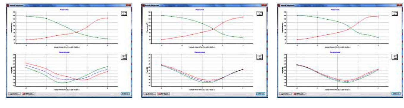

Looking at VTA from a different angle, I already mentioned the Dr Feickert test disc.
Below you first see three sets of images, where in each image the HTA was changes in steps of 0.5 degrees from -2 degrees to +2 degrees.
The top of the image shows the phase relation between L and R.
The bottom shows the crosstalk L - R and R - L.
The difference between the three image sets is the VTA setting.
In the left image set the Cart is tilting a bit backwards towards the arms pivot point.
The image in the middle has the arm raised by 3mm, or ca. only 0.8 VTA degrees upwards.
The image at the right has the arm raised by another 1mm or ca. 0.3 VTA degrees.
Now there are two things to watch: first is at what HTA do the two lines cross, answer is at +0.5 degrees, so this is the HTA setting to be used.
Second important point is that this crossing point should be at 90 degrees on the vertical axis. This crossing point lies resp. at 60, 80 and 90 degrees from the left to right image set.
So raising the arm only by 1mm, meaning a VTA adjustment of only 0.3 degrees makes a noticeable difference !

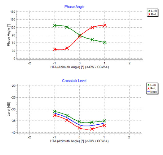

Next to these three images I have enclosed the results of adjusting my tone arm.
Obviously HTA has to be zero in my case and crossing is at 90 degrees so VTA is correct just after many attempts adjusting the height of the arm.
To conclude, I do not know what mechanism is behind this adjustment procedure, but it works perfectly and is very sensitive to the smallest adjustments.
