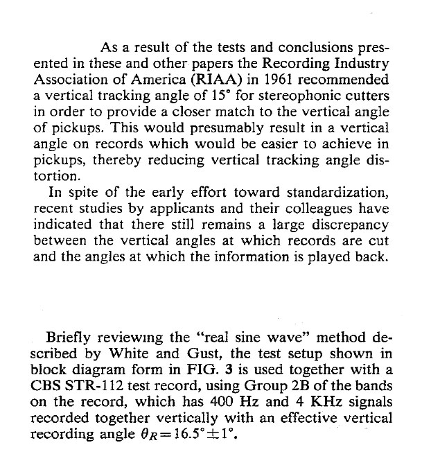

Image below shows what is written in the VTA patent application.

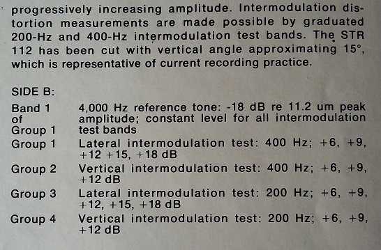

Riaa recommendation for VTA is 15 degrees, but large discrepancies do exist and according to this document the STR-112 is cut with 16.5 +/- 1 degree ??
Others say the STR-112 is cut with 15 degrees. So what will it be and what does 0.1 degree measuring accuracy mean in that case ?
I was only going by the insert that came with my copy (post #282). We can only do so much with these tests and maybe hoping that the phase and magnitude of the IM will yield a sweet spot is too much. In the end stylus geometry will probably enter into it and there will not be enough degrees of freedom for a pat answer.

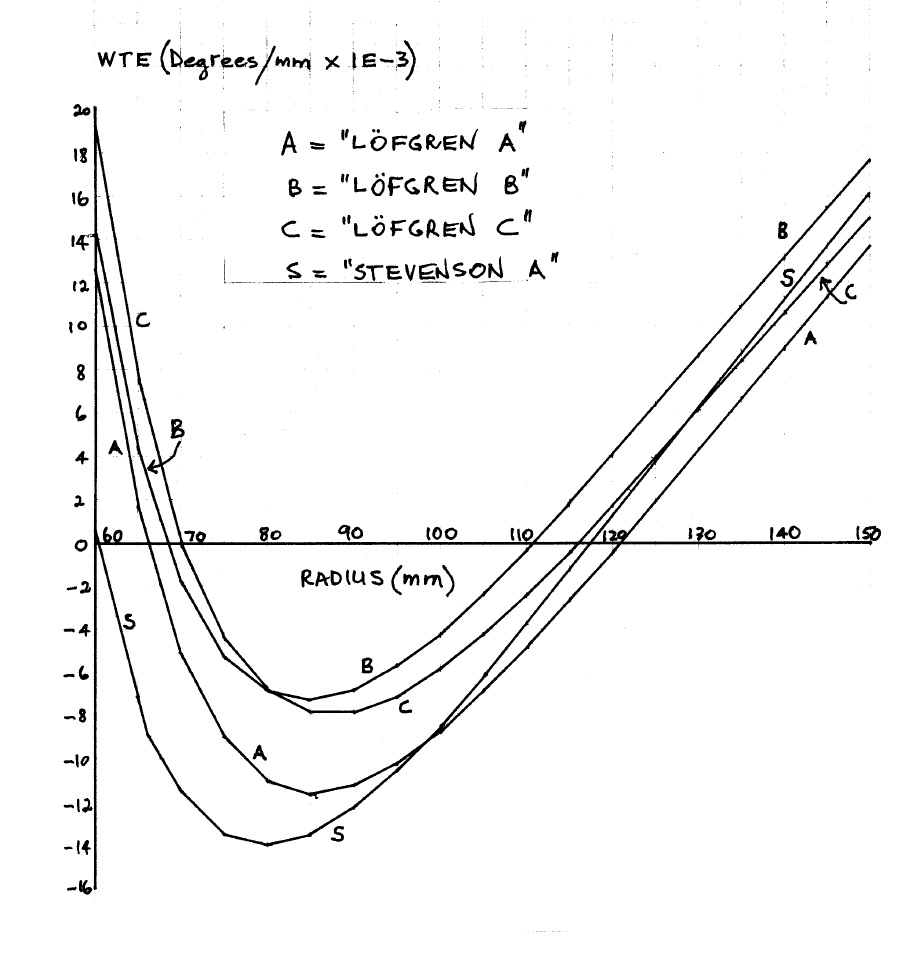

With the various protractors in use, I don't think there is a common null point. I guess you could average them out and choose a point close to the majority of alignment protractors. Sounds like work to me.The lateral test track would need to be at a common null point on the record.
-Chris
In trying to find the pretty graph showing the different alignments I found some chewy maths analysing them which might be of interest to some.
Tonearm Geometry Analysis by Graeme Dennes (c) 1983,2015 - Vinyl Engine
The diagram I was thinking of is page 25 of the linked Dennes paper (attached here )
