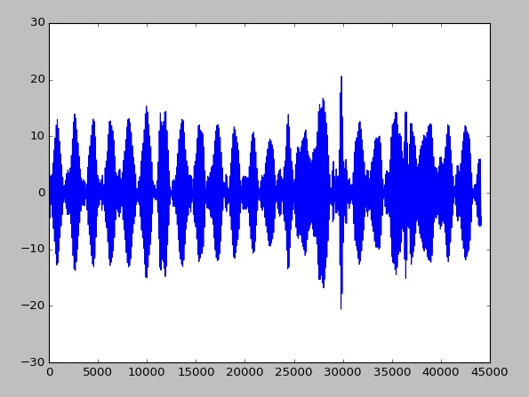

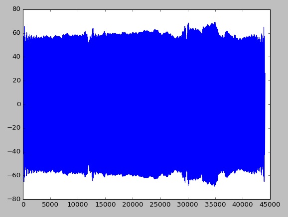

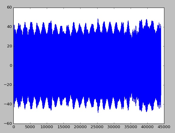

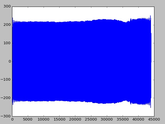

Contractors were here today so some of my data was corrupted by electrical and acoustic noise, but here is some very preliminary results from the 400/4000Hz IM tests. This is just the lateral and vertical tracks at +6dB on the 400Hz tone. As usual the surfaces on these 40yr. old LP's are not the best and the frequency and amplitude of the test tones are not usually perfect.
I extracted the 4K tone's AM and FM modulation using the Hilbert transform and then converted that back into a time waveform. As expected they are dominated by the 400Hz tone, but there is an unexpected component on the AM at around 25Hz. My off the cuff explanation is this. This frequency is very close to twice the arm/cart resonance, could there be an effect at work here that does not care about the sign of the angle change? That is the amplitude of the 4k tone goes down (?) if the tracing angle is plus or minus 1 degree from ideal or something like that. Lucky?
I also suppose the phase relationship between the 400Hz tone and the sidebands also has information. I think I can do that.
The scale here is referred to 3985 or so on the frequency and 750-800 codes on the amplitude, the plots being labeled LSB's in the vertical and no. of samples horizontal.
1 - Lateral +6dB FM
2 - Lateral +6dB AM
3 - Vertical +6dB FM
4 - Vertical +6dB AM
EDIT - Yes, on the +18db track the stylus leaves the groove surface but only has a few warp assisted jumps at +15dB

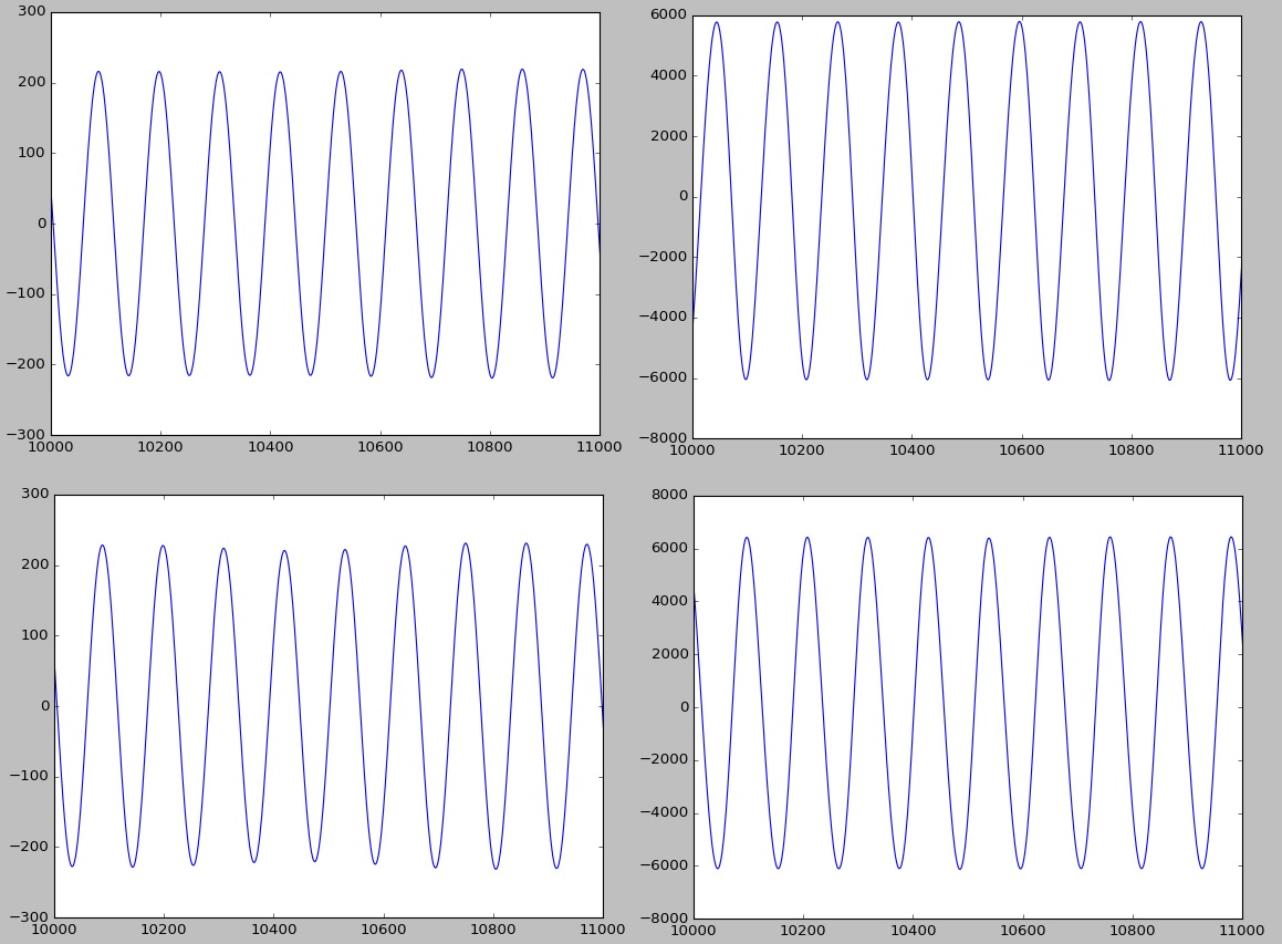

I finally read through the patent myself. There is a discrepancy because both 15 and 16.5 degrees are mentioned I must be missing a fine point. I also see that we want the component inphase with the 400Hz modulation and reject the quadrature component (tracing distortion). I figure that unless we have the means to real time tune VTA I don't see that more than a short clean set of cycles are needed to get the amplitude and phase relationships.
Another fine point is that the patent mentions equalization of the input but I don't know if this one of the RIAA equalized LP's (in any case the maths of this re: the FM/AM sidebands is making my head explode right now).
So here is another look at the data, vertical 6dB only but left and right channels. the plots are right channel on top with the 400Hz FM of the 4k on the left in Hz deviation and the 400Hz signal magnitude on the right in LSB's. The left and right are opposite phase as they should be and the FM component is in phase as I would expect.
I was thinking of stacking a trash LP under my mat and repeating this test, simple geometry should get the change of VTA (if it's too gross I could use some card stock). Isn't this enough data to see the groove alignment?

Sorry about that. The test track has a low level 4k tone mixed with a large 400Hz tone. The idea is that if the pickup perfectly traced the cutter's path there would be no FM on the 4k tone. The angle error causes alternately faster or slower motion relative to the groove wall at 400Hz (i.e. FM of the 4k tone at 400Hz).
A vertical groove cut is left-minus right so the channels are out of phase but the FM can't be because the two sides of the stylus can't have any relative motion (of note). All the data in the plots is at 400Hz, about 110 samples at 44100.

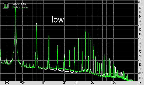

I surrender for now, I removed the pad (~.14") and then added 2 LP's under everything and the results are almost imperceptibly different for all three conditions. This is both on HD and the FM test.

See if this works, it's all three vertical IM bands for normal, raised, and lowered.

Unfortunately this LP has a warp across most of it in one spot, it's easy to see but does not mess up the data much. The AM on the first test of each has the mystery 25Hz ripple. There seems to be a similar slight magnitude change in the AM tests too.
EDIT - If I plot the AM spectra next to each other there is a visible trend toward raising the LP as an improvement.
Well I was just about to say that. 🙂 I find that HIGH has tighter peaks on the fundamental and all the harmonics than either LOW or NORMAL. That could well be the AM you are seeing.

Here are the 3 files compared in two different ways. There is an FFT that should animate thru High, Normal, Low and then a zoom in that shows the spread at 400Hz and at 4K.
That's a start. I'll look at them in some different ways to see if more info can be tweaked out.
