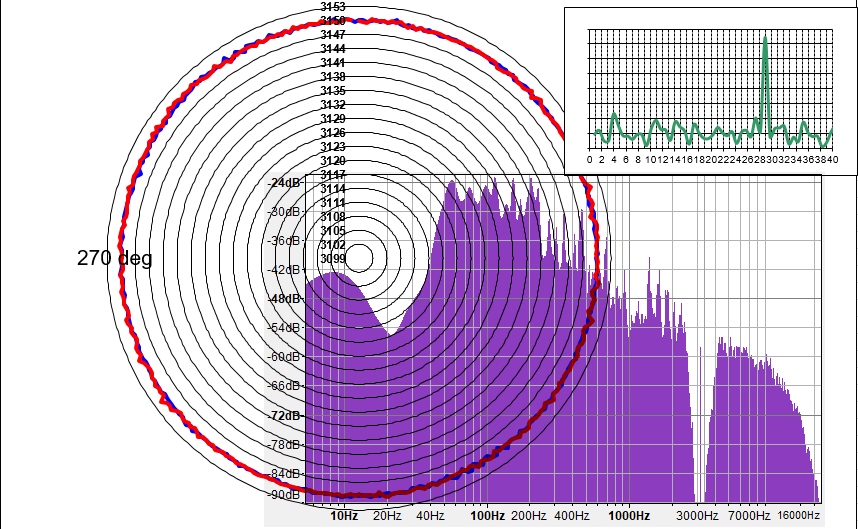

A fair question. The problem is that the newer ones don't even get in the same ball park as the classic B&K or CBS test records (the latest ortofon might), but also, with the processing power available to us now we can test things that were not possible in the 70s. Thanks mainly to Luckythedog who has spend most of the last decade questioning perceived wisdom there are things that we would like to measure that no available disks manage.
Some of this is fairly hard core vinyl optimisation though
Here's a simulation by way of illustration of programme material with an embedded 3150Hz carrier, and an associated polar plot of pitch stability.
The test file was extracted from a 3rd party vinyl recording as to be reasonably dynamic and well recorded. A deep narrow notch-out centred at 3150Hz was made by using eq filters in Audacity, and a 3150Hz mono tone mixed in at a level consistent with the average spectrum.
Attached is a polar plot which shows, as expected, a perfect circle from the synth 3150Hz tone, and small errors associated with programme material effect on measurement. Inset is the spectrum of the test file, averaged over the two revolutions - one can see the notch, and the 3150Hz carrier tone is matched for level with programme material.
If a test file like this were used for real playback, one would be able to observe the effect of dynamic variation in programme material on pitch stability, either associated with variation in drag or associated with cart/arm instability.
Included is the test file used, for the python boys to confirm it also works in that method, which it should methinks.
This isn't a candidate for a test-record file, BTW, just an illustration and test that the method works.
Interesting?
PS: Haven't a clue what the ~28Hz residual ripple spectral peak is............. perhaps an artefact of the digital eq used to create the test file?

Ah, the deep eq notch is made into programme material before the carrier is mixed with it. Thus the master track has the notch (and the carrier) throughout the test track.One thing, IME that notch is going to fill up big time with real LP play.
However, harmonic distortion from programme material can't be kept out of the notch during playback. This is why it's necessary to think through what amplitude the carrier should be, to ensure an adequately clear carrier no matter what programme material is.
One could simply opt for large carrier amplitude, but the aim is not to interfere with the effect of dynamic variation in programme material level on stylus drag, so keeping the carrier amplitude small as possible helps this.
Harmonic distortion can be simulated in the time domain as a separate track and mixed in, at least for the first couple of orders........I'll give it a go..............

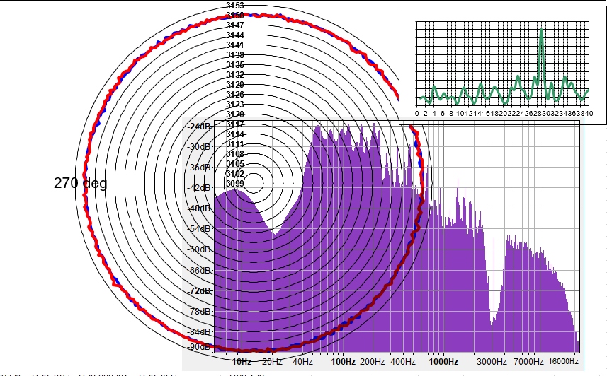

OK, here's that simulation, same levels and this time including simulated effects of harmonic distortion.One thing, IME that notch is going to fill up big time with real LP play.
2nd harmonic added at -20dB, 3rd harmonic at -30dB. Based on time domain generation of harmonics generated from programme material and mixed into the original track. One can see the notch filling up, as you say.
However, from the attached polar plot, one can see the resulting error is barely affected, and still looks fine, which is good news.
Also attached is the audio file - would be interesting to confirm that the python SW also works at this S/N? I think the simulation's more realistic now, and bodes well for a workable test at quite modest carrier level.
LD
LD
By eye that looks OK, but I'll need to check it in Python. BTW I would really appreciate your read on that CBS Labs patent. From a quick look the post processing is trivial in software and having correct VTA as a simple computation from a test track would be nice. The patent has expired so we can do whatever works.
That 28Hz is bothersome, maybe I can find the source from your files.
