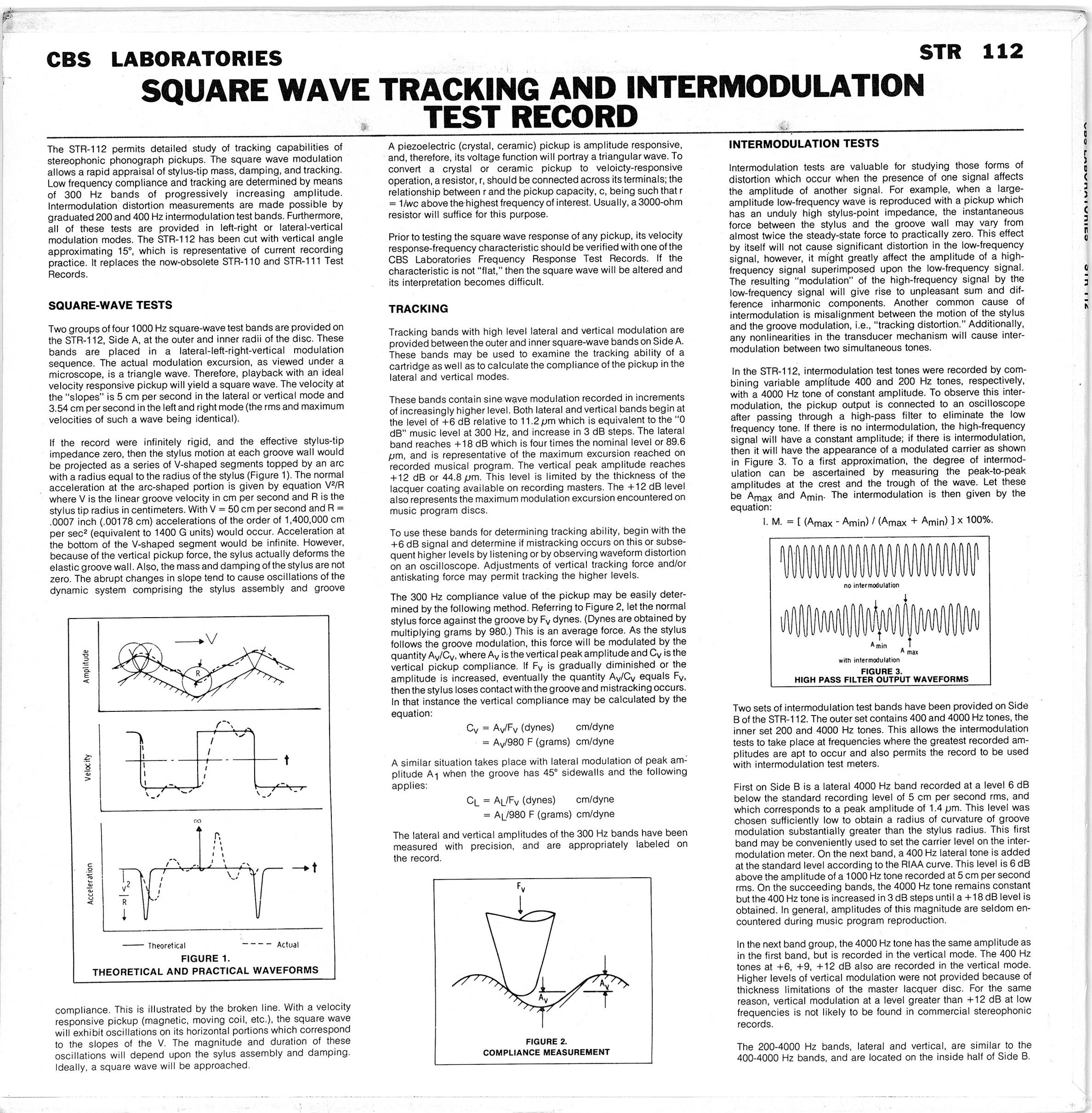

CBS test record has square wave, too.
Triangular shaped grooves, involving progressively increasing angles from 5 thru 50 deg, are part of what is needed for a proper trackability test.
As Scott says, in the absence of RIAA playback, these nominally would be programme material square waves of progressively increasing amplitude. Well almost, they'd have flat tops and bottoms.....but the rise time/slew rate would be set by the curvature at the top/bottom of the triangular grooveshape. Arranging for it to not exceed 500G acceleration should make that test trackable.
This curvature/acceleration is another key trackability test. One could keep the triangular-wave groove angle constant at say 20 deg, and vary the curvature/acceleration at top/bottom in steps of 100G or so from 100G to 2000G........
To synthesise these files, one would simply need to generate square wave programme material of variable amplitude (angle) and slew rate (curvature). Probably at a repetition rate slow enough to allow a decent time to inspect cartridge output waveshape.
Lastly, one could test for 'jolt' by creating a 2nd order slew rate curve for the synthesised square wave. The limit at which acceleration change is tolerated.
These, IMO, are some of the proper crux of trackability tests that haven't been done before AFAIK, and would be revealing about performance aspects of cartridges/setups and rigs that really matter to playback.
LD
