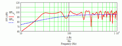

Not quite sure if you want just a BIB, a BIB sub similar to what's referenced or the TC driver in it, so here's a BIB (driver at standard offset) that's the same folded height, but requires a larger width/depth:
L = 190.5"
zdriver = 41.375"
Sm = ~334.41"^2 (recommend ~15.375" W x 21.75" D)
a-b-c = 10.875"
GM

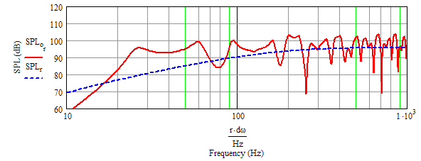

Bib sub, cool.... How about using a good paper cone high efficient driver or pro sound driver instead though? Dave🙂
Here's one for a BIB sub.. Madisound has it on sale right now for $163.00 Fostex FW305 12''
Hybrid Pulp cone
8ohm
95 db sens 1w/1m
Freq resp 25hz-3.5khz
Fs 25hz
Qms 2.73
Qes 0.28
Qts 0.25
Vas 254 ltrs
Xmax 4.8 mm peak
nom power 125w
I wonder how this Fostex would model for a BIB sub?
Dave🙂

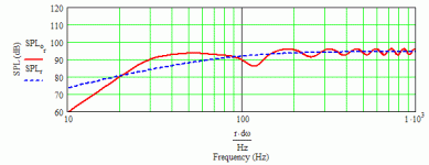

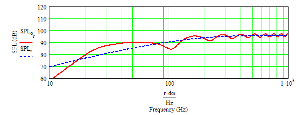

DaveCan said:Bib sub, cool.... How about using a good paper cone high efficient driver or pro sound driver instead though?
Here's one for a BIB sub.. Fostex FW305 12''
FWIW, Prosound drivers was all that was available back when I got serious about speaker building if low tunings was desired and they're still my preference for high SQ.........
Anyway, with a high Vas and 16 Hz Fp this one is almost 32 ft^3 using the formulas I posted, though it would make a 'killer' HT stage and/or speaker/equipment rack stand. Otherwise, either a higher Fp or reduced broadband acoustic efficiency is probably the way to go. Reducing it to an 84" folded line (20 Hz Fp) to fit in a corner and 'shrinking' its Vas to 6 ft^3 to get Vb down to ~21.2 ft^3:
L = 168"
zdriver = 36.437"
Sm = ~436.72"^2 (recommend ~17.562" W x 24.875" D)
a-b-c = 12.437"
