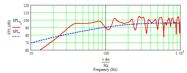

tobebu02 said:
Can i make it a little bit bigger:
H 90"
D 16"
W 11"
a-b-c 8"
Greets!
While my preference is to use the posted formula's SQRT(2) ratio, or ~15.56" deep for 11" wide, the original BIB has a higher aspect ratio and performs well, so this is fine and increasing a horn's Vb is rarely a problem. Indeed if you 'did the math', then you know the formula calcs ~191.03"^2, so your 176"^2 will work fine and if you're going to drive it with a high output impedance, then it should be even larger IMO.
That said, I hadn't noticed before, but with a single fold the driver is going to be ~55" off the floor, well above the optimum seated height range for a FR driver, so you might want to consider the stock length pipe, which of course doesn't go as low before rolling off.
GM

Huh?! Do you mean you're going to keep the 90" height, but drop the driver down to suit? If you do, there will be a big suck-out in the mid-bass that I don't believe the room can overcome. Unfortunately, only one way to know for sure.
Cabinet for AN Super8
As you can see, I'm still in the dark here. How can I reduce the height, what factors should I look for? Has anyone ever built your BIB cabinet with this driver? please advise. I'm still new at this and still have a lot to learn.
Thank you

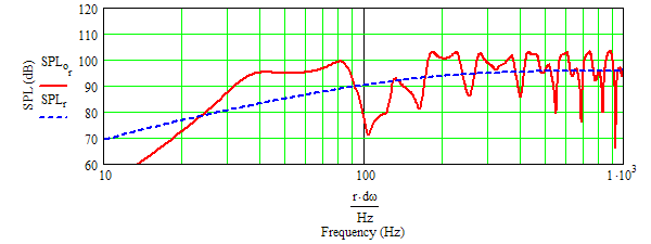

Greets!
You're welcome!
Understood, many who come to this thread are, but I respond with the assumption that some attempt has been made to get 'up to speed' on BIBs, especially after they've been directed to the official BIB site where the basic design is explained as well as a link to TC's original that I referred WRT the 'stock' length pipe: http://melhuish.org/audio/DIYTQ8.html
Anyway, as Scott noted, these simple pipe horns are pretty tolerant as vented speaker designs go, but there's limits and driver placement is more critical with these than a basic bass reflex.
AFAIK, Scott did the Super 8 design shown on Godzilla's site and I don't recall whether anyone has actually built it. What I do know is that once 'Sm' is calc'd, the line length 'L' only determines how low it will play, so you can use your width, depth, a-b-c dims with the original's 69" internal height and driver down 30". This is the sim I posted.
Obviously, this puts the driver higher than you're planning, but FWIW a number of us have found that positioning the main driver above our ear level a bit sounds better than at or below it. Again though, pushing the driver down to 30" even with this shorter pipe yields too big a hole in the response for the room to mask IMO:

tobebu02 said:
You are right. I'll have the driver at seated height level at 30" to 36" from the floor.
Thank you
I've played with driver height a bit and I find that putting the driver around 45" expands the sound stage vertically, but leaves it centered at eye level. I don't do this with my commercial designs because this makes the cabinet too tall to pass the WAF test. But since you are committed to a very tall cabinet anyway, moving the driver up to 45" gets it closer to optimum and will give better presentation to boot.
