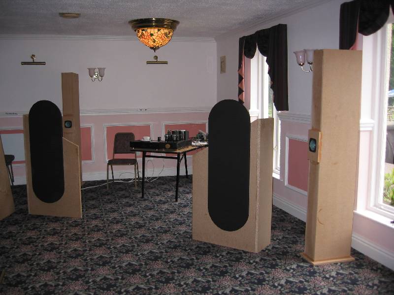

Don't try this at home boys and any improbable girls reading this... 1 pair of P10 modified FE126Es in a pair of cabinets intended for Monacors, hense the very roughly screwed on & sealed false baffle. Despite being as sub-optimal as it gets, with the benefit of one of the 2 finest amps I've ever heard feeding them, and on the aforementioned album, these were the boxes that got an award. They went much louder with this music, with far less effort than on other tracks, and even the cone excursion dramatically reduced. Benefits of not needing to plumb the depths, with the high Vb providing additional help. If nothing else, it proves that it's hard to have too large a box (so long as your source material isn't too demanding in the LF regions). And that a good quality amp should not be ignored.
BTW, if anyone's wondering what the baffles are, those are my friend Steve's. Lowther EX4s on top, supported by Goodmans 301s below them, and the woofer vesion of the 301 below that. They filled a 90 x 40ft room with less than 1w.
