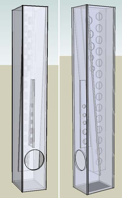

OK Dave,
The BIB SD12 is a little over the top!! I love it. It's too tall to fit into my room, but I'm imagining laying it on its side and making a entertainment console. Heck you could lay some Frugel horns on their sides on the top of it, and have a monster 50's console.
Chris
isn't this subwoofer nothing but a (very big) folded Voigt pipe ?
isn't the BiB nothing but a big folded Voigt pipe ?
But as a Voigt pipe is a Tapped Quarter Wave Pipe,
and a BiB is calculated using half the wave,
the BiB is a Tapped Half Wave Pipe ?
:smash: THWP :smash:
Neither are tapped. A tapped horn has the driver mounted through the internal baffle. In a sense you're right though: these are pipe-horns, and in most respects are far closer to P.G.A.H. Voigt's original patent than any of the so-called 'Voigt Pipes' ever were. Re the half wave, we have to be careful here not to confuse a half-wave resonator with 1/2 wave tuning.
A half-wave resonator is a pipe open at both ends. A 1/4 wave resonator is a pipe sealed at one end. Therefore, these pipe-horns are not half-wave resonators, but tapered 1/4 wave resonators that are 1/2 wavelength tuned, i.e 1/2 wavelength of the target Fc is used to set line length, as you observe.

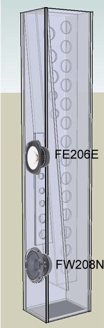

Greets!
Correct.
Yes.
Just as a Leopard can't change its spots, a TQWP can't change its fundamental resonance. A BIB alignment is just a 1/4 WL of Fs/2, though there's a number of low Fs driver designs posted that are tuned around Fs to keep its size and/or driver location semi-acceptable.
BTW, the BIB is a horn due to its positive expansion, a TQWP is the opposite, a reverse tapered horn.
GM
Greets!
I started to say this, but decided that the fact that DSL chooses to use the term 'tapped' to define its pipe horn loading technique doesn't change the fact that any TL, MLTL, horn, TQWP with the driver offset along its length is a tapped one.
GM
