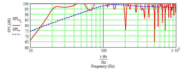

One neighbor of mine have heard my BIB's but he wants a two way. I had my eyes on this Monacor bass/mid for a while. Now the question is, if tuned to fs, will the dip move down also? I'm afraid it will have less "smack" in the bass drums then.
Next question, is it possible to have higher tuning than fs. If so what's the down side?
Just looking at the graph (know that's not all😉 but it's a start) it look real good up to 6kHz for a hard cone.
Greets!
The 3rd harmonic dip is primarily a function of Fp, so at 30 Hz, the dip would move up referenced to T.C.'s alignment.
You can tune it however you like with the understanding that it will begin to roll off at ~SQRT(2)*Fp/4th order (24 dB/octave) and that the effective Fp is a variable based on room/boundary loading, so hard to accurately predict.
FYI, that plot is probably so smoothed it's virtually worthless WRT how it sounds. A satellite view of earth looks pretty smooth too! That said, there's a lot to like about super rigid diaphragms because it allows lots of fine tuning options for folks who like the heart attack fast transients of compression horns, electrostats. Consider that the pioneers of speaker design chose phenolic and aluminum for horn drivers and phenol/creosol loaded paper compressed under high pressure/heat into as thin, rigid, damped a diaphragm as practical for point source drivers with up to a 12 kHz BW for a 300 - 800 Hz 2nd/order XO to minimize the differences between them for a near seamless tonal 'blend'.
Bottom line, unless Monacor did the fine tuning damping or you're willing to do it, you'll probably have to use a fairly low XO point and/or steep slope to keep listening fatigue low.
GM
GM,
Thanks for reply!
So the dip will roughly be around 90-100Hz?

😀 Joking aside, when compared with the other Monacor stiff cones, these looks much better. Some people in Germany rave about the sound from them, but as always???
