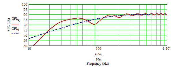

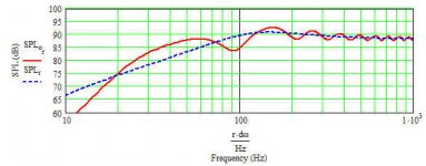

Greets!
Long n' skinny:
L = ~240.438"
Sm = ~51.842"^2 (recommend ~6.055" W x ~8.562" D)
zdriver = ~52.175"
A-B-C = ~4.281"
Dimensions are approximate, so you can round them up as required. For basic layout: http://www.zillaspeak.com/bib-howtobuild.asp The sim shows no stuffing, so they perform much better in-room than the sim indicates once damped to suit.
GM

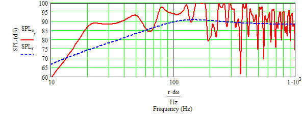

Godzilla said:
Also, will that sub design work with the TB 8" subwoofer?
Greets!
It wouldn't be my first choice:
GM

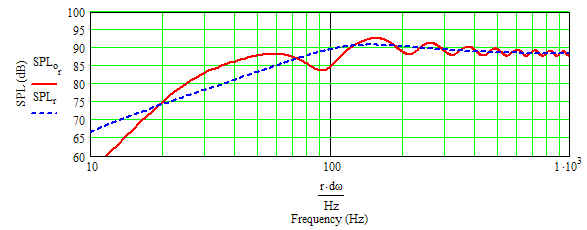

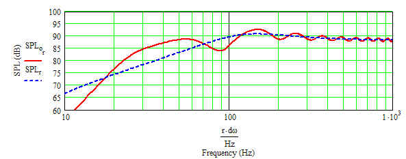

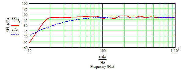

Greets!
Looks OK on paper:
GM
P.S. - the rest of the specs for simming:
Sd = 206.12 cm^2 (31.949"^2)
BL = 14.4875 N/A
thomaseliot said:
I have these two FW208N around (bought for another project gone bad) and wondering if they would work in your CSS SD12 Subduction.
Greets!
Looks OK on paper:
GM
BL = 14.4875 N/A
