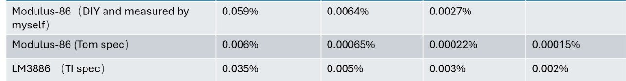

https://www.diyaudio.com/community/threads/a-new-ec-composite-lm3886-amp.419558/
A DIYer on the forum made real measurements of the famous chip amplifier and saw no improvement between the native data of the 3886 and the composite. Moreover, these are real measurements.. like mine..
I will soon take out my old modulus and measure it and present the results and comparisons to you.
Reactions: dimitri
You misunderstood my posts. Please read carefully.
That's because my Ferrite Solo setup has a very limited THD+N capability (0.002%). For example you used a unit with minimal 1% THD+N limit to measure an amp with 0.01%. What would you get?
I said in the posts
I could only measure its THD+N very roughly using Focusrite Solo 3rd, which has a minimal line-out and line-in THD+N of 0.002%.
It does not support your claim at all
"A DIYer on the forum made real measurements of the famous chip amplifier and saw no improvement between the native data of the 3886 and the composite. Moreover, these are real measurements.. like mine.."
