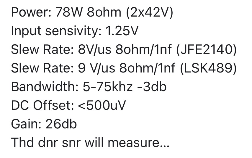

I only did the tests that I could do on a normal oscilloscope. I don't have a good sound card, so I ordered quantum asylum. All necessary performance measurements will be made and shared. The measurement data I can provide you right now are on the first page.

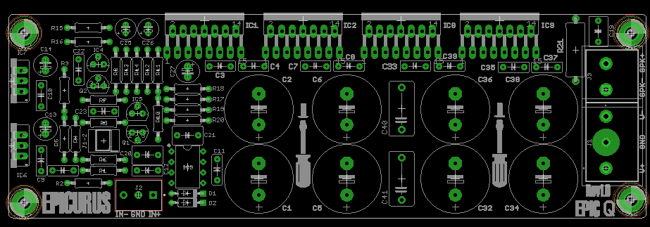

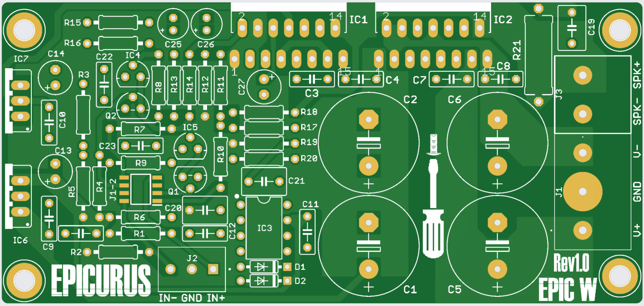

Parallel and single versions have technically and cosmetically high technical audio grade PCB drawings…

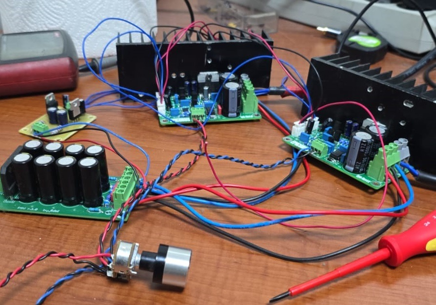

Recently, my dear friend Sercan sent me a pair of Jfet buffered TDA7293 boards. I thank him.
I spent a few days assembling the cards. To be honest, I admit that I'm having a bit of a hard time since I haven't made DIY audio for a long time.
I could not install the low-noise regulator modules in 78xx/79xx format that him sent with it. Therefore, I supplied the +-15v supply of the amplifier externally with a LM317-337 board.
My first impressions:
The amplifier has very low noise and low distortion. It is impossible to hear any distortion in full audio band.
The details are clear and airy. The basses are satisfactory, but it is difficult to predict if a basshead will stasfy or not from the basses..
The trebles and especially the mids are quite clean. The stage is incredibly wide. In this way, especially the works containing vocals are seriously satisfactory.
Unlike many high-quality DIY amplifiers, the details are not distracting and in this sense, it is musical enough to be listened to for long periods of time without falling asleep.
As someone who usually listens to Latin, vocal jazz and Mediterranean music, I admit that I was impressed with the amplifier.
I couldn't measure the dynamics of the amplifier because I didn't have enough equipment. However, based on my ears and my ~40 years of DIY audio experience, I am sure it has a reasonable THD and noise level.
That's all my short review & listening impressions for now.
