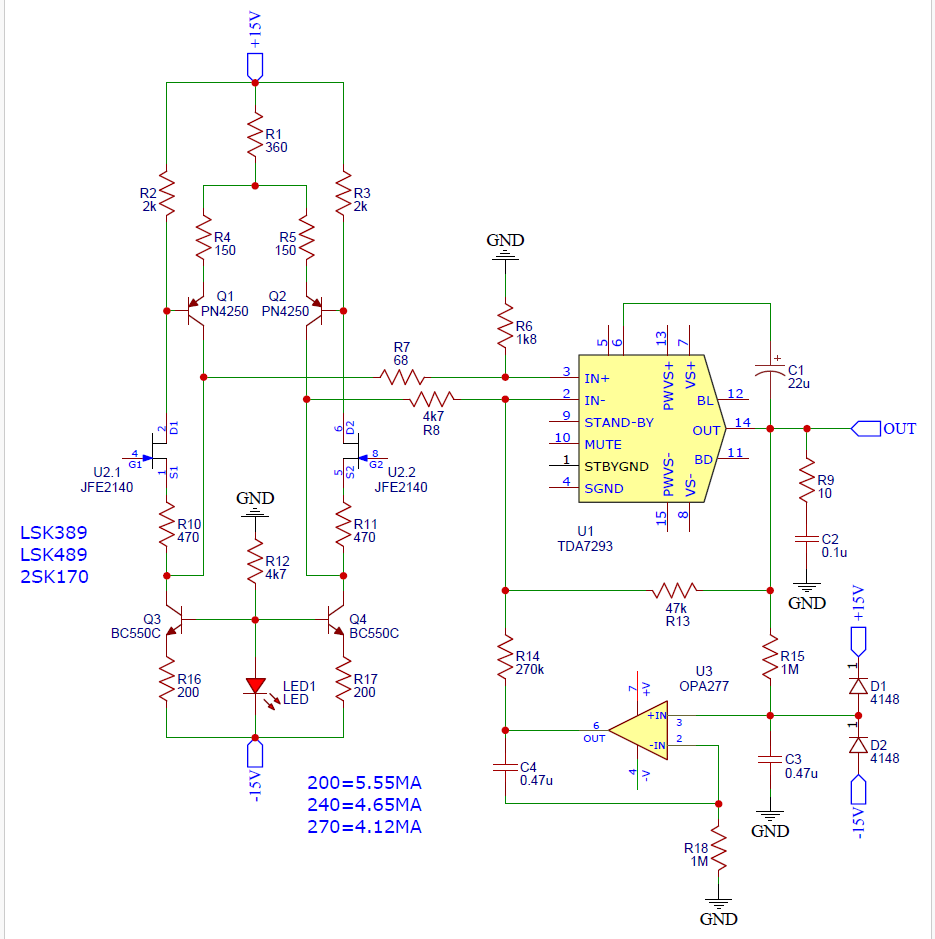

Again, I appreciate what you're doing and not trying to be negative, just sharing my thoughts.
Of course I don't know how the amp sounds BUT aren't THD, THD pattern, and noise widely accepted as an objective criteria reflecting the ability of an amp to correctly reproduce the input signal?
Introducing an input stage limits the output-input thermal coupling and reduces to some extent the distortion at low output power but as the open loop gain has not been increased the overall performance can't get much better.
The idea behind the composite amplifiers is to significantly increase the open loop gain and improve the performance at a given close loop gain proportionally to the open loop gain increase.
Take for example other composite amps using TDA7293 (https://www.kaltecs.com/tda7293-composite-amplifier/), where the open loop gain is increased by 40-50dB and the distortion is reduced by a similar degree.

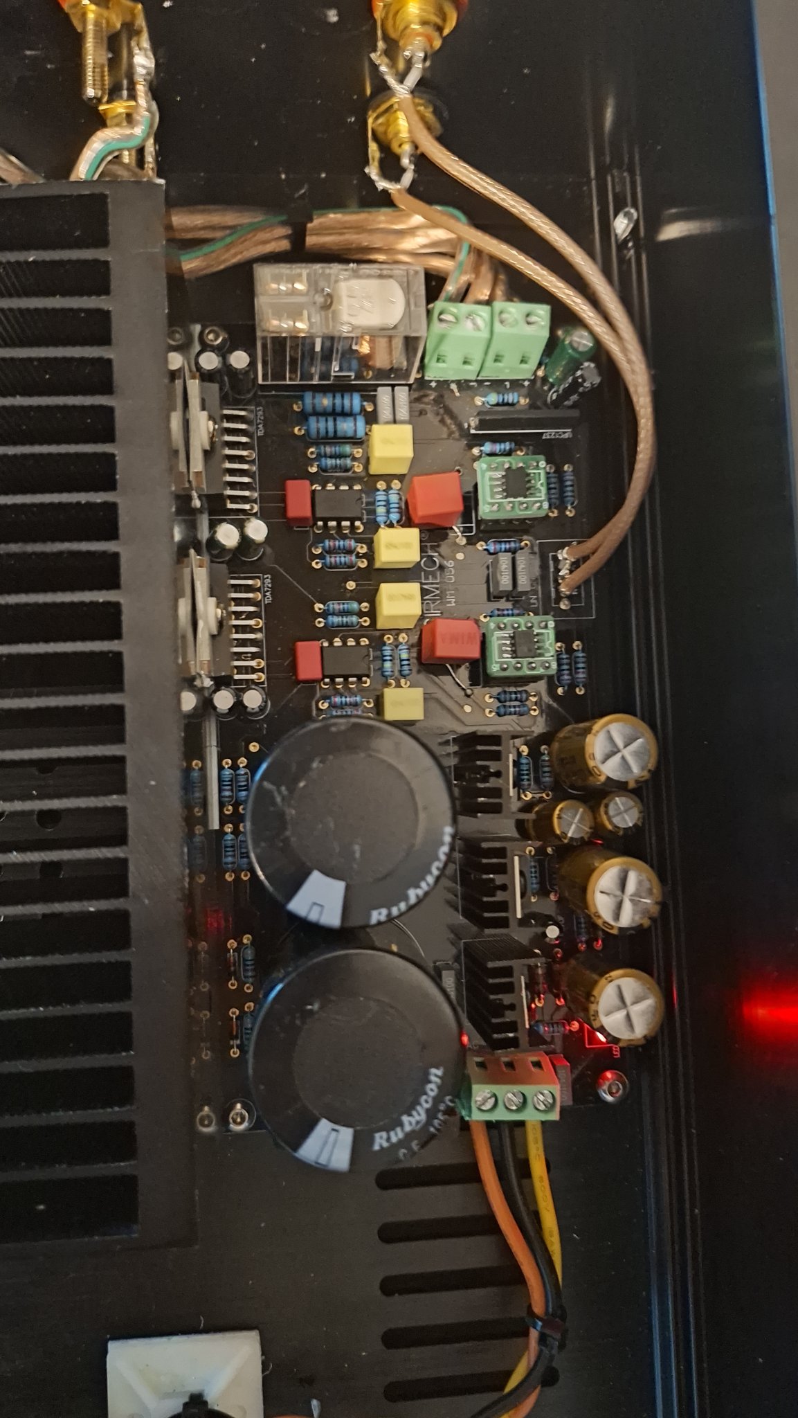

I must admit that we could not achieve the desired THD improvement in this project. So if you ask what we achieved with all this mess 🙂 ;
  • We proved that TDA7293 chip works stable at 20dB gain..
  • First of all, we provided a very high impedance input buffer. This allowed our amplifier to be easily connected to any source, potentiometer, preamp, etc. without any loss in performance.
  • Thanks to the high-performance JFETs we used at the input, we achieved a significant improvement in noise and therefore SNR (103dB @1W SNR and 18uV noise while inputs shorted are good figures in my opinion)
  • Also, if we look at the FFT graph, we will see that the 2nd harmonic is dominant. This proves that the sound is more tube-like. Because I also got a similar effect in my various listenings.
Conclusion; I am in favor of giving it a chance since it is a different application that does not have a very serious cost. Especially the fact that the design, which originally belonged to Bob Cordell, has not been tried before in this form may be attractive to some of us. (I must also say that it has a really beautiful sound.)

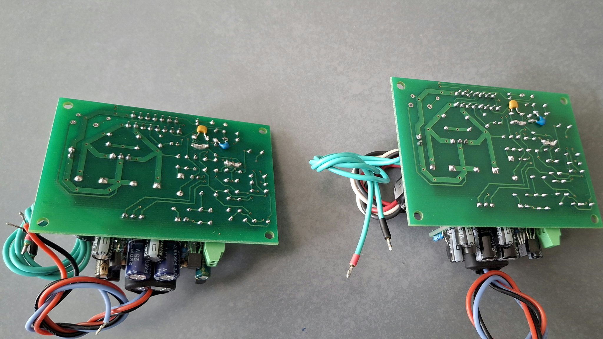

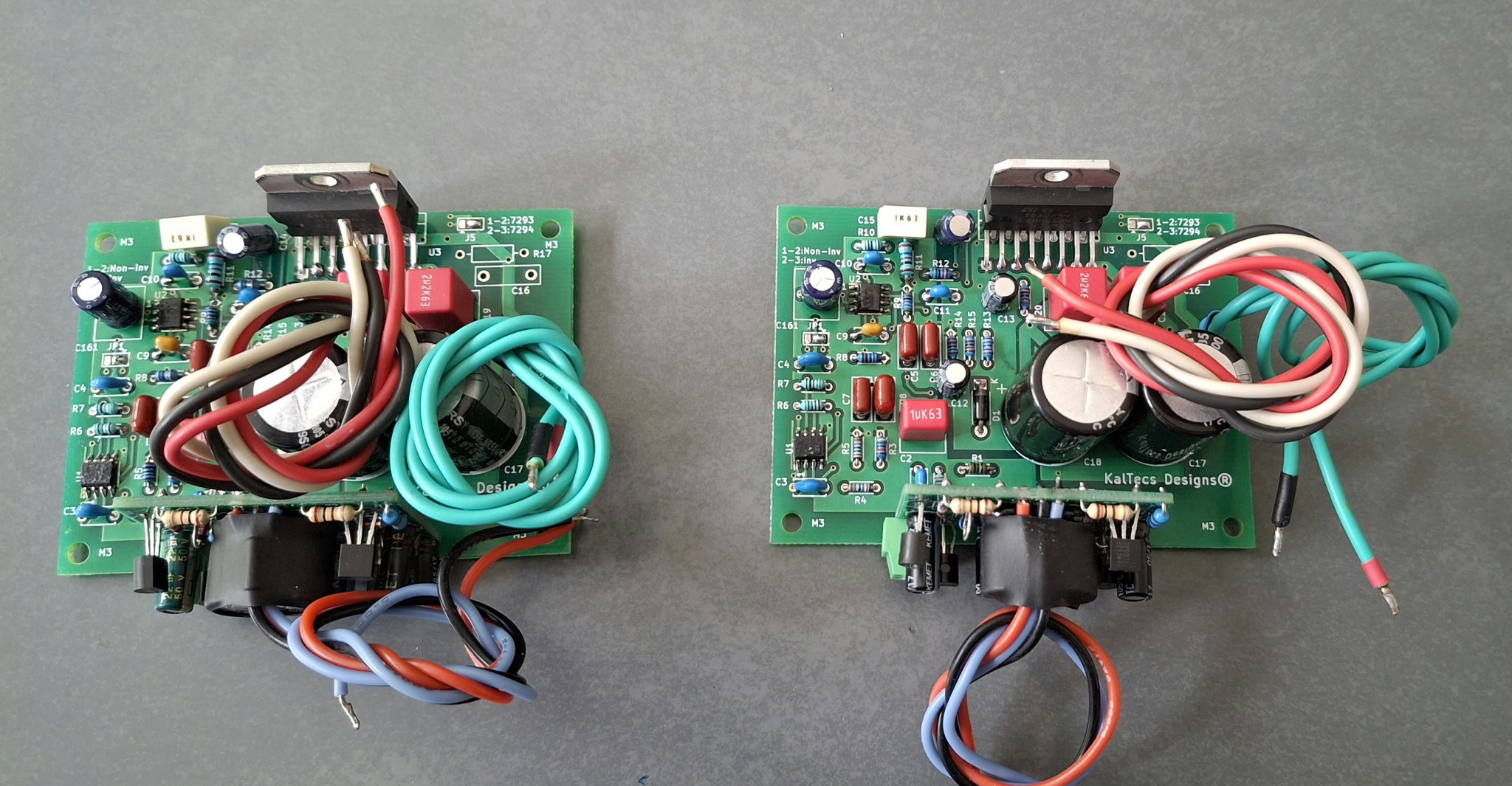

I got the boards from Sercan; they're very good quality and free of layout errors. I also got the boards from Kaltec (fully assembled). The layout is extremely weak, the construction is sloppy, and the component quality is poor, and all for €180 + €43 customs fees. Honestly, most Chinese boards are better. Additionally, I ordered boards with the TDA7293, but received boards with the TDA7294.
I'm looking forward to building Sercan's amplifier. I'm not sure yet whether I'll use the Kaltec boards, as I consider the stereo boards from China by Cirmech to be much better.

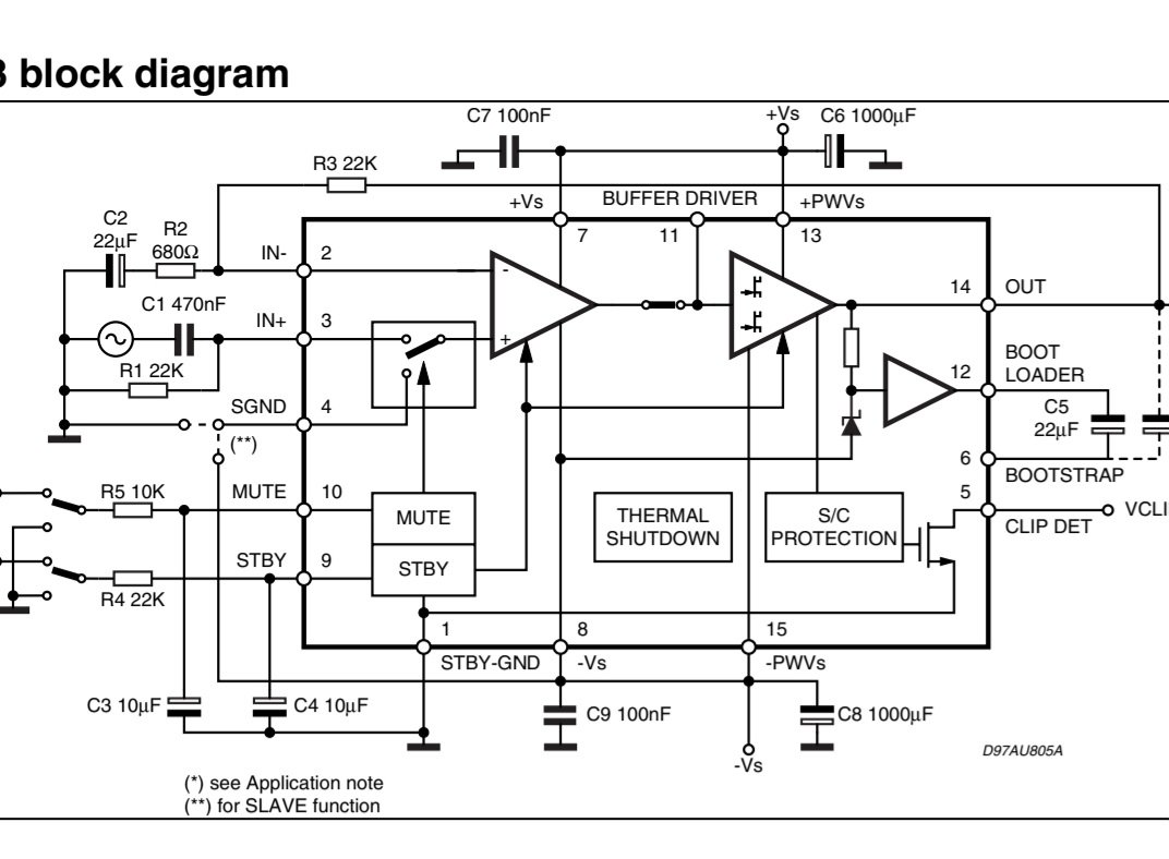

Hello,
What do you think it is possible to power the first stage of the TDA7293 (legs 7 and 8 which are IPS and VAS?) from a separate power supply?
I have a very good experience with other amplifiers when I powered the first stages from separate transformer and power supply.
If so are you sure you should get the same voltage as the output stage?Screenshot_20250428_012347_Word.jpg
Hello,
If so are you sure you should get the same voltage as the output stage?View attachment 1453889
It would be a good experience.. If you consider that the input stage is more sensitive to power supply ripples and transitions then I would add linear regulators to the input stages power input.. But of course the voltage level must be equal to the outputs power supply..

Hello,
Of course it is possible, BUT with EXTRA care!!!
If the positive buffer driver supplying voltage (pin 7) is lower than the voltage on pin 13 you'll enjoy nice real explosion - the chip literally explodes. You can try this for fun.
If the buffer driver supply voltages are ~7.0V higher than those on the output stage you can omit the bootstrap capacitor. This will lower the thd by 7-8%.
If the buffer driver supply voltages are well filtered (low ripple and noise) than the thd can be additionally improved.
I've tried all these years ago and you can really have some sound improvement, BUT no point to do it if you can use a well designed composite amplifier. This is completely different story.
