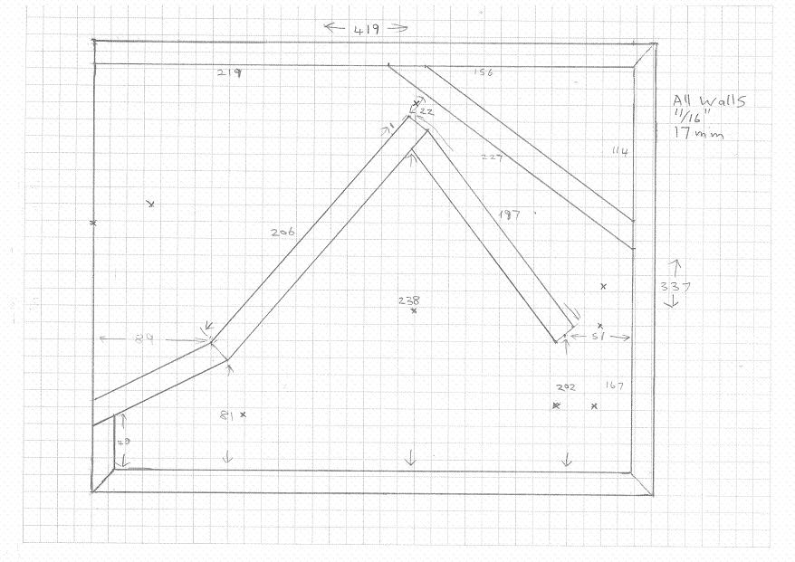

Mark,
First, an apology: I thought you used 3/4" HDF, but you used 5/8". You have a picture in post #31 with a ruler showing the thickness, and you also mentioned the thickness in post # 72. As well as "measure twice, cut once" I also need to "read twice, post once".
Second, I have managed to draw a plan of the box that matches your photos. Lots of orthographic correction, printing and measuring...
Armed with the measurements off the plan, I have modeled both your original Hornresp design, and the "as built" box, in Akabak.

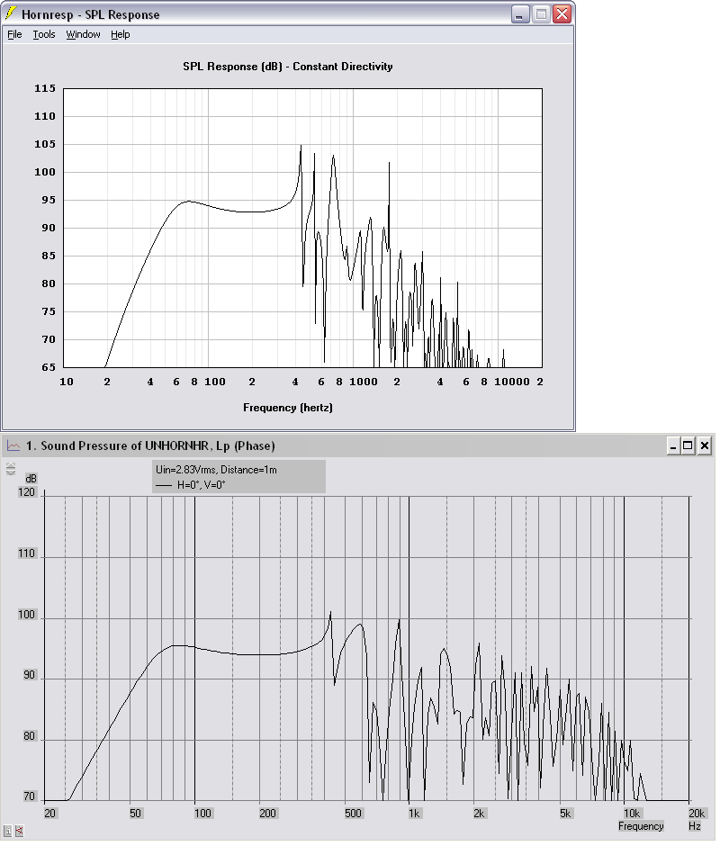

The original design model results match closely between Hornresp and Akabak. I would expect this, because Hornresp can export a design suitable for importing in Akabak, but it was a good sanity check. (Note that Hornresp will not export an Akabak model of this design because Hornresp models converging horn sections differently than Akabak.)

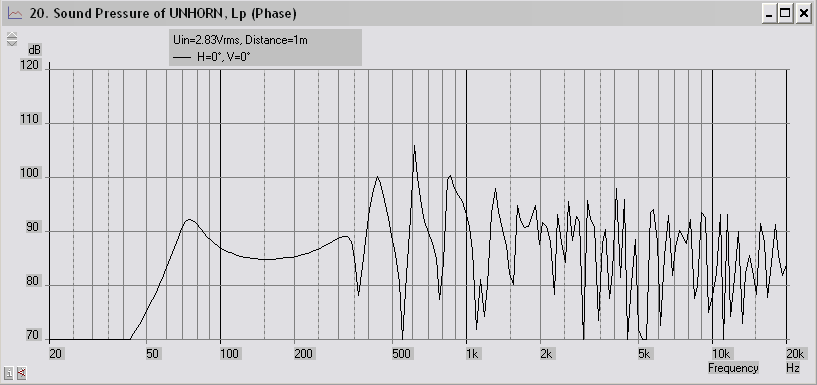

The "as built" model, however, produces results very different than the design model. The peak you noticed when measuring in your car is there too. It appears that the compromises you had to make (folds, flat panels, non-coincident drivers etc) have had their effect.
None of which is news, of course, and not intended as criticism of you. I emphasise that I would not be able to do better under the same constraints. All kudos to you for building it, we can model until we die but that is no substitute for making sawdust and seeing how it works in the real world. I look forward to your experiences with the new 2x DX7 box, it looks as if it will require fewer compromises.

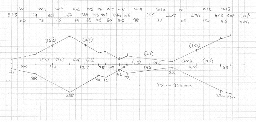

But in your defense Don the design is not totally faithful to the proper layout. The last three that I did have been almost exact replicas. But they are larger as you alluded to. A box this small is not easy to create. But it could be tweeked a bit to match almost precisely. Hindsight is always 20/20. I redid the design using conic paths only and it makes it much easier to work with. In a horn that handles only bass there is no real life benefit to using curves. There are only benefits up and above 350hz. Not a hard and fast rule but it has proven true for the most part.
Now you have me interested in whether or not you drew the design as I have. I found the original full scale template. So other than the 1/8th inch difference on the thickness of the material it is the original layout.
I'll tidy up the drawing, scan it and post it along with the Akabak scripts.

Okay, here we go.
First, the picture of the box plan, as I measured from your plan and your photographs. I settled on about 11/16 (17 mm) as the panel thickness - your photo with the ruler showed 0.68 inches.
The 5/8" HDF appears to have a laiminate surface which would account for the difference. Using 17 mm, everything fell into place.
I know it seems pedantic to be worrying about millimetres at these wavelengths, but they do add up by the time you get to the throat of the last sections.
Now, here are the SPL plots from your original Hornresp model and the corresponding Akabak model. Note the similarity.

Now we get to the heart of the matter. The attached image is the SPL plot from the "as built" Akabak model, again compared against the original design model.
The following Akabak script is for the "as built" model.

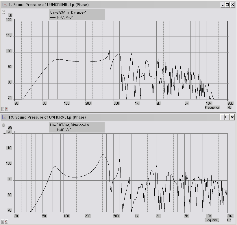

You said at one point that you were not getting the SPL you were expecting. Also, it was not clear how you had wired the two drivers up. At one point you said you had wired them + to -, - to +, which would put them in phase. In another post I read it as if you had wired them + to +, - to -, which would put them out of phase. You also posted a recent picture with yellow arrows, and accompanying text, that implied the drivers were wired out of phase (one cone pushing in as the other pushed out.) So I reversed the phase of one of the drivers in the simulation, and came up with the attached plot. As you can see, it doesn't look a lot different from the first plot, except the SPL is lower.
In short, if it sounds OK but you aren't getting the SPL you expect, check the wiring. You might have them wired out of phase... 🙂
The null in response is real if you have both drivers wired in same polarity. If they are wired in opposite polarity as described in the wiring instructions the horn works better.
