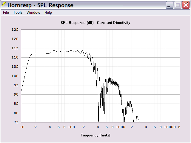

Hi there judtoff
I have tried it and here is a post to see what you get with the same drivers in a sealed box. Lets make it 2 cubic feet or around 57 litres. It's easier to use a computer to knock about designs than to make them and then measure them. Power in is 50watts.
Your maximum level is 105 db no matter how power you pump in. It's limited by the cone area and the stroke of the driver. A horn or in the case of the UNHORN gives you a more efficient coupling to the air around the box and in the room or in this case the car. To understand it simply think this through. If you ever tried playing a trumpet or some other brass instrument or woodwind you don't make alot of noise in the mouth piece. But put the mouth piece on the horn and voila you have a lot bigger sound. Same principle with a horn loudspeaker or a Tappered Quarter Wavelength Resonator which is what the UNHORN really is.
If you want lower (as I do) keep watching . I'm working in the shop right now on a set of three. Home version of the unhorn. True TRIO 8 18hz tapped horn and dual SDX7 18hz UNHORN box. Have to finish this stuff eventually.
Mark

I missed your comment about the second driver
The second driver gives you an extra 3db or double the effect of a single driver. Take a look at the pic below. As one driver pushes onto the chamber the other is pushing out at a midway tap point. You get the effect of a much longer horn for the low-end cutoff than you would any other way. Without this driver in this box you get a pretty sad output. Together it is quite impressive as the young lads mentioned.
Mark
P.S. I laid out one of the horns and the others are being worked on a bit more tonight when I go back to the shop. ( it's a long 60ft walk to the shop from my house. )

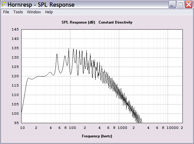

A bit of modeling and....
Hi 85audio
You can expect 3db less efficiency or half of the SDX drivers.
At 100 watts you can actually get a bit louder. The drivers suspension is much more stiff than the SDX7.
So all in all it is not a bad fit if you have the power. Mine runs on less than 10 watts most of the time. That's the reason I went this route. Clean and efficient. Runs off my head unit. Until I finish the next version. Then I will have another one to sell. Right now I'm working on some other boxes. Paying customers come first!
Mark
