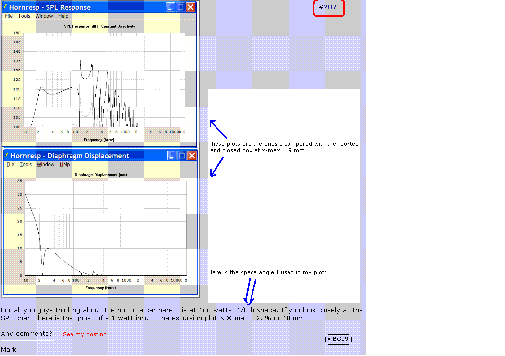

For all you guys thinking about the box in a car here it is at 1oo watts. 1/8th space. If you look closely at the SPL chart there is the ghost of a 1 watt input. The excursion plot is X-max + 25% or 10 mm.
Any comments?

One thing to clarify is that this box is designed for in home use. The posts that have been made as of # 205 and down have been simulated in a room environment. Or walls floor and ceiling. If you put it into a corner bump up the efficiency by 3 db. If you put it in a basement corner where there is a concrete floor and two corner walls bump it up a bit more. If you are putting it in a car you get 6 db more efficiency.
The only bit of argument that I have with your findings is relatively minor. I simulated in 1 pi environment. Or a room with a ceiling and walls. Your one simulation at least, is in a corner loaded environment. ( .5 pi ) That is not exactly the same.

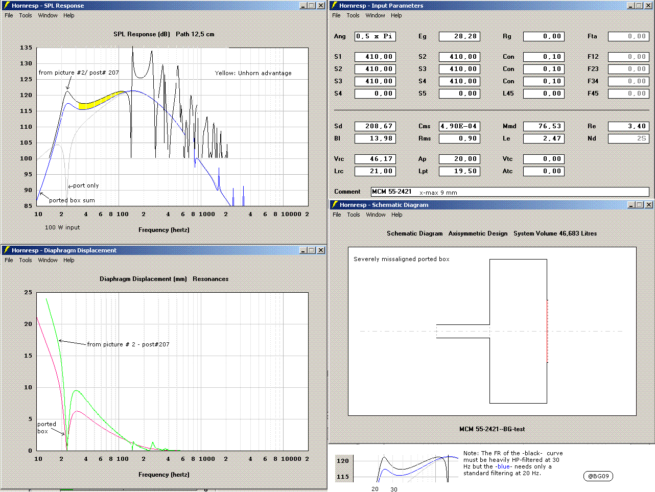

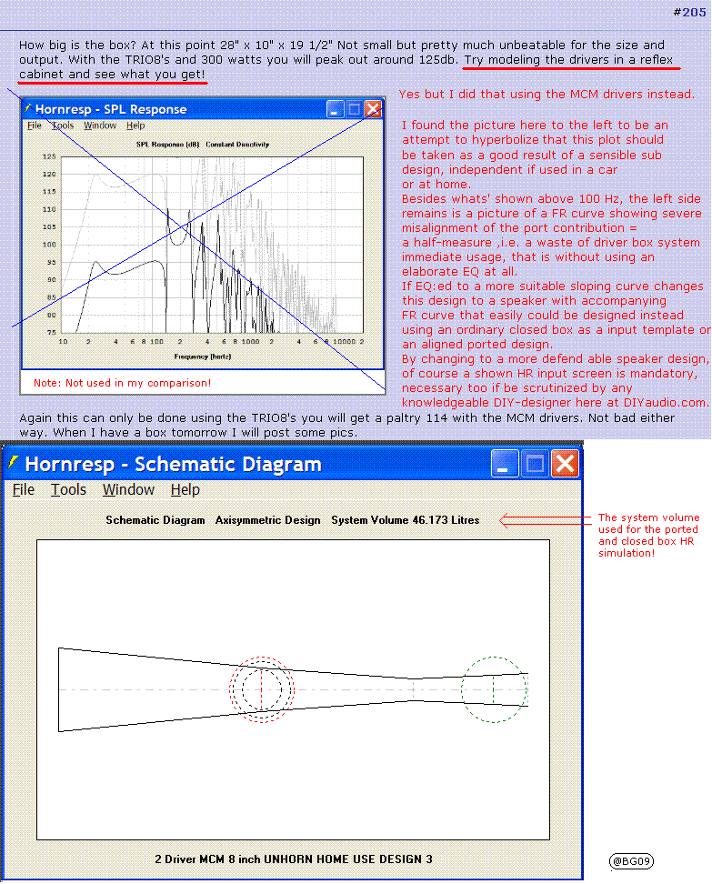

..Hello Bjorno
Thank you for your comments and the time you took to create your simulations. I have always found your comments constructive and kind and I thank you for your findings..
Thank you Mark!

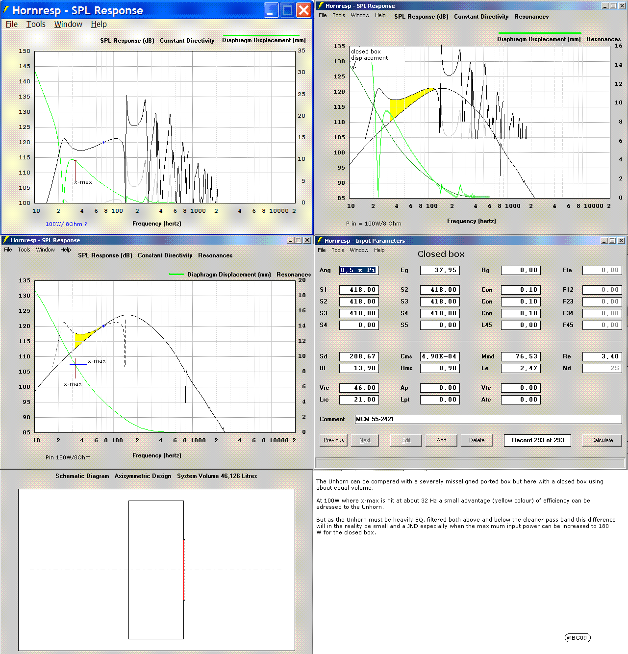

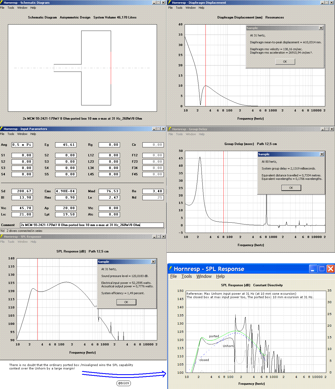

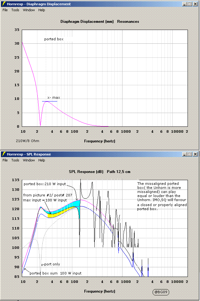

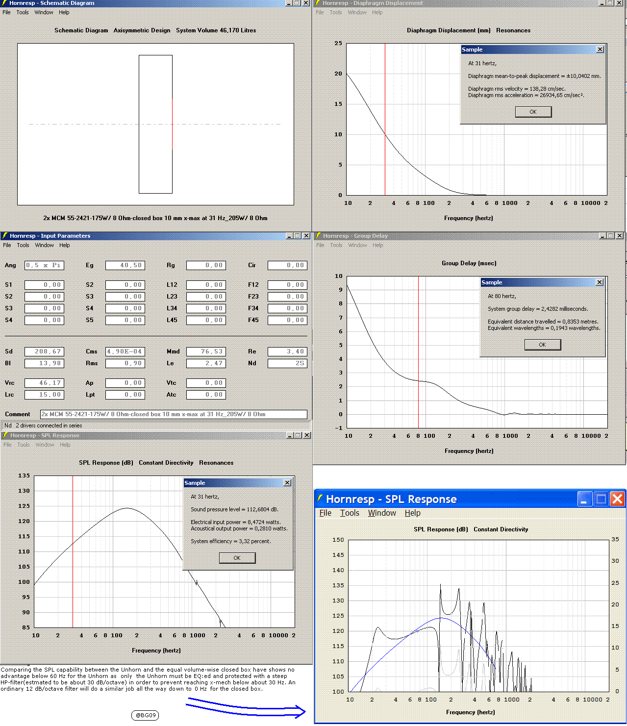

But,Sorry, I'm not going to use valuable thread space answering your IMO odd reaction to the message I brought with my posted pictures but here are some newer ones pointing at the information I used as an input. See pictures a and b.
Why don't you post the input HR screen addressing the two pictures in posting # 207 I scrutinized to be reflecting a very misaligned design?
This could save you if I've done severe mistakes when comparing your Unhorn to my closed resp. ported simulations. I would immediately confess If I'm wrong.

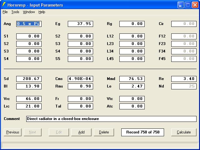

Hi David,
😱 Thank you for noticing my misuse of your eminent HR program.
I simply randomly copied an older closed box template I've used to simulate an closed box many HR revisions ago.
I understand the importance to be correct when publishing plots that could fall back on you as there could be a lot of HR newbies that could be unnecessarily misled by my posted plots.
🙂 So I've made a new attempt to rectify and sorting this problem out:
See picture c and d
b
Hi bjorno,
I simply randomly copied an older closed box template I've used to simulate a closed box many HR revisions ago.
I thought that was most probably the case 🙂.
Exactly - that was my concern. It seems that Hornresp can be confusing enough to users even at the best of times 🙂.
So I've made a new attempt to rectify and sorting this problem out: See picture c and d
Many thanks, much appreciated.
