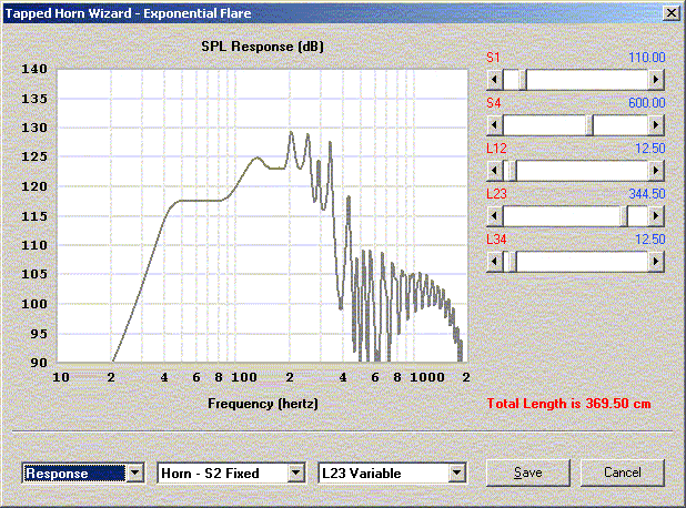

Here is the input screen for the latest design as built with driver positions and the mouth that is a bit to small.
Mark
The peak can be tamed with an inductor and or proper stuffing. But with an electronic crossover it is not a big problem. One thing that I will have to investigate further is the low end below horn cutoff. I have been playing it at high levels and it does not bottom out really hard. I'm not sure yet why I'm only driving it with my car amp as of now. At 3 ohms I have around 40 watts clean power. But it is louder than I care to take it. Test tones are excruciatingly loud. So if the weather co-operates I will do some outside testing and some inside testing this weekend.

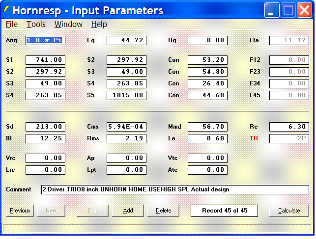

I noticed that you used 1xPI for your TH model. I think 2xPI would be a better choice if you want to compare output capability with a sealed or vented alignment modelled by WinISD.
Well here is a quick comparison. Both boxes have their strong points. The UNHORN2 Does have low end problems below 30hz. But the comparison is telling.
Well, I hate WinISD (graphs way too horizontally compressed for my taste, and it just looks so horribly un-Maclike), but it wouldn't occur to me to use an undersized vented box for the Mael-X for the car. A sealed box meshes nicely with a car's transfer function.
Here is the TRIO8 500 watts of power with almost the same muscle.
Except that from probably ~70 Hz down, the Trio8s are going to be well over xmax! I base that off of modeling a 4th order BP box and assuming that a horn will be a little better.
As it happens, I have both a Mael-X and a pair of Trio8's, so it might be interesting to do as a comparison.

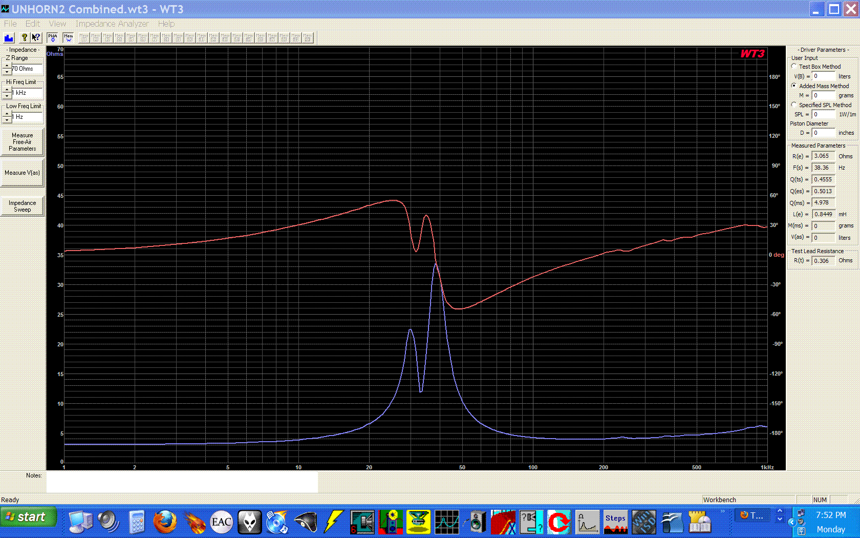

It sucks measureing loudspeakers

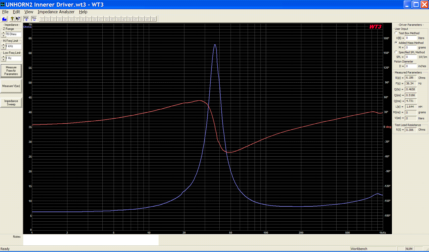

I do believe my two young friends managed with my little undersized amp to fry the inner driver of the UNHORN. All the measurements that I have done are nothing close to what we were getting in the car test. So I must make a couple of access panels and check things out thoroughly.
As for the comparison between the UNHORN and the Maelstrom. I should pay a little more attention to the programs that I'm using sometimes. I uploaded the 2 Pi results. Yes it makes things look a little worse. But I'm not all that unhappy. Were still close at 1/3rd the power input. And almost the same size box. And come on guys were comparing an 18 to two 8's. Lets be fair here. The 8's need some real competition!

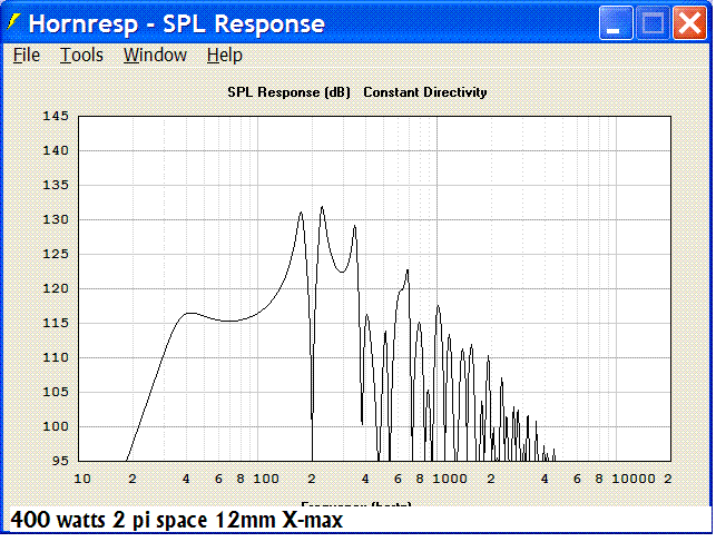

What about the displacement graph at the same 400W power level? I think that might be of interest as well.

I have an impedance plot that tells much about what is happening to the driver on the inside. It was not that way prior to the boys torture test. So although I'm a bit unhappy that i killed a driver I'm pretty sure that I know why. We never hit over 5 watts into the box but they were trying to get the drivers to unload below the box system resonance. I really did not hear anyhting going wrong but that may not have been the actual case.
They were getting 112dB with just 5 watts?
To actually kill one of the drivers with just 5 watts - that sounds a bit unrealistic. And your TH's got significant out of band noise just above its passband - that should have amplified any distortion being produced. Surely it would have been very audible if the amp was being driven over its limits.
I think it would be interesting to see what's actually happened to that inside driver.
I might have missed this - what's the net volume of the box?

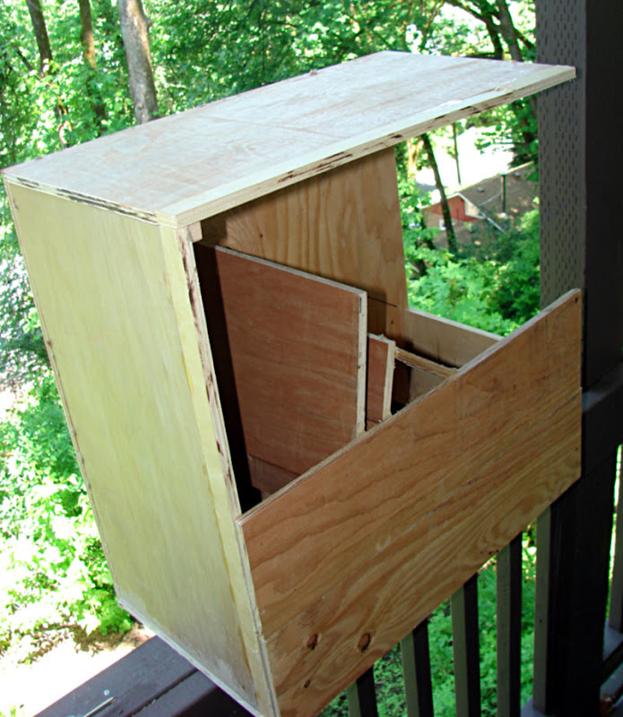

Here is a construction drawing. Full scale with some cleaner lines drawn in.

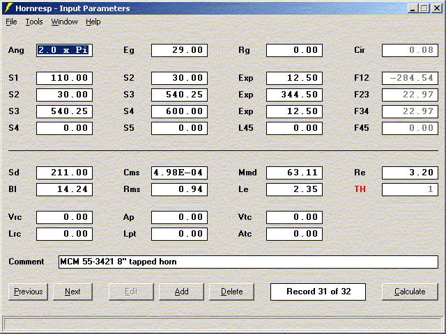

Hmm... that looks a lot like the TH design I recently stumbled across while playing with HornResp. Basically S1>>S2, with the driver placed at S2, then you expand as normal. The expansion at the other end of the throat tends to flatten the response - well, at least in the sims. I've yet to build one to confirm - because I can't find a way to efficiently fold it like you did 🙂.
Here's an example, using one MCM 55-3421. Notice the predicted output for just one 8...

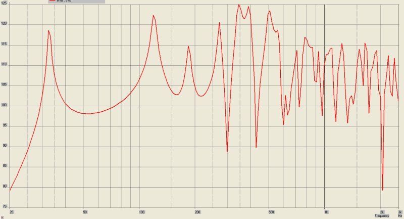

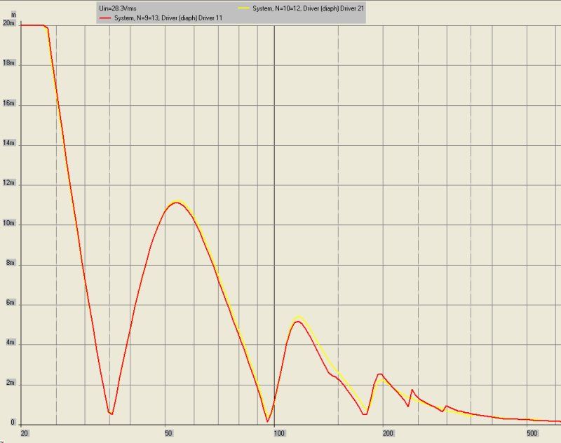

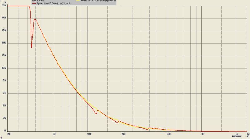

OK, I think I figured out why the woofer went *pop*
This is your original design. See how the front and the back wave of the woofer is seperated by just an inch? That will make the excursion go crazy, since the woofer is almost completely unloaded.

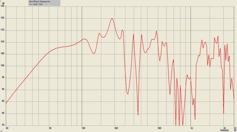

I looked at the pic of your NEW box, and created an Akabak model of it. Here's the simulate excursion. As I feared, the woofer is almost completely unloaded. This simulation is with 100 watts into 8ohms. You can see it won't go "pop" until you get serious output below 50hz. The yellow line is the first woofer, red is the second.
This is the frequency response. Efficiency is high, but frequency response has serious peaks. Akabak models this more accurately than Hornresp. Hornresp can't model multiple woofers in multiple locations, and it can't model a woofer that's arranged the way you've arranged them. Akabak can.
For the sake of comparison, here is the SDX7, but simulated in my "triple 8" box. This is the excursion. With a 30hz subsonic filter, the design will take 100watts before running out of excursion.
Here's the simulated frequency response. Efficiency is lower, but response is smoother.
The purple line is the actual measured response of the triple-8 enclosure, with three eights. Note the peak at 180hz, and the dip at 120hz? These are consistent with the Akabak sim, which shows that Akabak is pretty darn accurate.
Here's the Akabak model for your box. I took the dimensions from the pic you posted.

Hi Patrick ( I have no idea where I came up with John this evening )
If I read this correctly this is the driver parameters section for AkaBak.
Sd=128.3cm2
Bl=8.46Tm
Cms=10.02E-04m/N
Rms=2.09Ns/m
fs=34.0000Hz |Mmd = 1.69g not recognised by AkAbak, fs calculated and used instead
Le=0.75mH
Re=6.40ohm
ExpoLe=1
The specs do not match the TRIO8 or the MCM driver. So this can't be a valid comparison. It is an interesting comparison but not a valid one.
