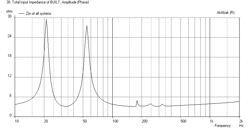

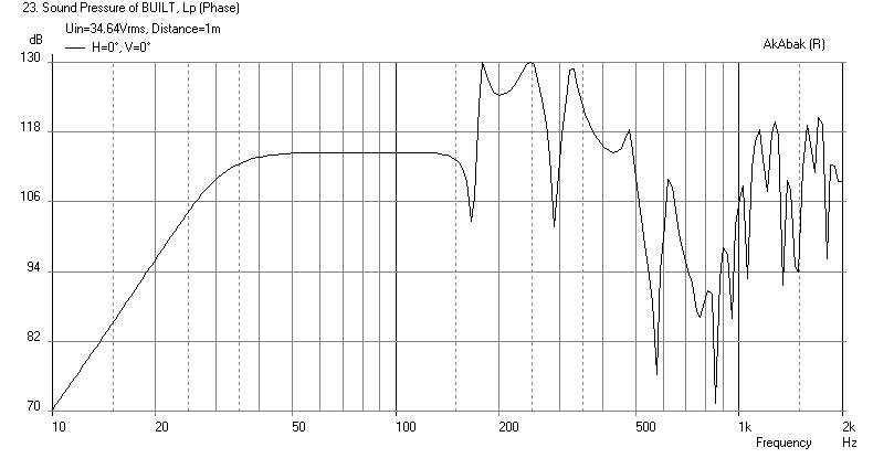

Mark,
I've converted your picture to an AkAbak script. The result is encouraging. See the attached images. One shows AkAbak's sound pressure measurement with the drivers at maximum rated power (200 watts each), the other shows the impedance curve.
The lowest impedance is 3.2 ohms, so a 2 ohm capable amplifier rated at 300 to 400 watts into 4 ohms would be suitable.
The system is power limited down to 26 Hz, below which it is excursion limited. Based on the driver Xmech figure it should handle up to about an 80 watt amplifier without excursion damage, but a high pass filter will be essential if you want to run high power.

Damn - that looks nice. 2*PI or 0.5*PI? What's the output look like at 2.83V?

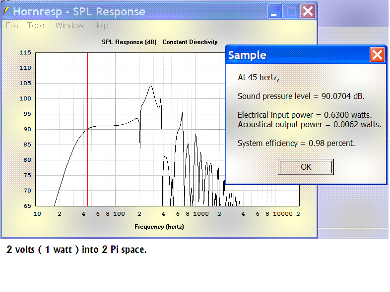

Here are some figures Brian. Maximum power is first.
Mark
This is interesting - Abakak is predicting for your design an output of just over 113dB if I'm reading the graph correctly. A simple vented enclosure with those drivers should be able to achieve something similar. However HornResp seems to be suggesting somewhat higher output.

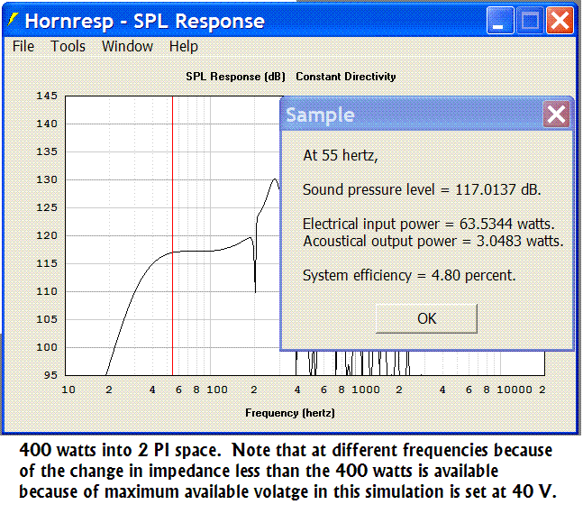

Hi Brian
I'm a bit stumped by something here. I have quite a few programs that I can model these drivers in. Bass Box gives a maximum SPL of 114 db. WinISD gives 107 db. Stick the 6 db corner loading on either one and you may get a true corner loaded SPL specification.
The JAVA applet on the LINEAR TEAM site gives me a maximum corner loaded in a standard 14' x 16' x 8' living room 100 db. Add a second driver and you get 103db. Corner load the cabinet and 109db.
Hornresp gives me 128db corner loaded.
They are programs. Only as good as the moron typing in the data I know. But I'm using the same Thiele/Small specs for them all. So heck if I know. What I know for sure is this. Hornresp predicted 108 db/watt for UNHORN1 in a car or 1/8th space. And that is what I got. So maybe I trust Hornresp?
The output at 2.83 volts is about 92.5dB.
The AkAbak default is infinite baffle (2*PI). If you want free space (4*PI) you need to specify the baffle dimensions. If you want 1*PI or 0.5*PI you need to define some reflectors to represent the floor and walls.
This can get complex, but it does allow accurate modelling when calculating, for example, baffle step and floor reflection compensation networks. (Akabak models electrical components as well as acoustic components.)
Ah - quite similar to HornResp. I notice that the peak voltage in your model is different to the one Mark used in HornResp, which would explain a good portion of the discrepancy in peak output as well.
At 92.5dB, my spreadsheet suggests that the output is just one dB higher than a simple vented alignment using the same drivers (wired in parallel).
