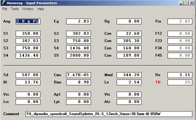

Thank you so much Patrick for your input. I'm used to large boxes as you can see, so that's not an issue. The reason I want to try a TH is 1) Fewer drivers. 2) Less power consumption due to less sub amps. 3) Able to play down to 20hz (I know it's inaudible). 4) Hopefully produce SERIOUS ULF's (ultra low freq.)... TH amp has remote gain control on dash and switch to only use it when I want.
So aside from the no free lunch bit, could 2 12's or a single 15" sub fit in a TH with max outer dimensions of 72" long x 65" wide x 18" high (roughly 49 cubic feet) and still be able to play down from 30hz to as low as possible?
And if it makes any difference I'm looking at the Sound Splinter RL-S series to do this. Here's the specs for the 15:

As a general 'rule of thumb', I design tapped horns so that the tuning frequency is about 0.707 times the FS. This isn't a hard and fast rule, but it helps me 'get in the ballpark' before I start to do serious number crunching with hornresp.
With an FS of 25.51hz, I'd be looking at a tapped horn tuned to about 18hz. Seriously, this is why nearly all of my in-car tapped horns were eights. An eighteen hertz sub is just pointlessly large for a car. I've literally loaded music files into audacity, and there is no content below 30hz in most music.

Hi Speedcult,
Besides the fact that Patrick Bateman is obviously correct, if you want to build something as you are describing it in Post #341: "...TH with max outer dimensions of 72" long x 65" wide x 18" high..."; then it sounds like the DTS-10 should fit your bill (44 x 59.5 x 16), and it seems to be available again as a kit:
Danley DTS-10 "Super Spud" DIY kit - AVS Forum
I'll also attach a very quickly done Hornresp input using your Sound Splinter 12" T/S data:
