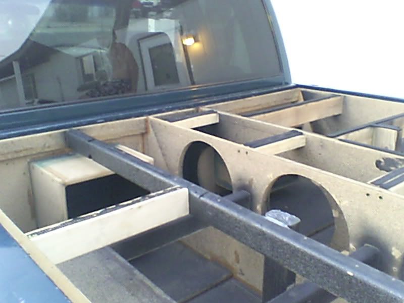

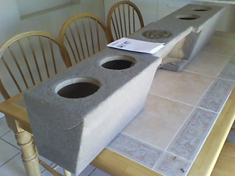

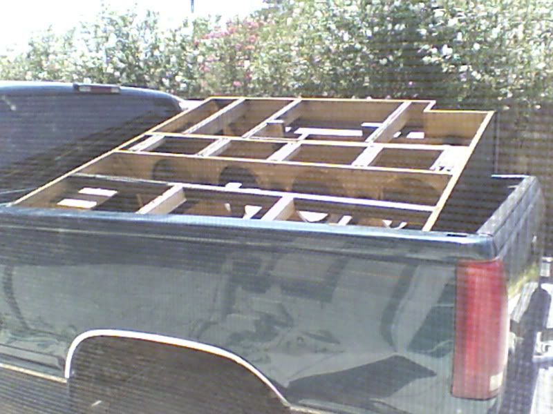

Hello DIYA, allow me to play doctor and bring this dead thread back to life. After seeing some PWK videos, I started to wonder about tapped horn designs which Google led me here when I searched "tapped horn in car". The info and the links are tremendous and quite frankly make my head spin. This is a whole new level of car audio for me. This is all going in my truck and may be a fun experiment for anyone willing to do the math.
I want to turn as much of my bed into a tapped horn as needed. The pic below shows I care more about hauling sound then stuff (which I rarely do and can use a trailer if I do). So with that out of the way, here's how you stuff EIGHT 12"s into a truck and still keep the back seat lol.
Here's one to show it coming out and the length it takes up in a 6' bed (almost all of it lol)...
Now I know tapped horns can play very low and loud. I need one that can do 35hz on down, so I imagine a couple of 15" drivers should do the job. I have a ported enclosure designed for four Anarchy 6.5" that fits perfect under the back seat that will cover the 35-80hz area, where the mids and highs take over... not needed but here's a pic of that one.
So here's the fun part for anyone that ever wanted to make a truck bed size TH.
2000 actual RMS on hand to feed the subs. $400 budget for drivers (maybe more if needed)... would like it to play 35hz and lower and be loud. I know that low and loud is not small and small and low is not loud. I can post up dimensions if anyone is interested in trying to help me with this.
Since you guys know what will work, the driver size can be any and any number as long as it fits into a reasonable budget and can go low and loud. Obviously have enough power so that's not an issue and it does not have to take up the whole bed but I'm sure it may lol.

If I am not mistaken, I published some of the first tapped horn designs for the car, and I've documented in-car designs to a great extent. You can see my posts on diymobileaudio.
Before you go and chop up your car, I would spend some time evaluating what your goals are for the project.
Here's why -
The overall size of a horn is directly related to the size of the driver. This is a lot different than a sealed or a vented box, where there isn't a huge correlation between box size and driver size. For instance, I've seen 12" woofers that fit in a half cubic foot sealed box, and I've seen eights that need a full cubic foot to get proper response.
Horns don't work like this. With a horn, box size gets very VERY large as the size of the driver gets bigger.
That's the reason that nearly all of my published designs use eights. By using an eight instead of a ten or a twelve, I keep box size under control.
Also, another complication with tapped horns is that it's possible to have TOO MUCH low bass!
I know this is a strange problem to have, but it's very real! Particularly when you're building a box for a car, where it's trivially easy to get low bass due to cabin gain.
To make a long story short, before you tear the car to pieces, I'd recommend investing some time determining what your goals are for the project, and then determining if a huge horn with twelves is the way to get there. Based on my experience building numerous tapped horns for cars, I'll bet that twelves are going to play TOO LOW and will require a box that's unnecessarily big.
