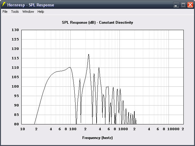

Response curve for the previous model. It is only a 40L box, it has the falling response I was after, but I do not think I'll waste time building it. The impulse response looks terrible (rings like a bell). Back to the drawing board.....

This particular box is about 95 litres. Or around 3 1/2 cubic feet. As dimensions take something like this. I.D. 8"x 24"x 30" Small enough to fit in the back of my Toyota Matrix. The size I chose is to go all the way down to the basement for listening to Organ music and the like. There are obviously much smaller combinations.
Normal music cuts out around 40hz so I'll post one for that shortly. I'm going to build the one I simmed first. It will replace the tuba 18 that is currently hogging all my space in the back. The tuba 18 is just great if you are listening to anything above 50hz. I rapidly dies if you ask it to produce anything below that. It only gives a hint of 30hz which really sucks.
This tapped horn will be what the doctor ordered. More or less flat from 100hz down to about 18hz.

Impulse response. Not to bad for a subwoofer.
With a little bit of power we get a lot of noise.

A quick check on the realities. This CSS SDX7 driver is rather amazing. You get more efficiency and X-max than anything I know of within the price range. Plus the second design is almost a qualifier for the smallest tapped horn thread. Less than a cubic foot. actually with a quick calculation of Inside Dimensions of 20.3 cm x 30.48cm x 32 cm. Or 8"x 12" x 13" that is pretty small. And the SPL's available from a single nominal 6.5" driver are Pretty Darn Good!
