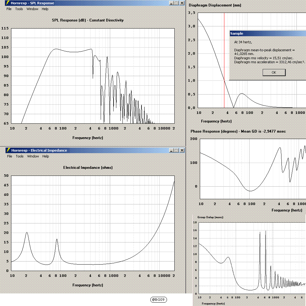

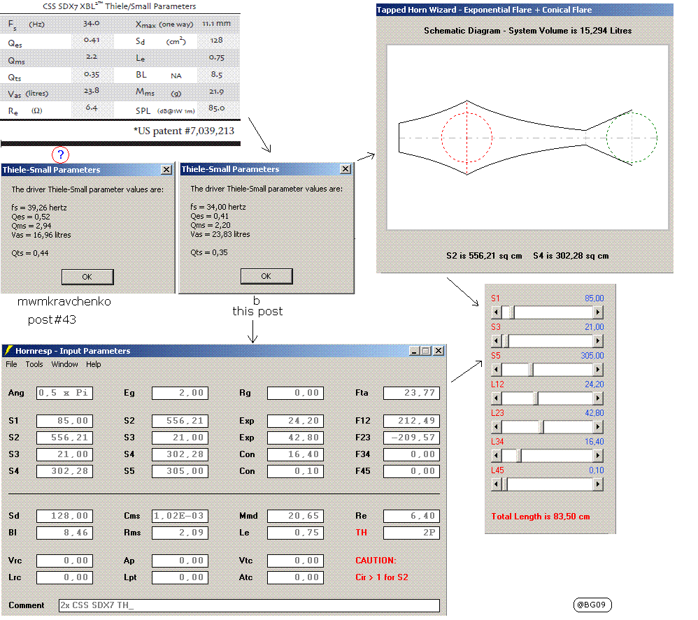

Agree, and there is more to worry about: like the driver parameters used for input of the simulation and that the simulation schematic doesn't correspond to the implemented box :
See picture 1(2) and 2(2) that suggests the both simulated drivers rear/front sides are close to each other and not separated as shown in the real world pictures.
b
1(2)

As for increasing efficiency I played with the simm for a couple of days. You can only trade bandwidth for efficiency. No free lunch on this one. With greater efficiency came lower bandwidth. What I ended up making was what I felt made the best compromise.
For the sake of fairness I will test it outside ground plane with this caveat. I only have so much wire comming out of the car. So it will not be half space as in against a wall floor juction but a true ground plane with no boundary reinforcement. So what ever I come up with will need to be bumped up 3 db to reflect a floor wall boundary effect.

I think that your box design does not correlate well to the hornresp model, it could probably be improved by extending the first section, that's why I ask you to measure "unbiased" efficiency, and compare to hornresp results (half space too). If it's close or better, then the box layout is ok. I bet you will get a few dB less than predicted.
I didn't build one note boxes, tunings were well spaced, typically around 37Hz and 100Hz for minimum overall cone displacement, with moderate resonant Q. Some of my layouts were not very different from yours. The cabin and the proximity of surfaces inside the car detunes the "ports" to the low side, usually requiring fromt chambers just like yours, without a port or even a wall sometimes. We only had problems with one crazy kid blowing speakers until we found something with a big enough voice coil.
