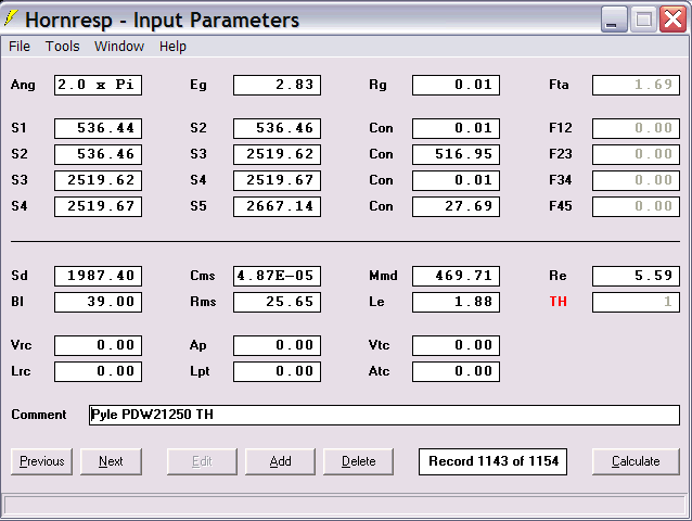

Can't say as I'm surprised considering that 21" must be a relatively real low volume product.
Solving from the published specs I get 1987.4 cm^2 which seems about right to me, but the P-Audio is listed at 'only' 1660 cm^2, so YMMV and makes me wonder just what parts might be shared.

Comparing the Pyle to a B & C
I took the specs off the B&C as it is almost the same O.D.
It comes out to 1680 cm squared.
My sim is plunking along but I just started it. The depressing thing is I crunched two 15 inch drivers from CSS and they are pretty damn close to what I'm currently getting from the two 21" as the 15" have a 30mm X-max so usable volume is 790 * 3 = 2.37 liters for the SDX15. The Pyle comes out to 1680 * 1.2 = 2.016 liters Even the B&C at 15mm X-max comes out to 1680 * 1.5 = 2.52 liters But the price ratio is painful.

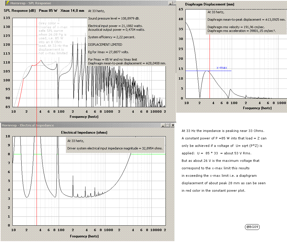

Am I missing something here?
Bjorno posted a wonderful looking design that I think he claimed had more equal amplitude response at higher sound pressure levels.
http://www.diyaudio.com/forums/showthread.php?postid=1884958#post1884958
I ran his numbers thoroughly from post #10 and this is what I get:
Now that is no where near to flat amplitude response. I have been messing around with other designs at higher power levels and it is interesting what the Hornresp program comes up with. The lower level simulations of the UNHORN were actually quite accurate. I gues it's build it and measure.

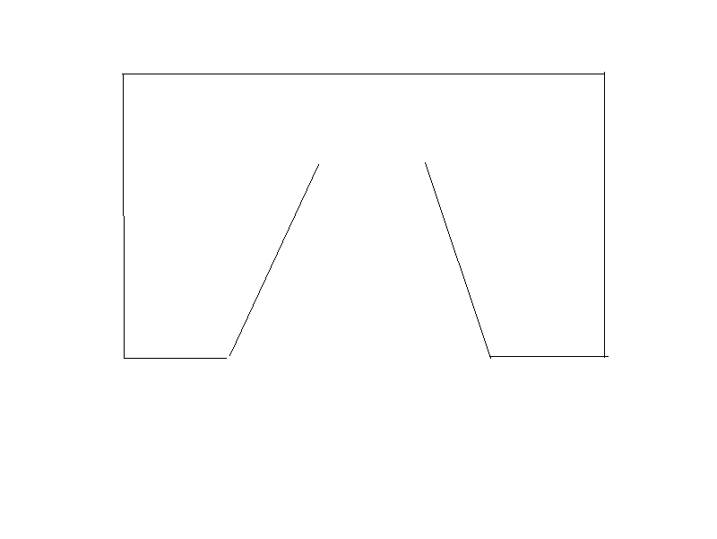

Your design is interesting and I have played with it a bit. You are indeed a hard act to follow. It is almost optimized as is. Very close.
The Danley design appears to have two horn paths in a common mouth.

Re: Am I missing something here?
If he did, I can't find it.
GM
mwmkravchenko said:Bjorno posted a wonderful looking design that I think he claimed had more equal amplitude response at higher sound pressure levels.

Tweeked bandwidth and a bit on the volume. I'm stuck on volume because two horn mouths in tandem reinforce one another by about 3 db. But I have no easy way simulate two horns in close proximity. So improved is in the eye of the beholder.

quote: Originally posted by mwmkravchenko Bjorno posted a wonderful looking design that I think he claimed had more equal amplitude response at higher sound pressure levels. If he did, I can't find it. GM
The post is here:http://www.diyaudio.com/forums/attachment.php?s=&postid=1885165&stamp=1248192855
Note the input power the loading into a 2 pi space and the output level at 108 db with 36 watts input. I'm not trying to criticize Bjorno's work. I'm just trying to understand what is going on here.

P.S. Sad drawing is bare bones cinemonster mouth.
Best pic I could make of Cinemonster

Hi all,
Agree with David. Posting Constant Power plots is very confusing if having limited knowledge on how to interpret what those in fact are representing.
Even showing only Constant Voltage plots without the HR main input screen is as well IMO bad, leaving the reader to guess if this is reliable or not.
This can be seen in the threads supported with posted HR plots where in the texts the buzzword 'SPL' occurs almost as a 'Mantra'
and the only parameter discussed besides huge thermal input Wattages.
Here follow two pictures 1(2)-2(2) that I hope will show that my posted SPL plots are quite achievable and well supported/ backed up with pictures from other HR tools.
For instance I always show displacements plots defining on what BW I'm targeting and that is safe SPL wise.
b
1(2)
b
1(2)
