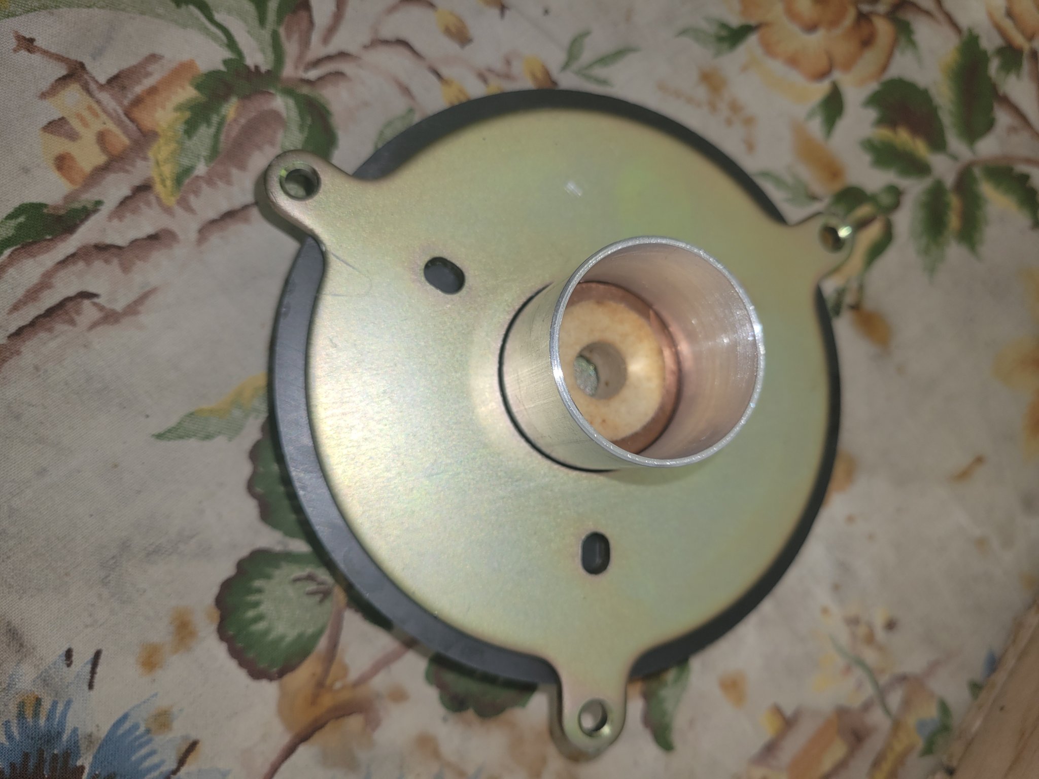

Slowly advancing..Ordered an aluminum pipe in the meanwhile to have it lathed.. to little a bit more than 33mm internal diameter and little less than 34,5mm externally..
My bad, the bush internal diameter has been machined to a bit more than 33mm while the initial 35mm external diameter of the pipe has been maintained.
The bush fits rather well, now onto finding a bicomponent glue.. maybe pattex or bostik or?
Well I might have some uhu endfest left if I able to find it..
Would something like the polyurethane Pattex PL400 be good too?

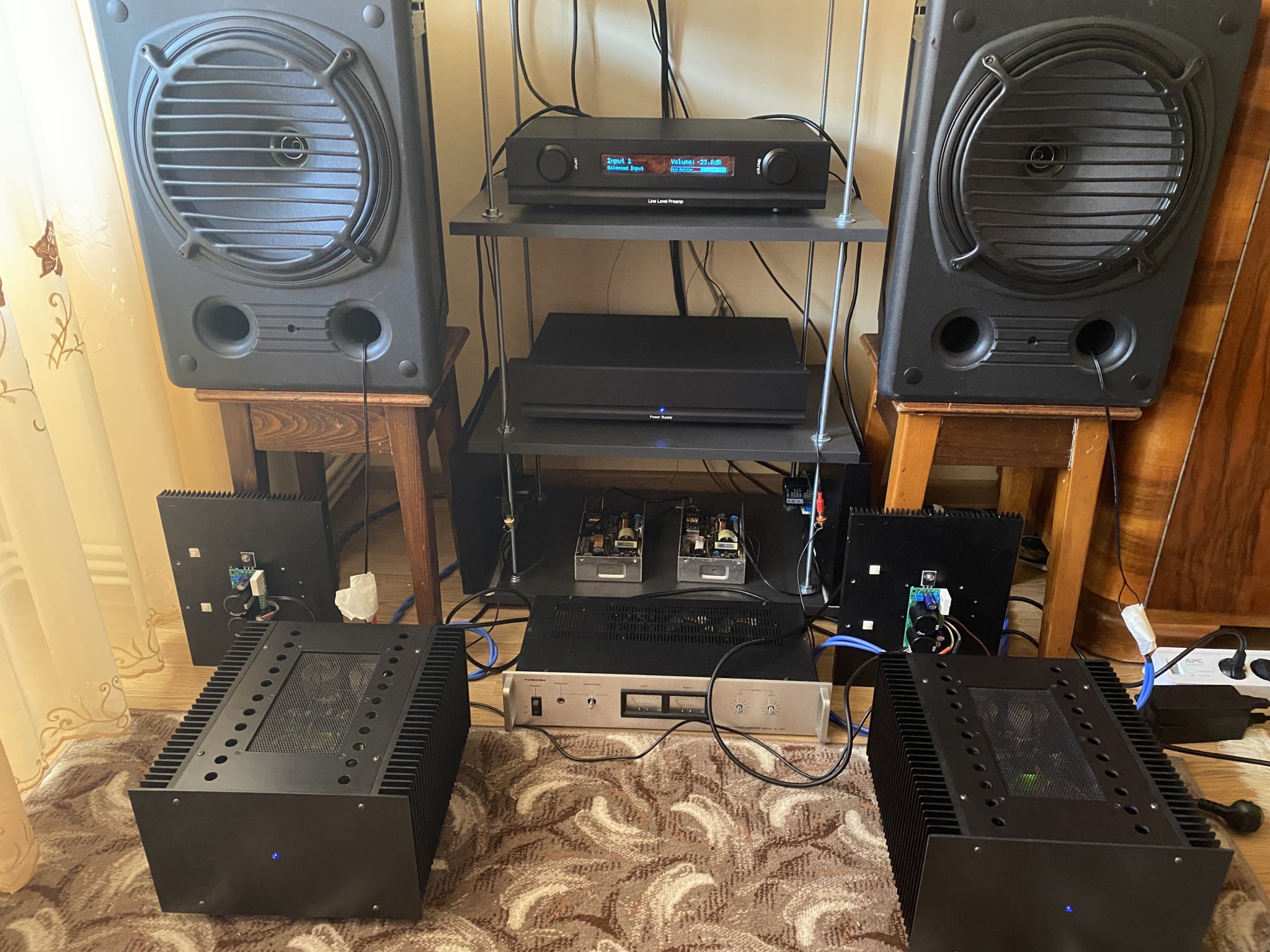

The vumeters are not broken 🙂 they indicate correctly the power, 1w on the meter corresponds to 1wrms/8r on the speakers.
As a proof that the vumeters work

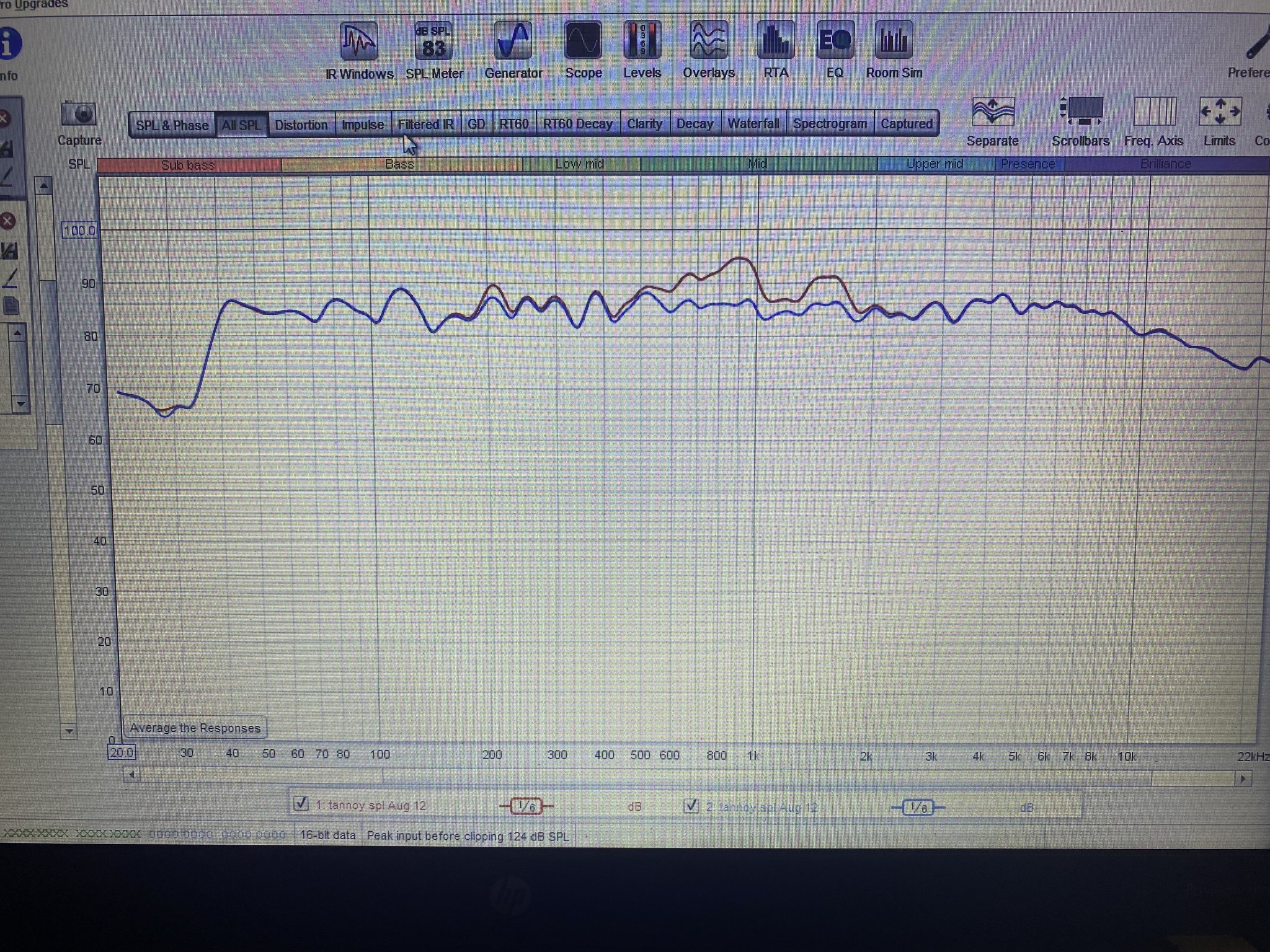

1w into each speaker means 100dbspl from both 🙂
I applied a bit of room eq too. Red is without room eq, blue is with it.
