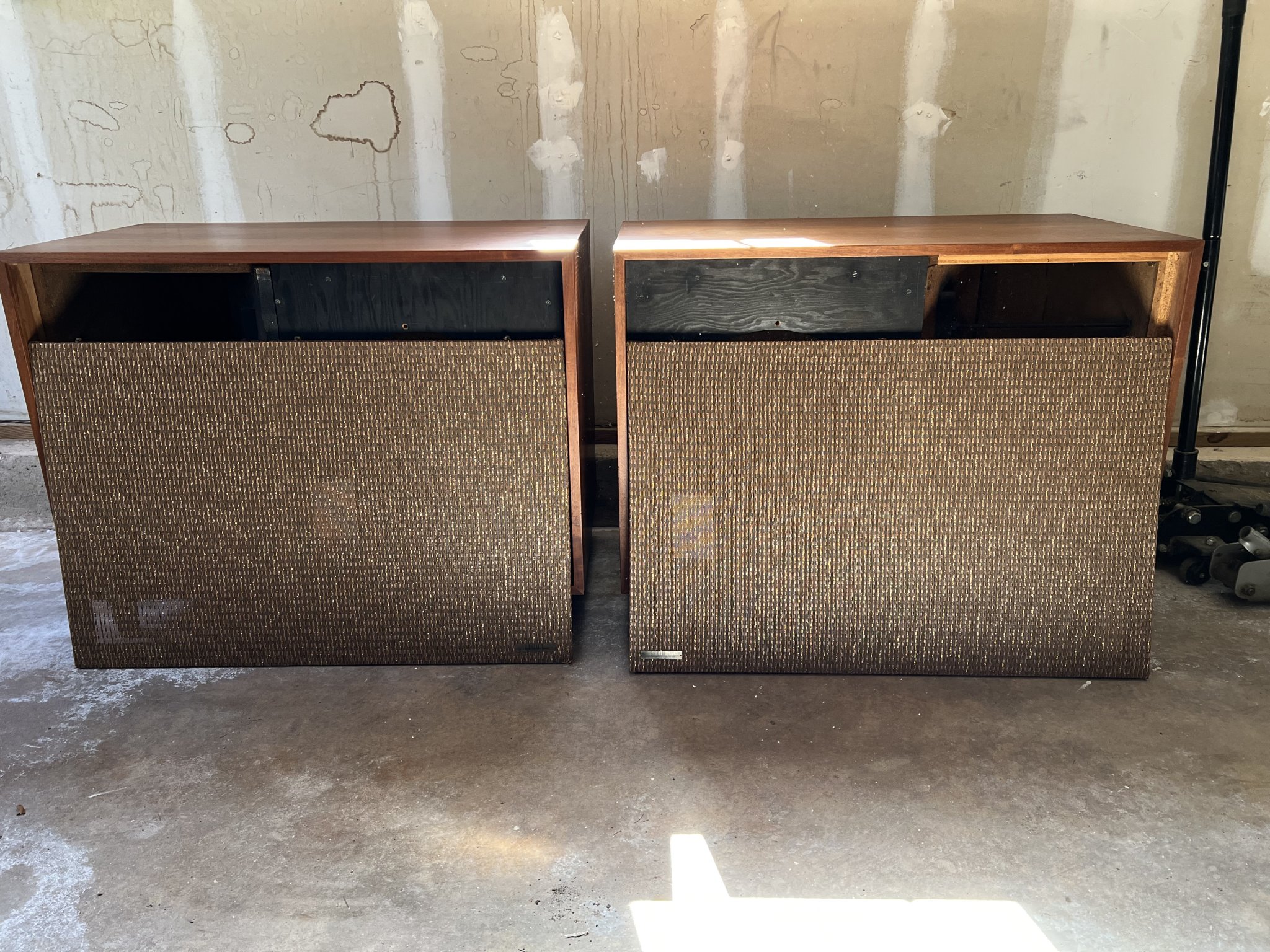

Made it home with the new family members.

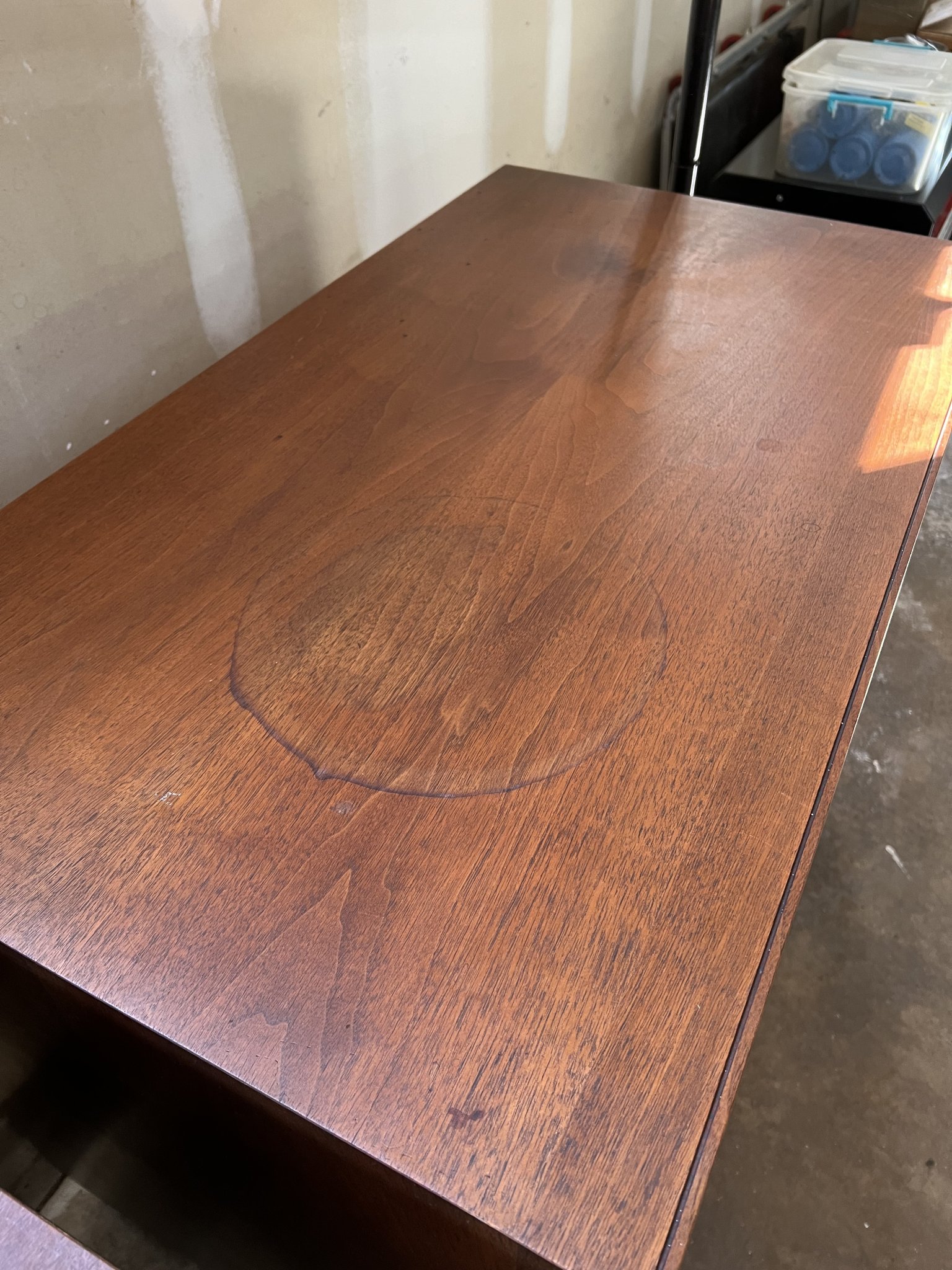

They have some history and will need some attention. Requisite planter ring on top of one.

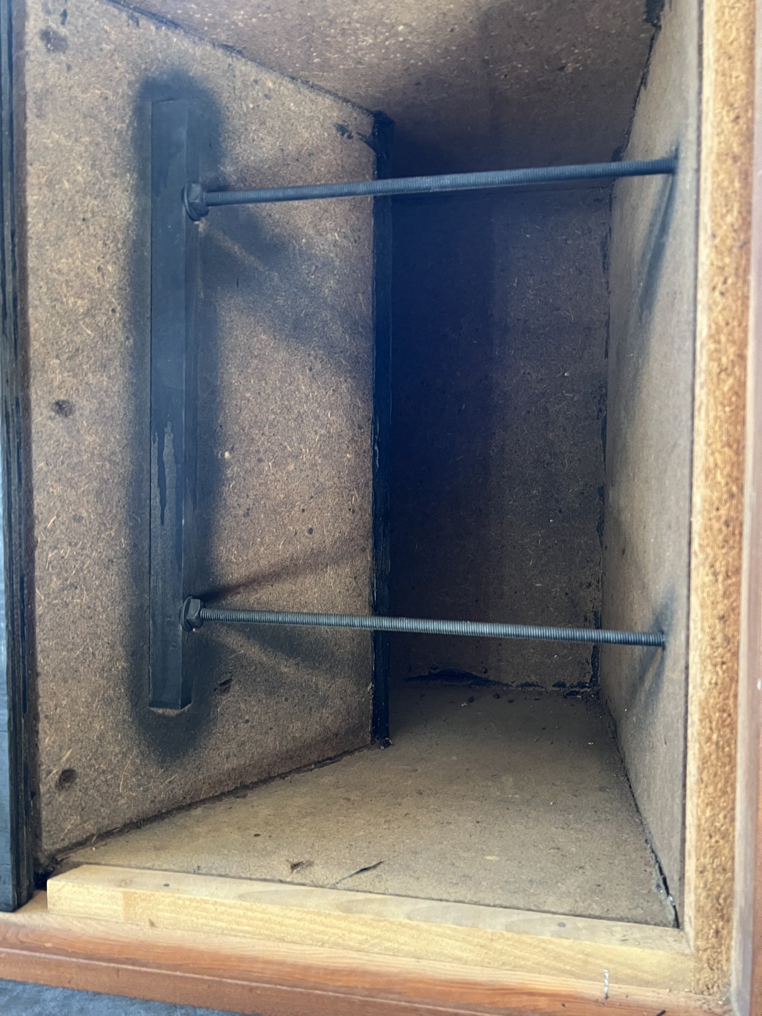

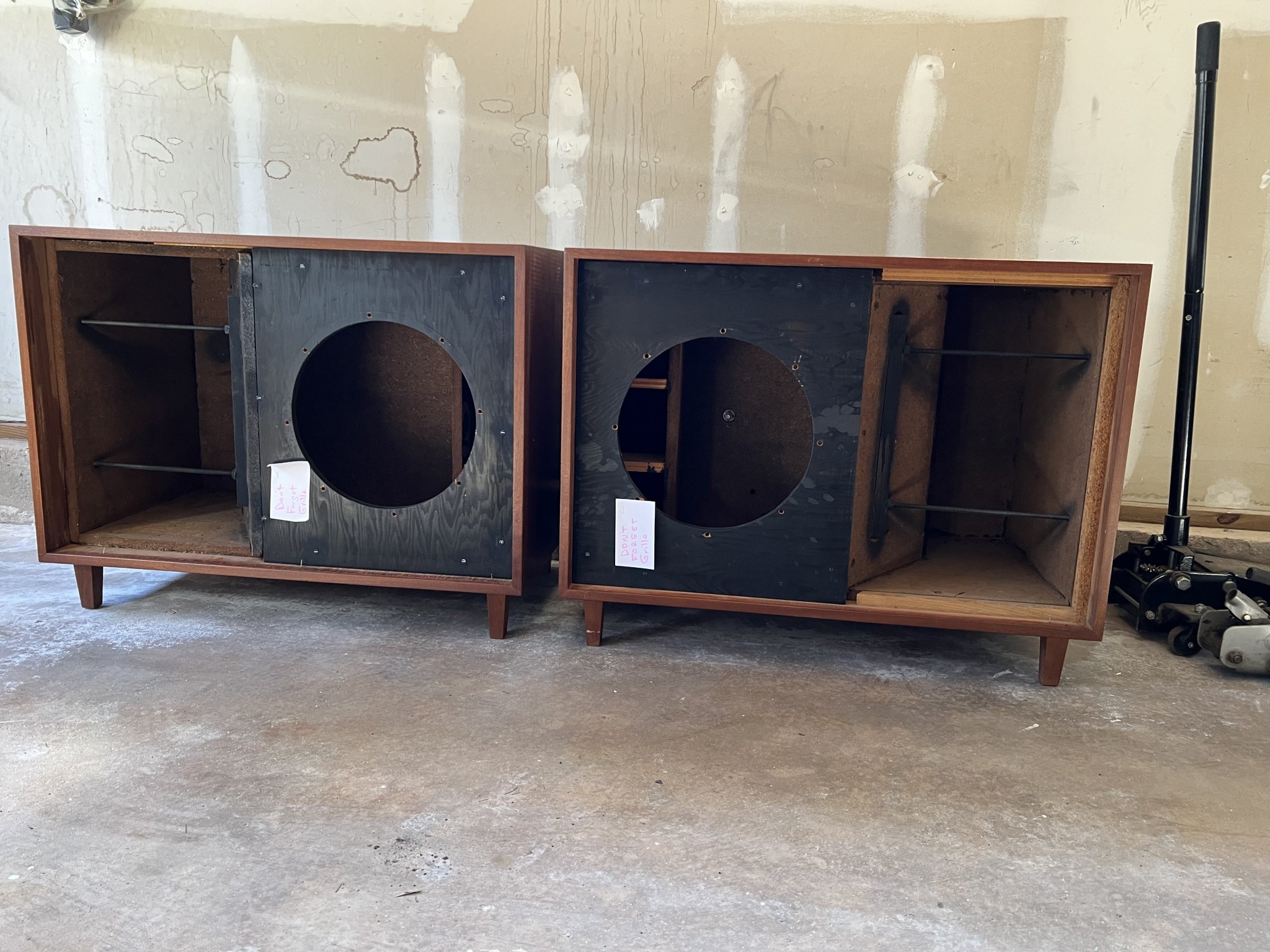

Seems like some previous owner tried adding some bracing…not sure if some might have been done by the original builders.
There are some threaded rods bracing the mouth that could have been original. They look clean and uniform.
Later on someone added some plywood braces to the throats with some black adhesive that was also used in various seams.
They also attempted some additional rod bracing of the horn segment running along the back of only one cabinet. Perhaps it didn’t pay off?…or they got lazy?
There’s some trim pieces around the inside perimeter of the mouth and a differently cut and mounted motor board on the same cabinet.
Not sure this serves any other acoustic purpose.
Maybe the motor board needed replacing and they were trying to smooth out the mouth termination or make the screens mount and sit better?
The screens are in remarkable condition…albeit a bit dated in appearance perhaps.

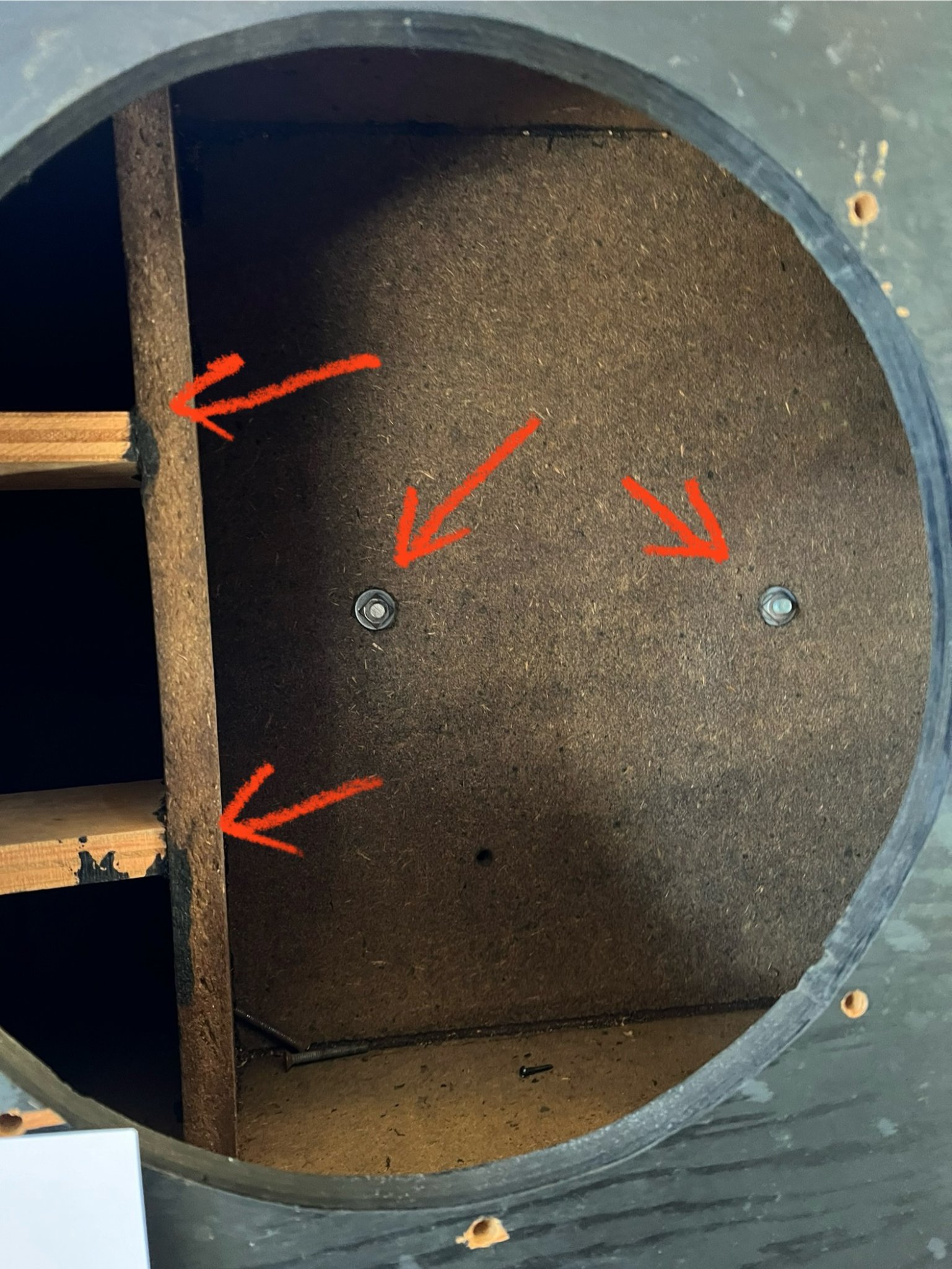

My first reaction was to the aged looking course chip board used to form the inner horn.
I can see why someone’s first reaction might be to try and dampen its resonant panels. I’m not sure they took the right approach?
I’m worried about its structural integrity (it’s possibly 75 years old) and I’m thinking that perhaps I need to find a way to coat it with something that will penetrate, reinforce and dampen.
I’m also scratching my head over the appropriateness of trying either the 3833gg or K3149 in them. Neither seem to have been originally intended for horn use?

that sort of bracing (rods) can only be of benefit, though man question is why it is done ........ as you said - did something rattled ...... ?
anyhow, good thinking - try to reinforce all joints with modern techniques ( glue, epoxy)
