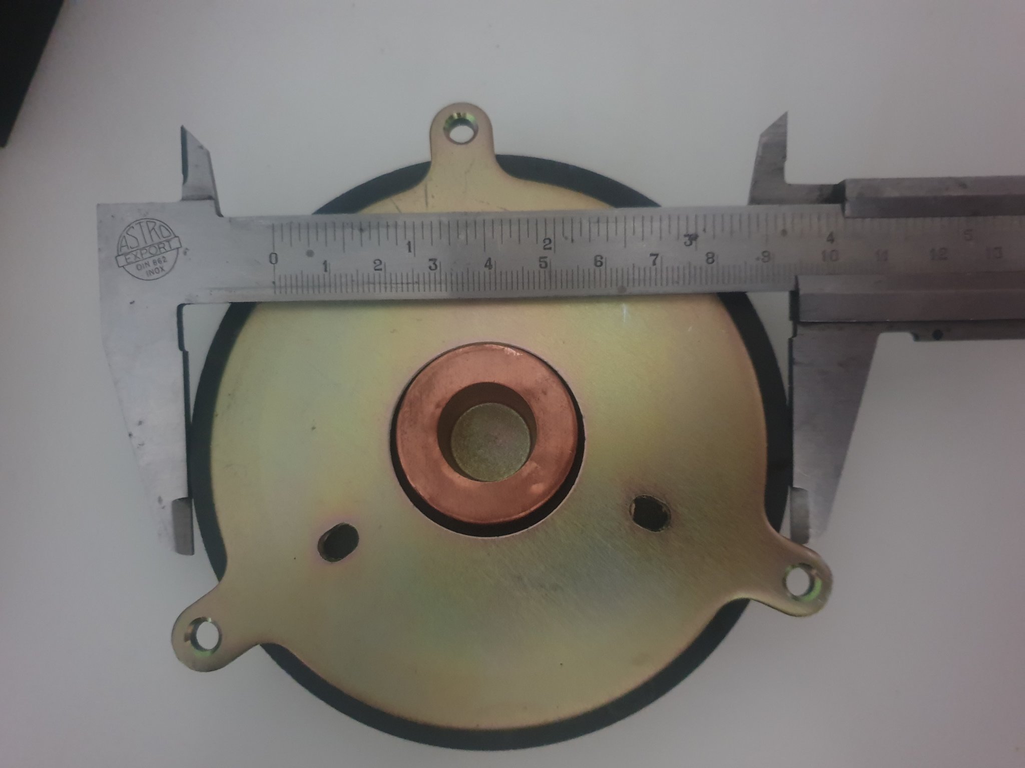

A quick, not so positive update.. the flat impedance tweeter membrane resulted to be stuck (and grrr in the end broke..) between the center pole and the plate which became unglued and was not centered any longer..Following and wondering whether there are some updates in this thread...

issue of new item with smaller magnet, solution:
repair of old magnet assy - acetone, as solvent for old glue
clean
plastic shims for centering, assemble with new glue - 2 component epoxy
buy new diaphragm, with or without magnet
mount in repaired magnet assembly

Here is following a pic of my tweeter magnet, it is 110+mm in diameter and it clearly shows the plate became unglued/loose and is not centered any longer.
The tweeter coil was trapped in the small gap and pulling it out damaged it irreversibly.
The plate can be pulled off now and I started cleaning the old glue already.
I was earlier thinking to have a metal bush lathed for centering and gluing the plate back.. but a nylon/plastic bush to have it centered is probably a smarter idea, we will see 😉

either Delrin or Al
speaker manufacturers are using exactly that in production

cartridge is same/identical, it's "just" magnet of smaller Dia
glue - take any, brand name

Ordered an aluminum pipe in the meanwhile to have it lathed.. to little a bit more than 33mm internal diameter and little less than 34,5mm externally..
