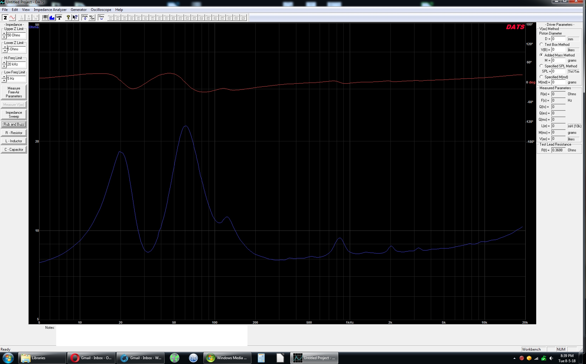

I will post the sweeps I took (imp and freq) when I can.
But even gated you'll have to allow for my room resonances etc.

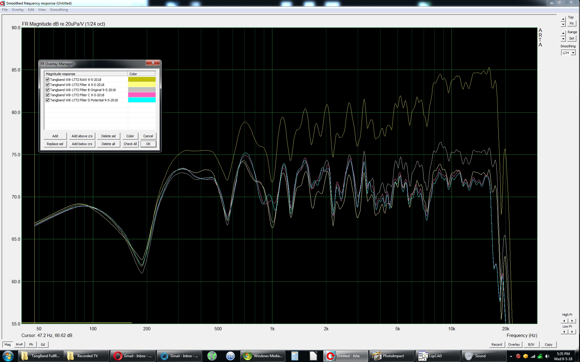

Here's the sweeps I did of the W8-1772 in Mr Brines MLTL.
The filter I've used is very close to 'Filter D Potential'.
I lowered the parallel resistor in the final version which lets a bit more detail and clarity into the sound and drops the bass power a touch.
As I say, remember these were taken in my room, 3.5mtr square, so various artefacts etc must be allowed for.
EDIT, Mic distance 1 meter, on axis. I didn't bother with any off axis at all.

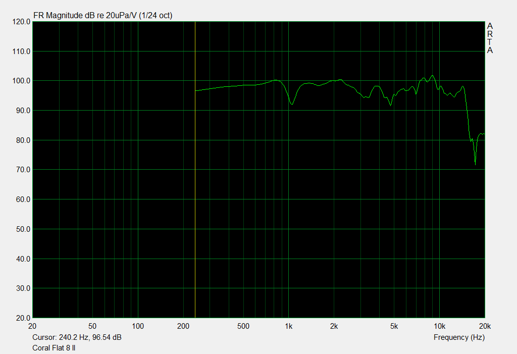

I'm trying to find a driver to replace my Coral Flat 8 II (8" full range whizzer cone) and the Tangband drivers seem to be the closest modern driver match that I can find in design and performance. (Have tried Fostex FE206 etc before - no good)
When I say replace, I mean I want to build a new project with similar drivers and my Coral drivers are now in a finished speaker design that I don't want to take apart... 😀
Your frequency response looks quite promising, although you have the vertical axis stretched a lot which tends to make the response look flatter than it really is.
For comparison here is a measurement of one of my Coral drivers, with the vertical axis stretched to the same amount to get a rough comparison. Measured at 1 metre on a 39cm wide closed box baffle with a 4ms gate time. (Measurement only valid down to about 400Hz)
The Tangband compares well, and is impressively flat at 2Khz where many 8" drivers (Fostex especially) have severe resonances. I do see the typical 8" cone breakup resonance between 3-5Khz though, so it looks like it could benefit from the same foam damping strip arrangement on the outer rear edge of the main cone that I used on the Coral drivers.
Any thoughts on why Rutcho's measurement shows a much larger peak at about 3.5Khz than yours ? I wonder if that peak is a measurement artefact caused by not flush mounting the driver on the baffle ?
Thanks for posting your measurements, however there is something severely wrong with the measurement technique used which is giving a spurious result.Here's the sweeps I did of the W8-1772 in Mr Brines MLTL.
Those large ripples on the order of 5dB between 700hz and 4Khz are some sort of measurement artefact, possibly caused by not gating the measurement correctly.
Another possibility would be your sound card mixer may be set in a way that it is recording some of the direct line out signal mixed together with the microphone input - the time delay of a couple of milliseconds between the loopback and the audio coming back from the microphone would cause these kind of periodic ripples in the measured response due to comb filtering.
So that measurement can't be trusted at all. I'd go back to basics and check your sound card configuration, microphone setup, arta configuration etc to find what is wrong.
