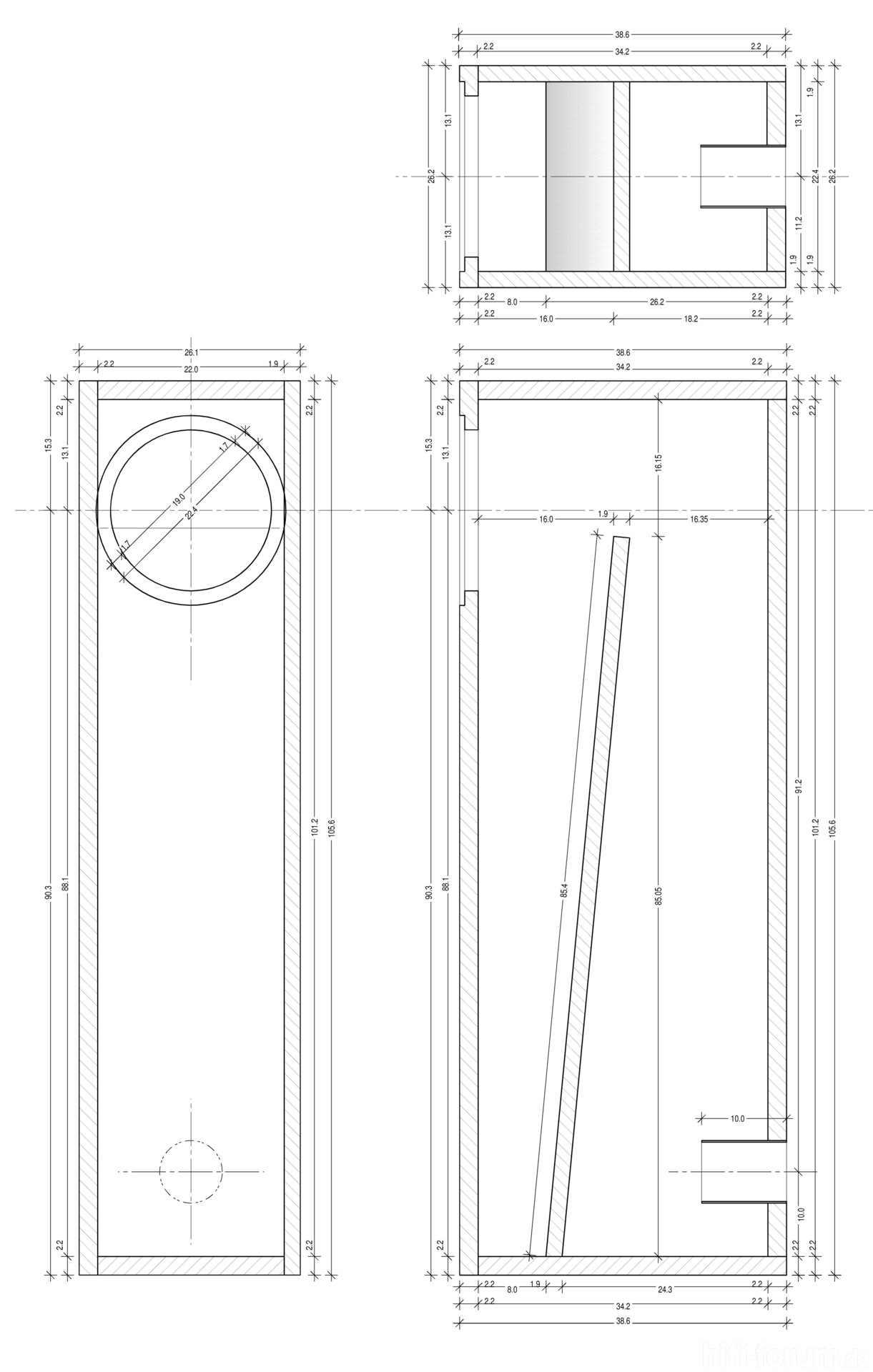

Good morning,
I have built a TQWT speaker using the famous W8 1772. It sounds for me a little brilliance and this fatiguing harshness is, I have to admit, a disappointment... of course, the speaker is brand new and need certainly some burning timel. Do you think a Zobel circuit will correct this acidity? If yes, which resistor and capacitor references are recommandante? Thank you for your advices. Musicaly, yours. TYM

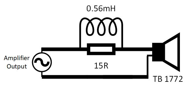

I had good success with a simple notch filter composed of a 0.56uH inductor in parallel with a 15R resistor. Place this in series with the speaker to tame the top end.
I got the idea from the Transcendent Sound webpage. Their implementation uses a variable resistor so you can dial in the amount of treble that you like best. I've posted some plots just above in post #561. Ignore the absolute dB scale on the left (I didn't adjust it properly), the point was to plot the relative differences among networks.
I've been contemplating building a TQWT for mine, right now they reside in a 40L bass-reflex box. Would you mind sharing your design?

… a TQWT speaker using the famous W8 1772...
Can you post the design. Sometimes tipped up “top” is actually not enuff gain in the bottom and TQWT can have real issues there (due to excessive ripple).

TYM, the W8 1772 has a rising response 10 db at least. I use a baffle step filter using a 4 mh coil in parallel with a 10 ohm resister, this in series with the driver. No zobel needed. this produces a balanced sound between bass and highs.

Do you have a schematic for building this BSC filter, “In parallèle, in serie” is not very clear for me... thank you

Here is the TQWT plan, I have built.

What you have looks like an ML-TQWT (better to call it an ML-Voigt/ML-V). The mass loading dramatically better suppression of ripple ein the bass.
Are there any sims to go with the box?

How's this?
Roughly speaking: The signal from your amp must pass through both the inductor and resistor at the SAME time (thus, the inductor and resistor are in parallel). The signal must pass through the inductor+resistor combination BEFORE it gets to the speaker (inductor+resistor combination is in series with the speaker).

Finally, I built your baffle step corrector recommandation ( coil 3,9 mH- 1,4 mm/ resistor 10 Ohm-10w) and I have to say after several minutes of careful listening: it works very well. I am pretty glad and thank you very much for this great advice. The result is a global better balanced spectrum and no more acidity and fatiguing effect... 🙂 I don’t have the feeling of losing details or deepness.
I have, please, another question: shall I add a Zobel network in order to achieve the optimisation?

TYM - great to hear that you are happier with your speakers now! As you can see above, there are a number of combinations of coil and resistor values that people have used to solve this problem. Each will provide a slightly different result and I suspect that each works better for different room sizes/configurations and speaker placement. You might want to experiment a little with different coil sizes or resistors sizes and see which you like best.
I don't have any real insight on adding a Zobel, perhaps others can help here. I'm of the general opinion that the fewer things between your amp and driver, the better.
TMY, I don't use a zobel no need really. You can experiment with one to see the results, that's what DIY is about. I found a zobel can roll off the highs and you don't want this with most full range drivers.
