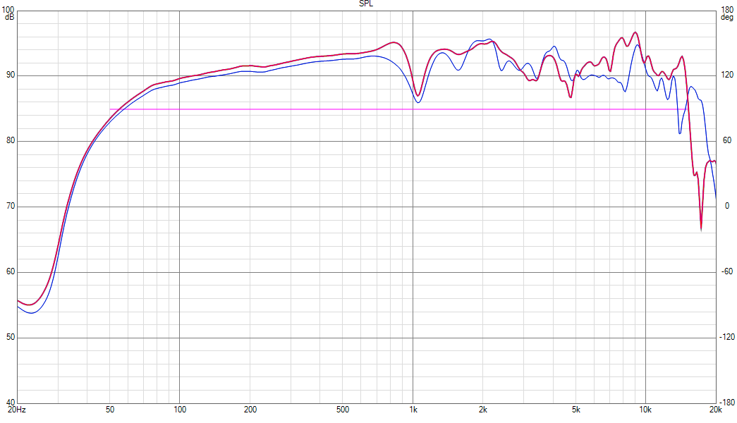

The responses are far more alike than the measurements by Rutcho... and pretty much what you already expected? So you can see a small hickup probably due to the different voice coil diameter, and a touch less treble (Le).
Find attached the responses from VCAD... 1772 first. Take the response below 300Hz with a grain of salt... kind of manipulated by myself to reflect the response in a 'normal' cabinet (i.e. baffle diffraction).
Thanks, that's really interesting. So both have peaks around 3Khz and 8Khz, and that 3Khz peak looks relatively easy to correct with a notch.
The flatness of your 1772 measurement through the 1Khz region is especially impressive and unexpected - it's almost inevitable for an 8" driver to have a dip here due to "surround dip" of a ~16cm cone so to see one without this typical dip is quite unusual.
Interesting that the 1808 does show a typical slight peak then dip around 1Khz - can you see any visible differences in the surrounds between the two models ? Material ? Damping additive ? Radius of the reverse roll ?
My two Coral drivers are hand assembled ones, and as a result they have small mechanical differences in assembly that unfortunately make quite big differences in frequency response.
In the attached image the red one is the right driver and blue the left driver measured under the same conditions on a 39cm x 62cm box. >300Hz is gated and <300Hz is a spliced nearfield measurement with 1/2 space transition simulated. (In other words how it should measure at a distance, with no network)
An interesting difference between the two is that the red one has a peak at 800Hz before the dip similar to your 1808 measurement, but the blue one does not have the peak, only a dip.
One of the differences between the two drivers is that the reverse roll fabric surrounds are different - the red one has a wide radius curve that takes up most of the gap between the surround and frame while the blue one has a smaller radius curve and then a significant flat section of fabric on either side of the roll before it meets the cone and frame. This difference in curvature seems to be responsible for the differences around 1Khz...
Differences at higher frequencies around 2-5Khz are due to the Z axis alignment of the whizzer cones being different by a couple of mm (hand assembled...) while the treble differences are due to both drivers having the aluminimum domes pushed in by my then 3 year old, but pushed in different amounts!! 🙄 (They both had quite a bit more treble above 10Khz before the domes were damaged)
In other words they're a bit worse for wear now... 😀
Anyway that 1772 measurement looks quite promising to me for what I have in mind...
Yes, they have almost identical peaks at 3Khz, as do a LOT of whizzer cone fullrange drivers. Easy to notch out.
Both curves were taken in 2011 with MLSSA, originally in an infinite baffle (measurement set up is that they have a huge cabinet in the floor of their test room and mount the drivers with custom baffles into that cabinet that extends into the room floor, microphone comes from above @1m).
Both drivers show an irregularity in the impedance curve @1 Khz that doesn't result in a dip in the FR response... it's actually more like a pimple in the curve, more so on the 1808. Maybe I did the tracing a bit to hastily... the 1808 has no extreme dip, especially not like like a few others (Fast 8, Fostex). When you mount them into a cabinet with a certain baffle width you can 'tailor' the baffle step to match the response. That is what I tried with my 'manipulating'. But I would cross them (1772 would be my choice) @250Hz-ish anyway to retain the sensitivity in the midrange and up.
According to the magazine the 1772 has a coated cloth surround while the 1808 sports one made from rubber. Aaah!
Interesting that Coral did so well so long ago and that there is no driver on the market that betters them considerable. And I don't trust the boutique drivers. 😉
Certainly easier to notch out that peak at 3Khz in a passive network than trying to boost a dip in the response..Yes, they have almost identical peaks at 3Khz, as do a LOT of whizzer cone fullrange drivers. Easy to notch out.
Sounds like a lot of care was taken in those measurements.Both curves were taken in 2011 with MLSSA, originally in an infinite baffle (measurement set up is that they have a huge cabinet in the floor of their test room and mount the drivers with custom baffles into that cabinet that extends into the room floor, microphone comes from above @1m).
Interesting that the impedance bump is there on both drivers but only one manifests a frequency response dip...Both drivers show an irregularity in the impedance curve @1 Khz that doesn't result in a dip in the FR response... it's actually more like a pimple in the curve, more so on the 1808. Maybe I did the tracing a bit to hastily... the 1808 has no extreme dip, especially not like like a few others (Fast 8, Fostex).

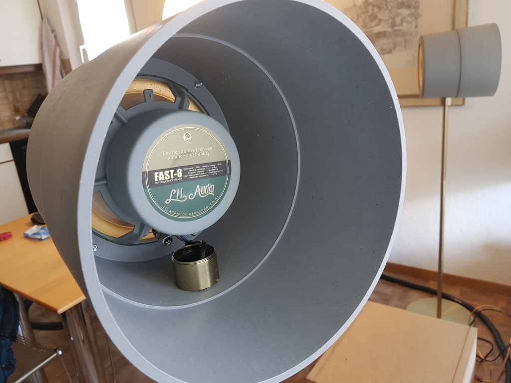

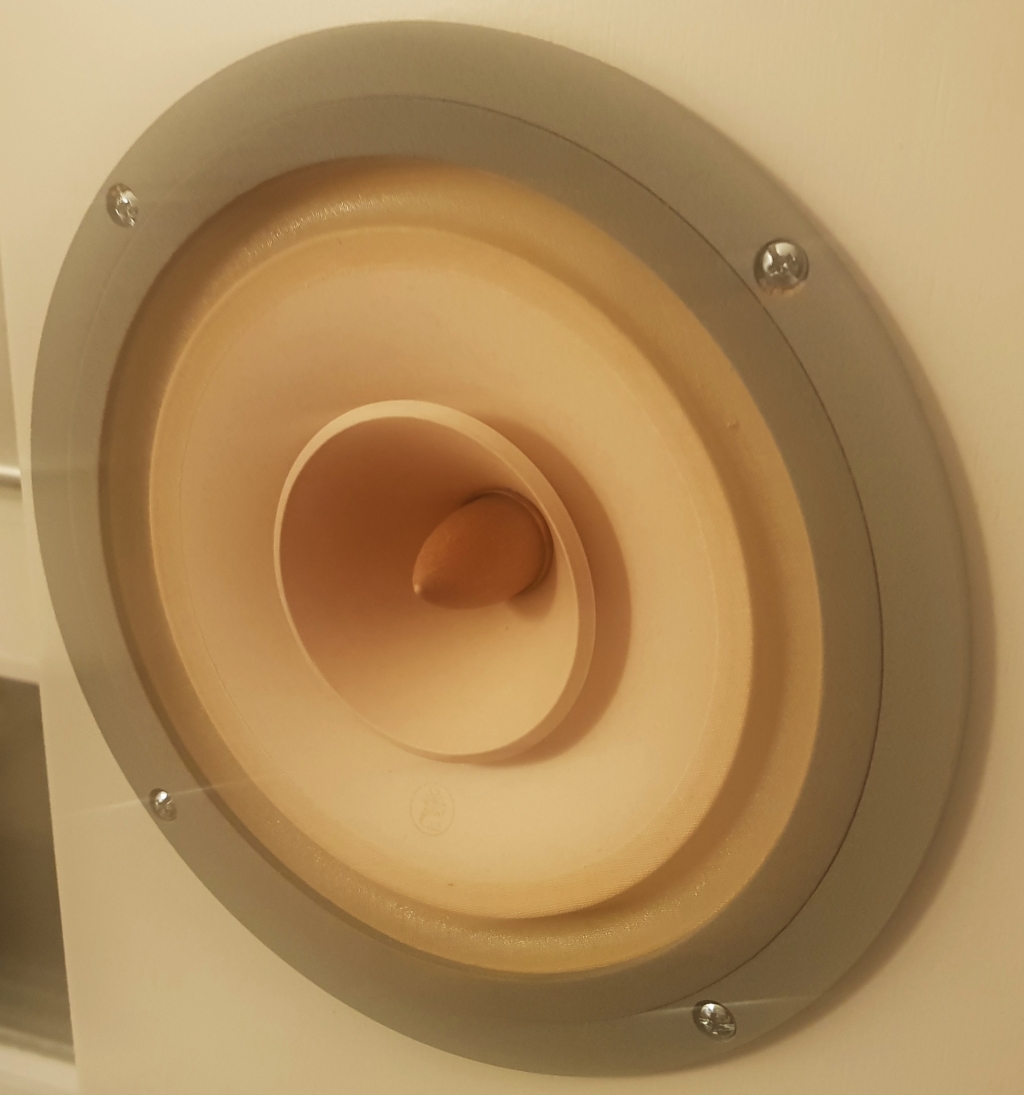

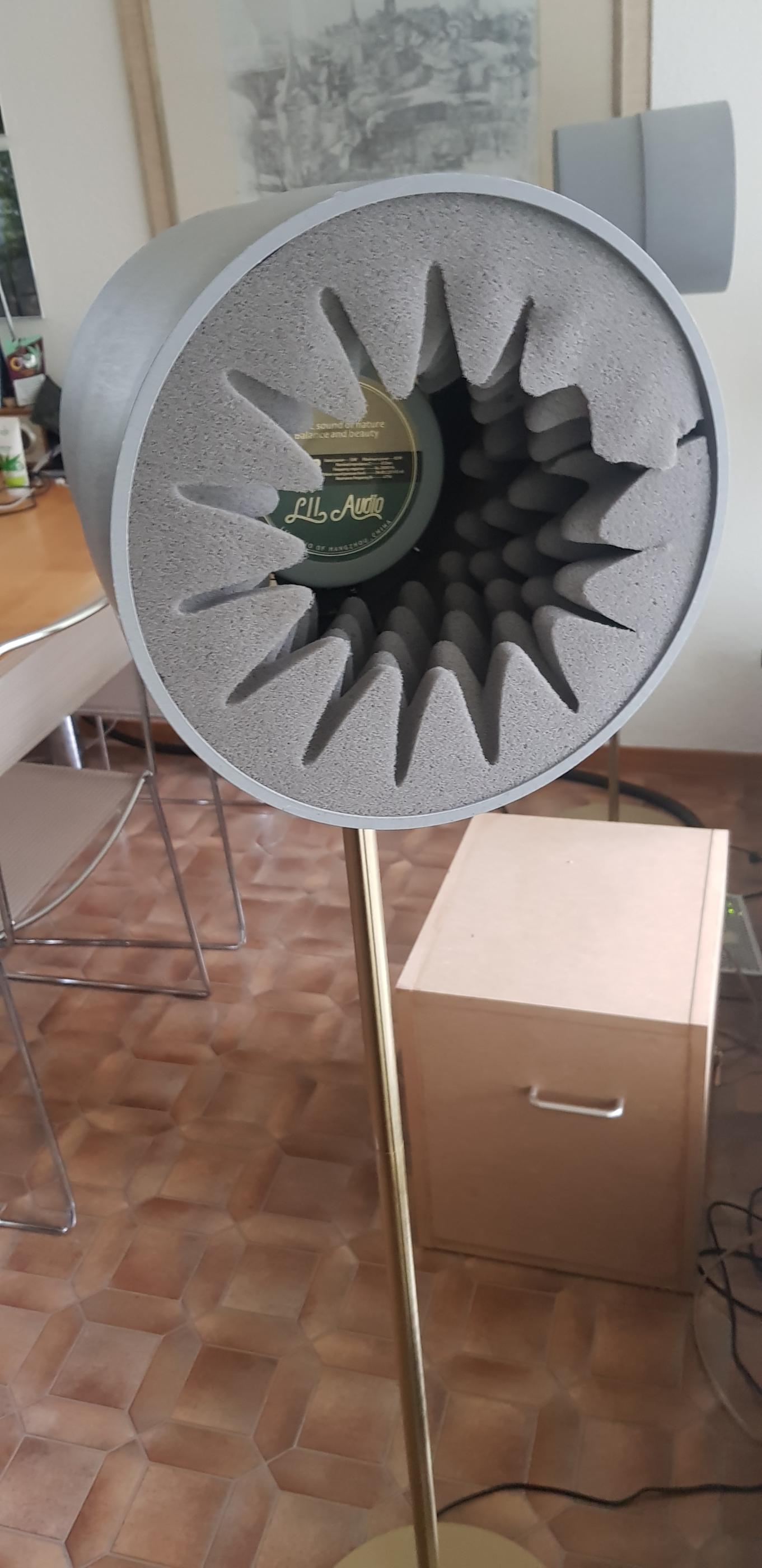

I am using in my kitchen some Lii Audio Fast 8 in some kind of open baffles: IKEA Nypon pots, mounted on a lamp stand.
It's an 2.1 system, a FAST. Driven over a MiniDSP and an F5 amplifier, the subwoofer driven by a T-amp.
Lets try to upload some pictures
20200112 Lii Audio Fast 8 in Nypon Baffle Gesamtansicht.jpg445.7 KB · Views: 349

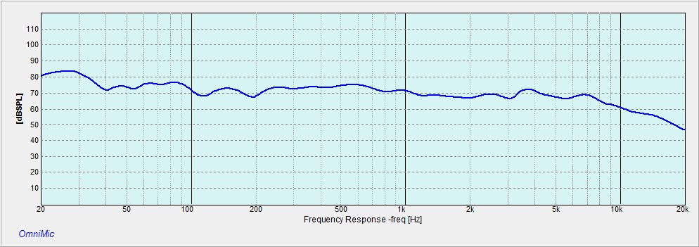

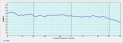

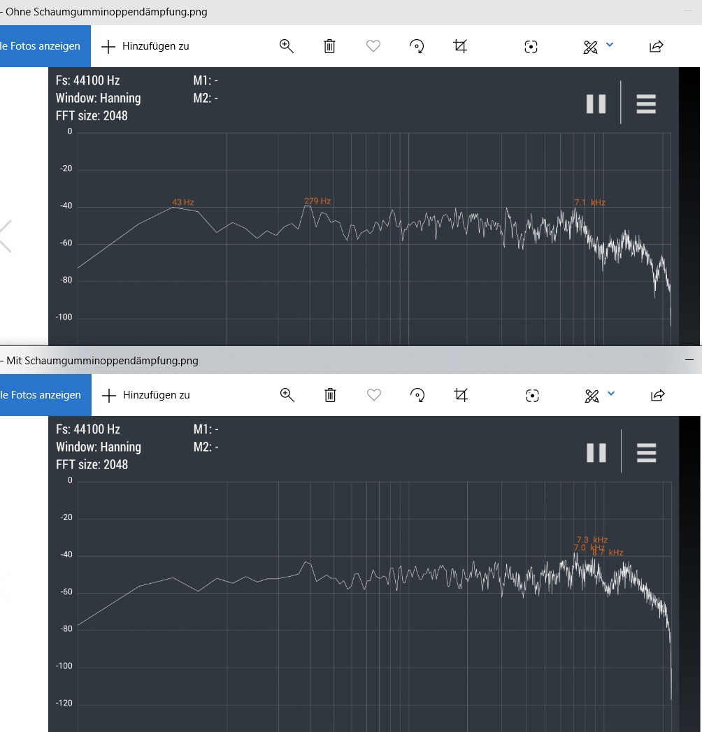

Here my simple measurements with my mobile phone. Before (upper half) and after installing the foam on the backside (lower half of the picture).

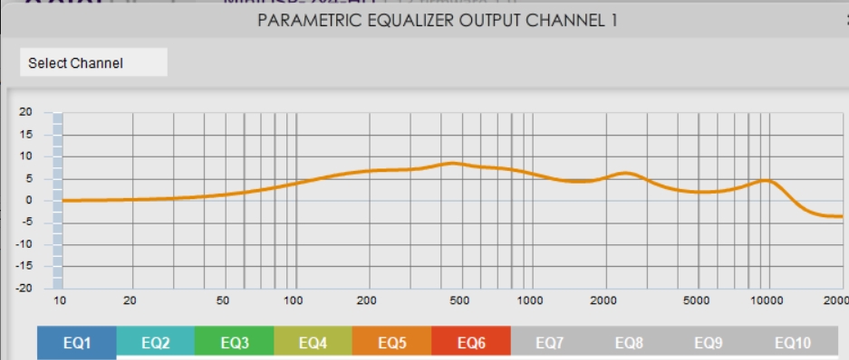

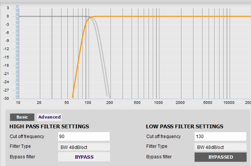

I show also the eq settings I was using during this "measurement"

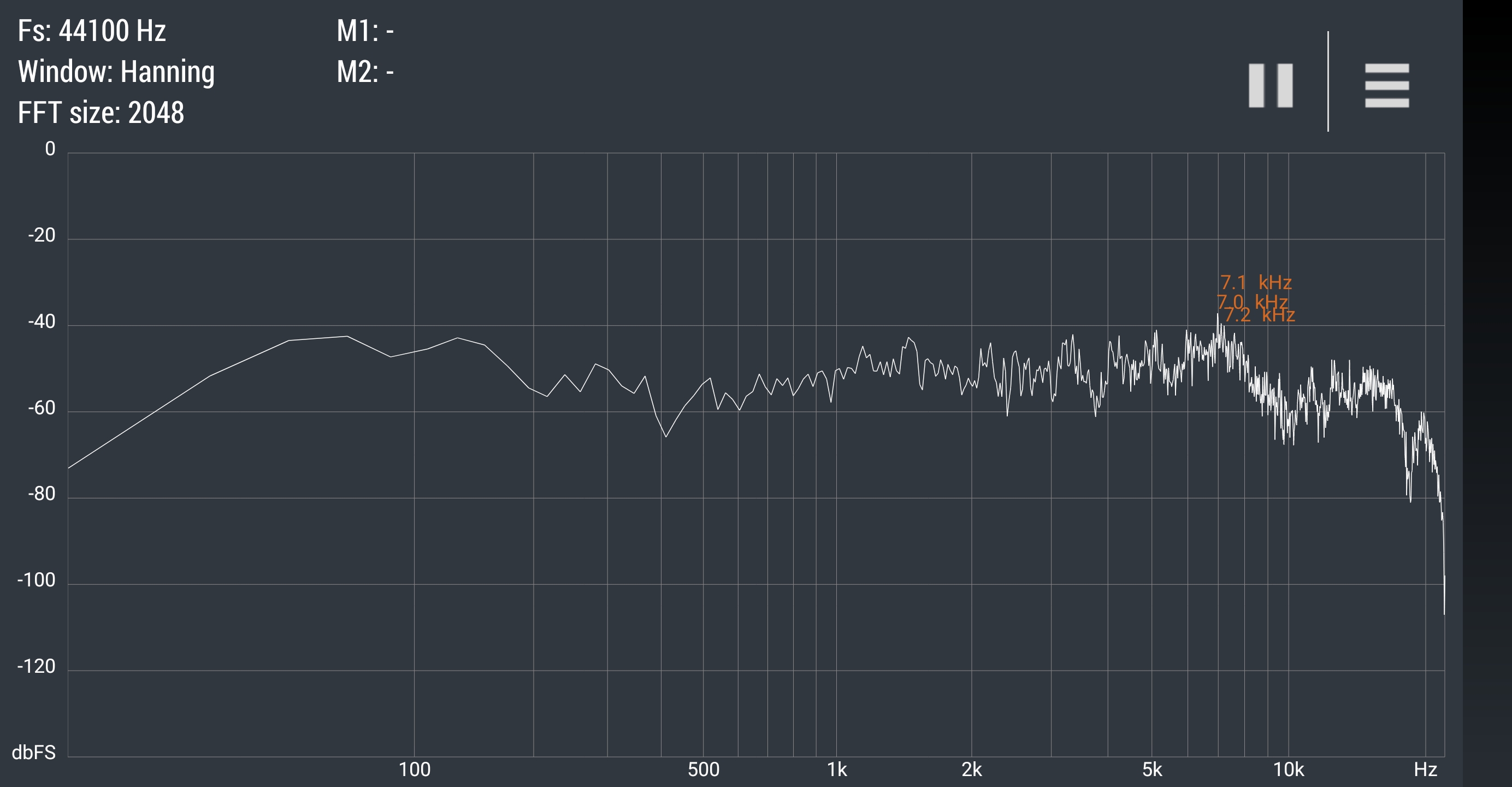

I just made a measurement with the DSP EQ set to "flat" (including the foam in the backside of the pot)
Below 90 Hz you see the subwoofer and not the Lii Audio Fast 8
As for dips in the frequency response I am more concerned about peaks than dips... yes it is difficult to 'fill' a dip,especially with a passive crossover, but a gentle dip at around 1Khz wouldn't bother me that much as a peak at 3Khz where my hearing is the most sensitive.

I don't quite understand your EQ settings that you are showing... usually you have to tame some peaks in the midrange and the treble. How did you arrive at the response of your Fast 8's?
Franz,
Now it's me not understandig your question.
The eq settings I am using are leading to the response I measured. Thats it!
/Edit
Overall, I don't tame peaks, but I correct broader tendencies with low Q settings of the filters.

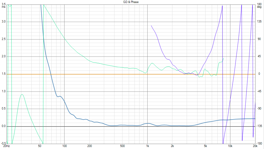

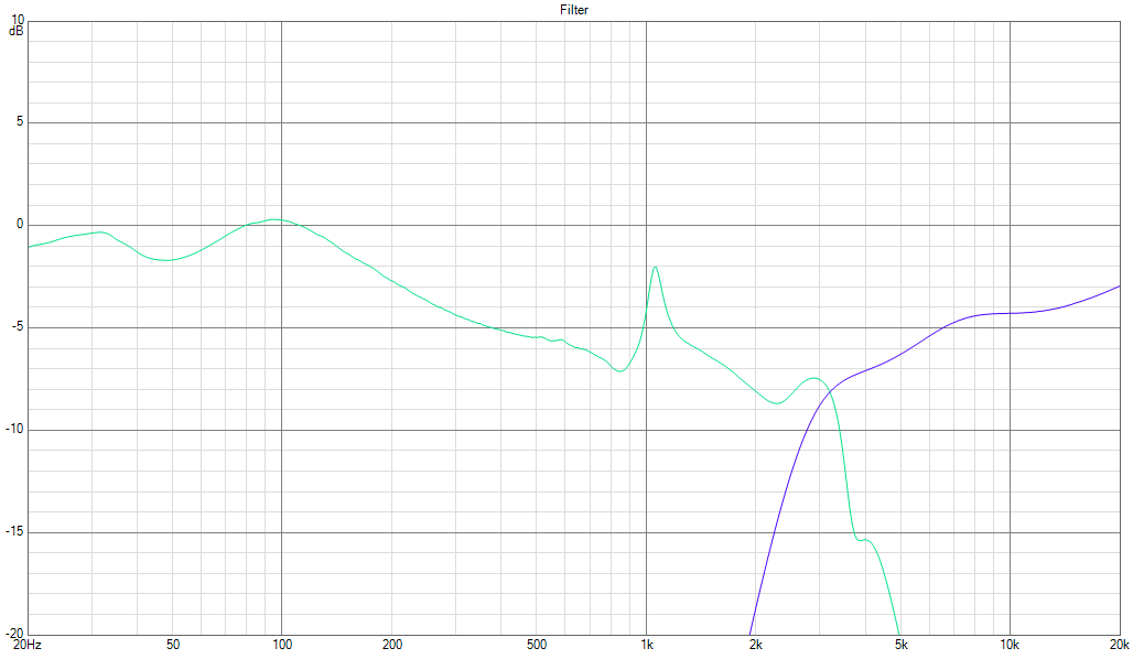

For many years I had them crossed at 4Khz, but as you can see from the raw measurement they have a significant dip at 3Khz, and coincidentally the ribbon tweeter has a small dip at 3Khz as well, so I wasn't able to remove the 3Khz dip with a passive crossover at 4Khz.
So I decided a little reluctantly to reduce the crossover point to 3Khz, which allowed me to retune the shape of the high and low pass sections to correct the dips in both drivers responses.
My hope is that with the 1772's response I will be able to move the crossover point back up to 4Khz as 3Khz is pushing the ribbon tweeter a little bit at high SPL. While they do work quite well down to 3Khz, the Aurum Cantus G2 are most happy with a 4Khz crossover point.
The crossover is pretty complicated and to be honest it was an exercise in "how far can you go" to correct the response of a driver passively. So in the end it has baffle step correction of about 6dB, a notch at 845Hz, a peak at 1.1Khz, a notch at 2.2Khz, and another one at 3.8Khz. The 3Khz 4th order low pass filter has then been "bent" considerably to bring the accoustic reponse almost exactly to a 4th order Linkwitz Reily.
You can see the contortions in the filter response in the image below. 😀 Trust me, even I'm genuinely surprised that the end result is so flat! One advantage of higher order filters is they give you a lot of degrees of freedom to "bend" the response to compensate for driver response errors without adding any additional components to the existing low/high pass section.

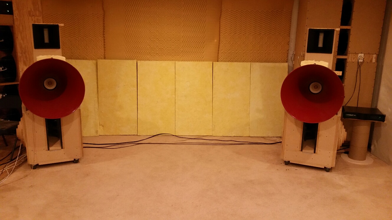

Would the distance between the full range and the tweeter be enormous with front horn?
Oh yes ! It is. But, what I have discovered is, due to the relatively high crossover point, the tweeter does not draw attention to itself.
Everything sounds like it coming from the horn.

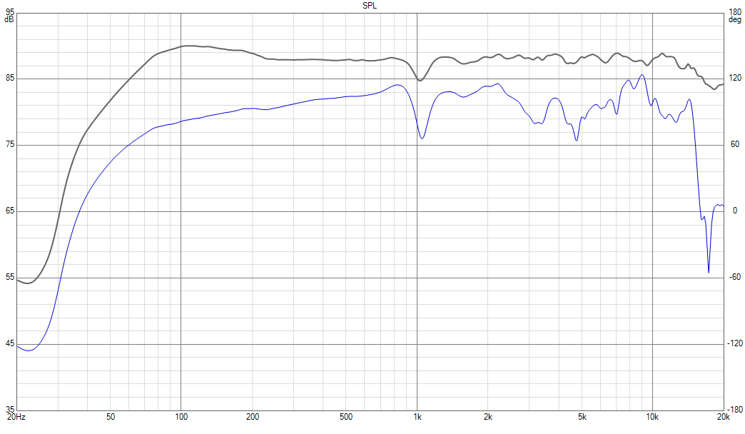

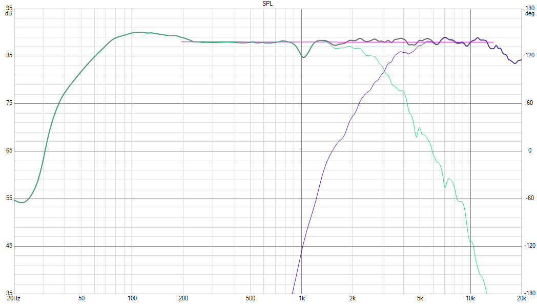

By the way, the 1772's that I have do not display the peak at 3K.
There's a bit of a dip at 1.0 and 1.6K, but otherwise impressively flat.
And, to repeat from an earlier post, the otherwise "lean" lower mid range gets an up lift due to the horn load.
The graph was taken back when i suspected I did not have the tweeters tilted down enough. Sure enough, it shows. I angled them back downwards about another 3/4 of an inch, form the already slanted mounting plane.
