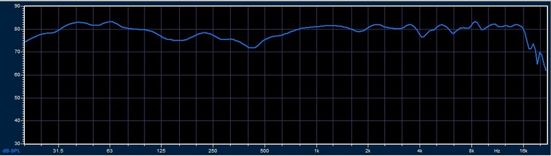

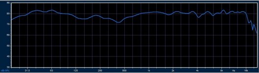

Not really into the maths.....just use my ears.
I tweaked the crossover to my liking, and today took a measurement of one side from 1m away.
I was expecting to see a hump at 1k.....but as you can see, pretty flat.
The dip in at around 500hz is the crossover. I can get this flat, but then vocals sound too chesty.
My intention of this post was not to cause controversy, but to give information on my experiences with this driver in this context.
As you say....to each his own, and there is more than one way to skin a cat........but if anyone is interested in my findings please get in touch.
Yes Chris....I happily lived with the PRVs for a few years. I got bored during this lockdown so decided to experiment. I still think the PRV is a great driver, and many may find the TB is a sideways step....but the treble to me is certainly a revelation.

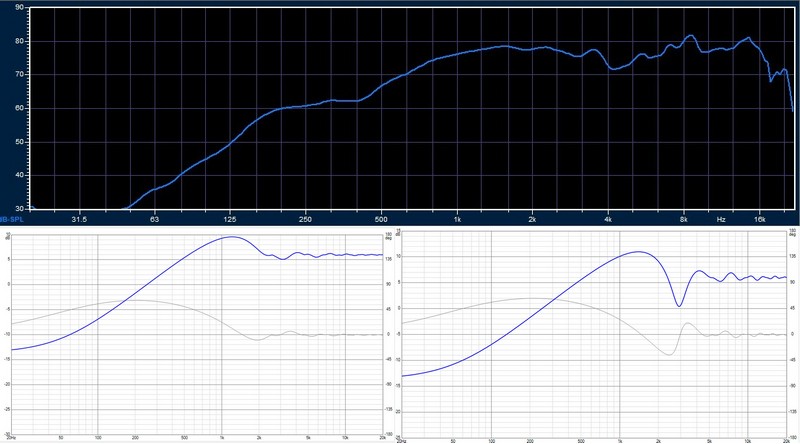

Oh dear, that makes things even worse, adding a big dip around 3Khz and a response that is more bumpy above 3Khz.
Mandrake
This is what I'm getting from my no baffle 1772, one driver. 1m away....no eq.
Is this close to what your simulation shows?
Also, my comment on the multi-way forum was not relation to your diffraction theory, but the way they also pounced on my postings there.
The thing with those simulations is that they assume the driver is completely flat.
Which is never the case. So, if the driver has a dip at 1kHz, the baffle step will take care of that and just bring it flatter.
So, just quoting simulations means nothing without having seen the drivers frequency response to combine it with the simulation.
