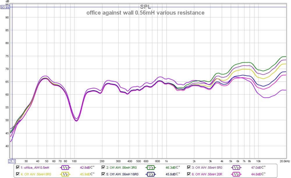

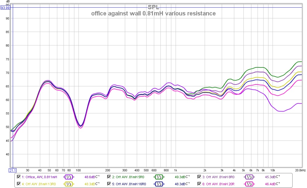

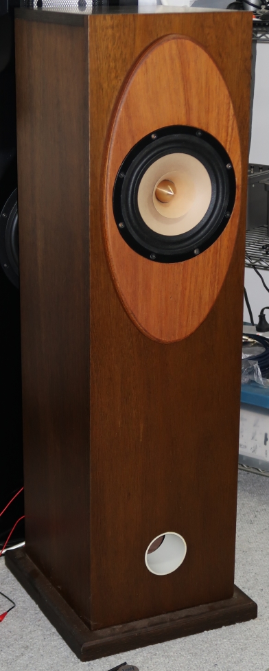

Here are some plots of my 1772 driver mounted in a 40L bass reflex box. Ignore the absolute numbers on the dB scale on the left, I did not adjust to accurately represent the sensitivity of the driver. The graphs do, however, show relative response according to frequency.
The first graph is just the driver in the box, no correction network, with 1/3 octave smoothing. The second graph shows the effect of a parallel 0.56mH + various resistances added in series with the driver (ignore the lowest purple plot on the right - no inductor was used here).
The third plot shows the same, but with a 0.81mH inductor and various resistances. The larger inductor tips the treble down a bit more than the smaller inductor for the same resistances.
I've settled on using a 0.56mH in parallel with 16R, placed in series with the driver. It's not perfect, but just two components tame the treble and make it a much nicer speaker.

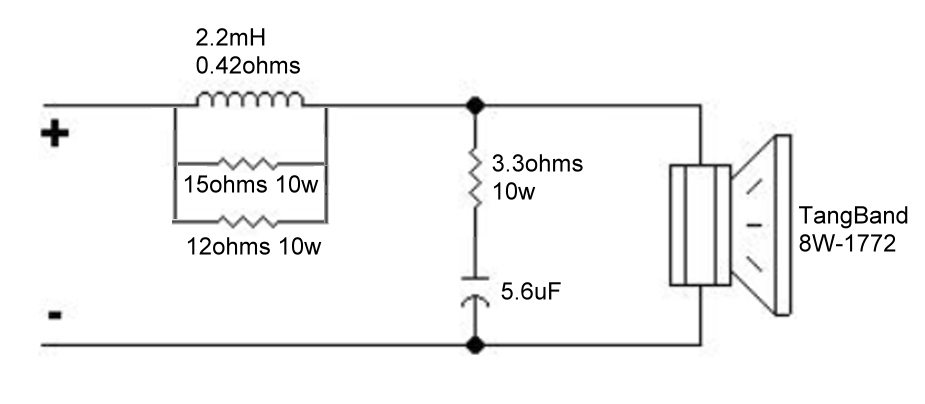

Update.

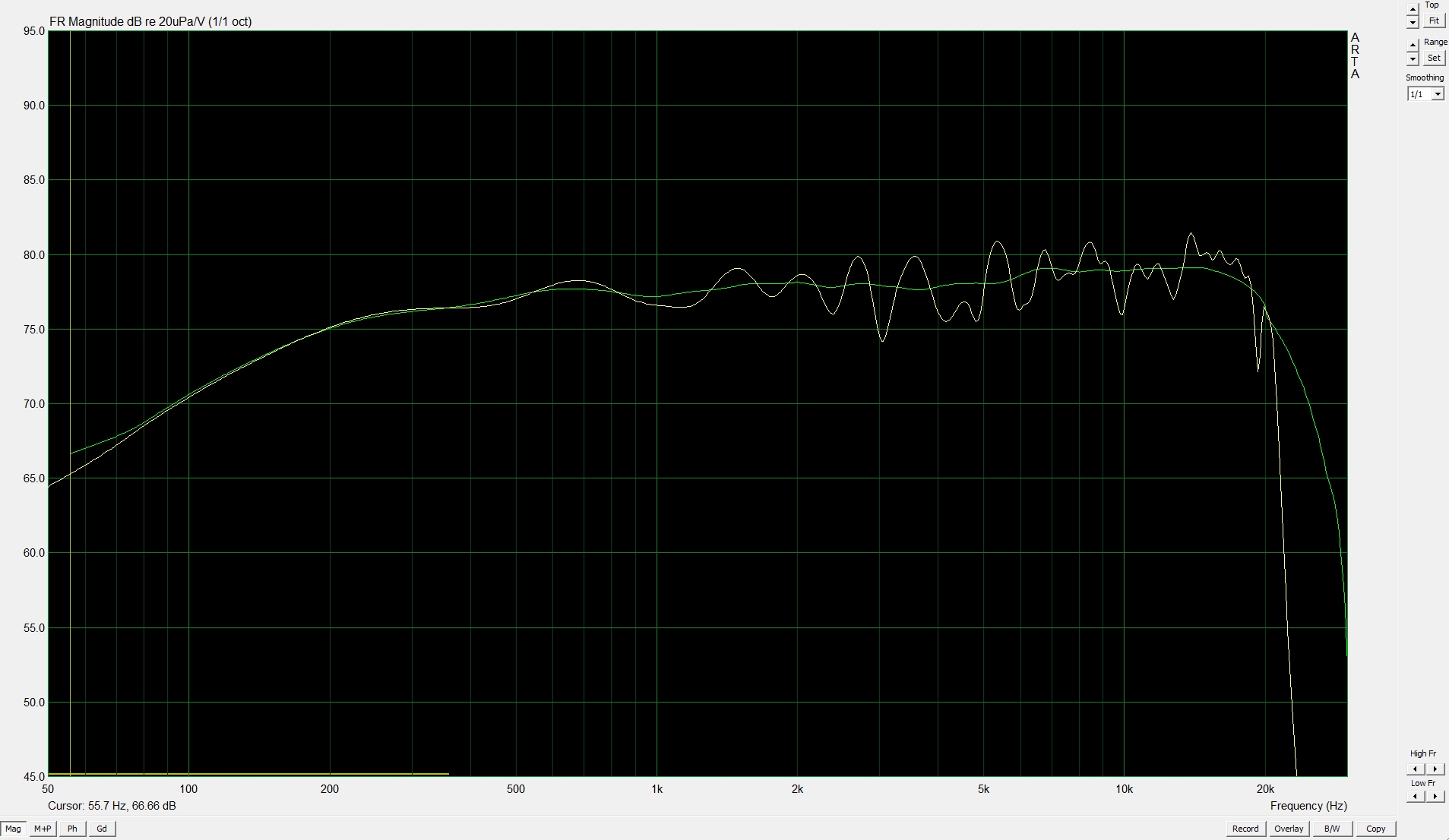

To those that noticed the sawtooth graphs I posted previously and suggested I was having measurement issues.
As you can see by today's sweep, a simple pc restart is all that was needed.
And that is literally all I did.
Gotta love technology :D
The graph is 1/24 and 1/1 smoothing at 2.771ms gating.
Despite the 1db increase at the top end, their sounding pretty dam good.

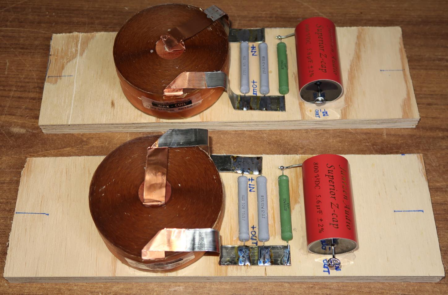

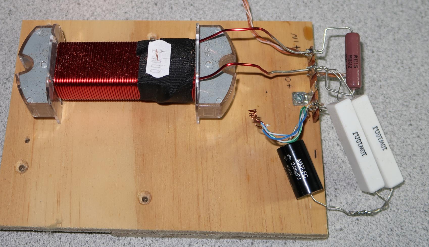

Pics are of the original filter (Iron core and solen cap) and the replacement I built (Jantzen Wax coil and Superior Cap).
Thank you.
I can't say what signature the steel core imparts as I didn't do a like for like test.
I can say the change in values made a substantial improvement.
And switching to the better parts made a very worthwhile improvement again.
Yes I know coils and caps are a heated debate for some.
But for me, there is no argument as to their effectiveness.
Overall there is still something not quite right.
But I wonder if it's something inherent with the driver, or the need for further tuning.
The area that to me isn't as I would like it is the midrange.
Since the filter primarily effects the bass and treble regions, that's why I wonder about the driver.
I know there are those out there with far more expertise than I will ever have.
So this is just my crude attempt at helping a friend :)
nice - did the steel core inductor impart a "hard" coloration to the tone ?
If you have to use a core for a baffle step coil, laminated silicon steel is a good choice.
In my 2 way Coral/Aurum Cantus crossover I initially used large good quality bobbin style Permite cores for the 4mH baffle step correction coils.
They sounded "OK" most of the time but on particular songs with heavy bass I could hear saturation effects of the core where the peaks of the bass waveform caused midrange "breakthrough". (When the core saturates on the bass waveform peaks, the inductance drops dramatically boosting the midrange momentarily)
This was quite surprising when the speakers themselves are only rated at about 15 watts in total, and can reach their excursion limits at bass frequencies at under 10 watts. So it's not as if I was driving them with hundreds of watts. The core was rated at much higher power levels than what I was driving them with.
I changed to a laminated steel core in an I form factor and the problems with saturation completely went away.
In fact I've used these exact same laminated steel I core coils as the low pass coil on a 12" 100 watt woofer before and they don't saturate even at those power levels.
For low frequencies up to about 500-1000Hz laminated steel is better, at higher frequencies like tweeter crossover frequencies permite is better. (Although I usually use air wound coils for high frequencies such as a tweeter crossover, as cored inductors aren't needed)
In the application of a baffle step coil, coil current is only high at bass frequencies, that is where the risk of saturation and distortion is. At midrange frequency the shunt resistor dominates so there is no significant effect on distortion in the midrange, and any tiny amount that might be added will be considerably less than that produced by the driver itself and in my experience below the threshold of audibility.
